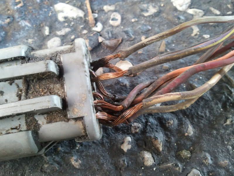

To unlock the converter while driving, turn on your hazard lights, with the truck up to speed and converter locked. This will unlock the converter. You can also keep your right foot on the gas, and then with your left foot, gently ride the brake, just enough to turn on the brake lights. So long as you keep on the gas at the same time, you'll feel the converter unlock.
If it feels just like what's happening at times, the first place to suspect the issue is a failing/dirty solenoid pack plug. You should be getting the converter slip code, if it's happened a half dozen or so times.
If you need to look further, though written for the IDI diesel section, the basics apply:
E40D: The Importance Of A Clean Trans Harness.
