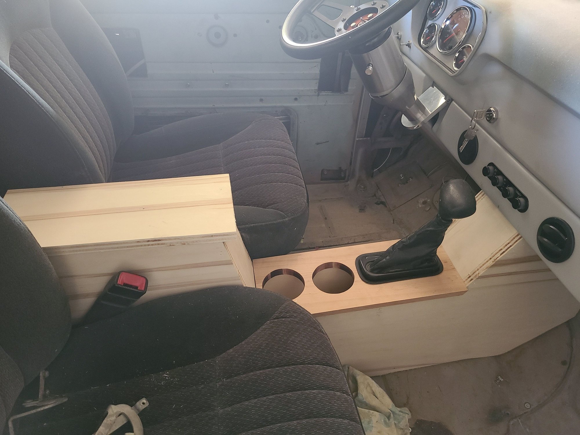

I am pretty sure restromod air unit has fittings that come out the side and was a bit smaller than vintage air.
Originally Posted by Marten
You could do it I guess. Not sure how mixing and matching different brands will work for you. I wanted to do what you are thinking about but using Vintage Air complete. I talked to a sales rep about it. They don't recommend doing it that was as there are more fittings involved so more prone to leaking. I went with the sure fit kit and bought a different controller, dash vents and chrome compressor. System works great. Just live with seeing all the hoses for AC and heater.
I would love to see pics of your vents and controls if you have one. Always trying to get ideas. How do you like your kit? truck stay cool?

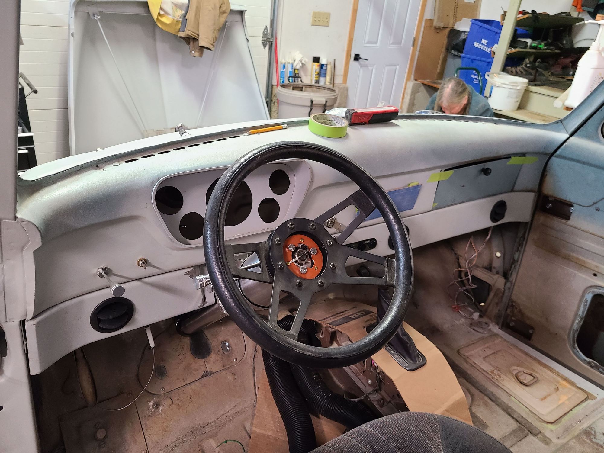

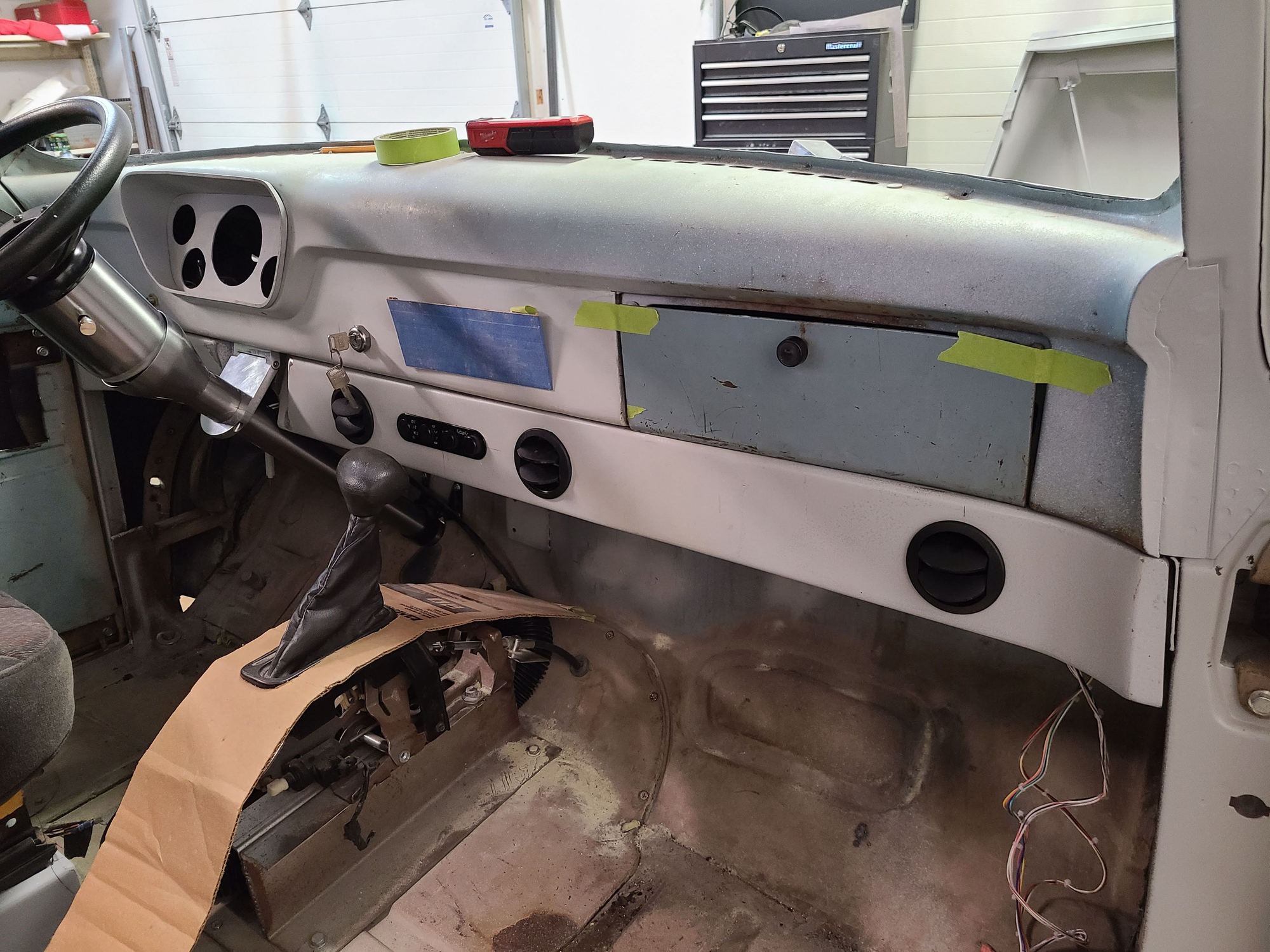

The system works amazing. My problem is that the door seals, well don't seal. I will get new ones once I paint the truck. When sitting at a light the truck can get cold. Once driving the air coming in over rides the AC. Most of the time I don't use it anyway. Maybe a couple of times a year just to exercise the system.
If you want pictures from another angle, I would have to get them. This is what I have found.
Old Jun 25, 2025 | 09:53 AM

If you dont mind me asking, where did you get that dash extension piece? I ordered a fiberglass one from Fat Fender Garage as it was the only thing i could really find. However yours appears to be metal and much nicer.

I had bought a fiberglass one from Mid Fifty but it sucked big time. Sent pictures and many calls later they gave me back my money and I tossed it.
That one I built out of metal, ,either 14 or 16 ga. Picked a size I wanted and bent it into a U on a large brake. Made it in 2 pieces as the metal was only 4 feet wide. The fiberglass unit had a cutout for the steering and a recess for the glove box. Did not really like that recess so I made it the way you see it now. But now I need to figure out how to mount the glove box door to work. Really happy with the way it is looking though.

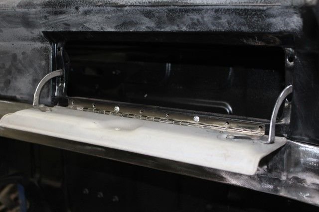

You could do what I did Marten..
welding a piece of 1/8 X3/8" flat bar to the bottom inside of the
door and then a piano hinge to it flush to the bottom..
Will be using pop rivets to mount it to the dash. The original hinges can't be used any longer so with the template I kept from my last build
I cut out new stays to support the door at the level position..
Did this first on my pickup and some explanation on post# 15 https://www.ford-trucks.com/forums/1...l#post15201350

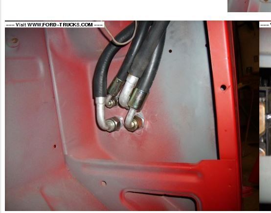

Hi hxckidd,

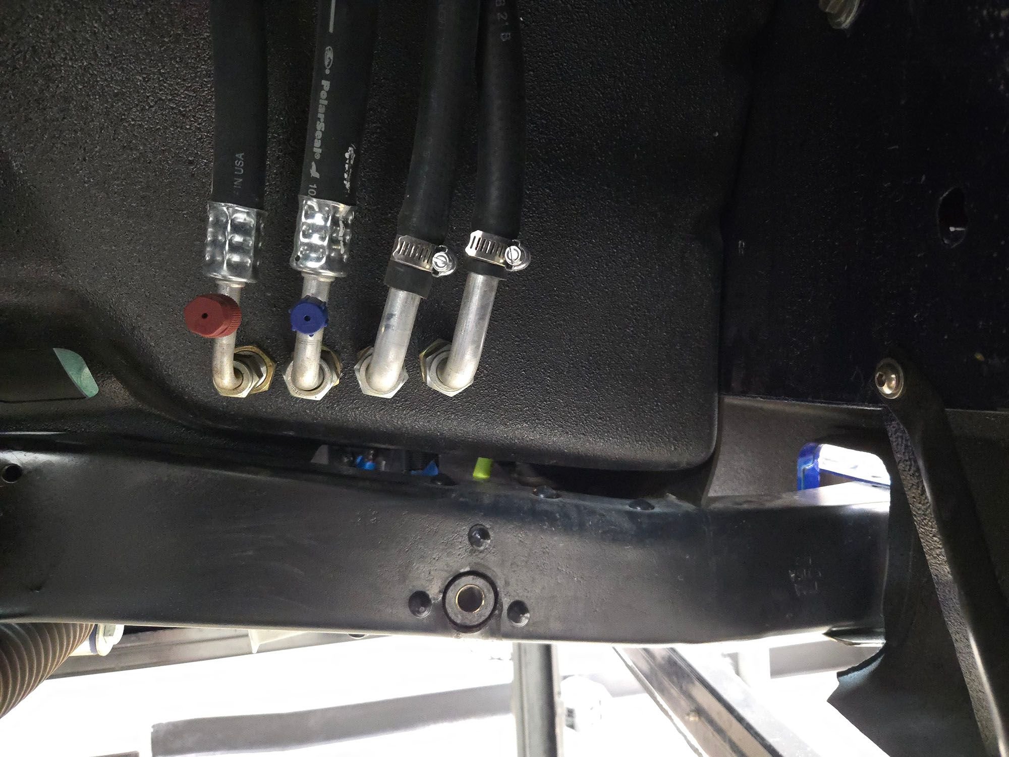

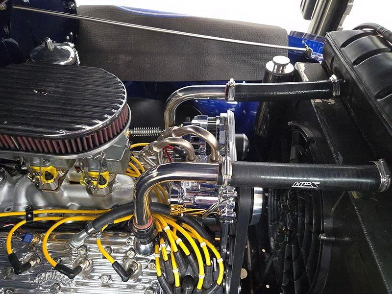

I ran my ac lines inside the inner fender. The extra work was worth it for me to achieve the clean look. VintageAir components were used, plus bulkhead connectors from others, mostly sourced on Summit Racing. The remote condenser is mounted under the bed. Sourced from Southern Air/Hot Rods.
Inner fender bulkhead connector.
Lines going through cowl leading to VintageAir unit. Horizontal lines going to the right go to the remote condenser mounted under the bed.
Lines to Vintage Air unit.
The 180° adapters.  Lines go under the compressor and beside the distributor.
The 135° adapters. Lines go under the compressor and beside the distributor.
