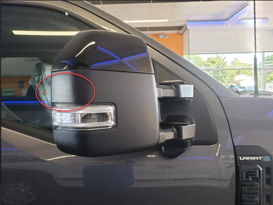

I also had this issue with only the passenger side. I went to get in my truck one day an noticed the mirror wasn't folded like the drivers side. Got in and hit the button and the mirror would move in a little bit like it was trying to move but really didn't. Also wouldn't extend fully out and would fold on its own driving down the road. I was forced to zip tie it open to safely tow a camper.
Made an appointment with dealer Service department they looked at it and warranty denied the claim of replacement. This is a brand new 2025 F250 Lariat with all the bells and whistles. $84,000 truck with 5,500 miles on it. Warranty deined the claim because they see scratches on the outside of the mirror claiming it was hit. Which I call BS on because if it was hit there would be damage to the turn indicator lense and there is none. In fact I didn't even know they were there. Denied Warranty claim so the dealer offered ford assistance program which basically means ford and dealer will cover 60% of total infalted cost of the mirror assembly which is $2400 which leaves me roughly $1000 out of pocket to pay. If a scratch like this break Ford's mirror autofold motor than I fear product quality has gone down the toilet. Got friends and family assistant involved and they claim nothing more can be done.
This will be the last Ford we ever own .
AROD did a video on rebuilding the mirrors with an upgraded innards.
If I recall, the "upgrade" was $400ish plus install/labor.
The video did show most of the disassembly process if you want to attempt your own repair.
so, occasionally the motor gets out of sync. It's happened to me a couple times on the passenger side. When that happens you have to manually open or close it and then cycle the open close with the button. The last time I had to manually fold it fully forward and then back to normal.
Those "scratches" remind me of what you'd get if the mirror brushed by some bushes at a campsite (not saying that is what happened, just saying the "scratches" remind me of that). If Ford says the power mirrors cannot withstand even light contact with something like leaves and twigs, then the manual mirrors start to make much more sense to me. I have been going back and forth with power vs manual for a future truck purchase, and your post is eye-opening to say the least.

I’d see if a detailer can clean up the mirror and try again.
Yep... My cous is a Ford tech and has said that there's more red tape to get Ford to cover side mirrors repairs than any other part.
Good for you to vote with your wallet on your next purchase.
