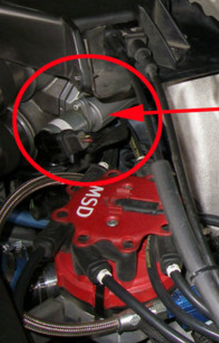

Here's a video that will give you a general idea of what the vacuum lines do, but it's not identical to your engine. The vacuum lines that aren't covered in the video are one from the vacuum tree to the MAP sensor, one to the power brake booster, and one from the PCV valve, on the passenger's side valve cover, to the upper intake.
Is the new throttle body similar to the old one?
Did you transfer the Idle Air Control Valve to the new throttle body?
Here's a picture of the Idle Air Control Valve, bolted to the side of the throttle body.
(I'll edit the picture in. It won't upload right now).
It sounds like you have a vacuum leak.
Did you use a gasket between the intake manifold and the throttle body?
The Idle Air Control Valve also needs a gasket.
