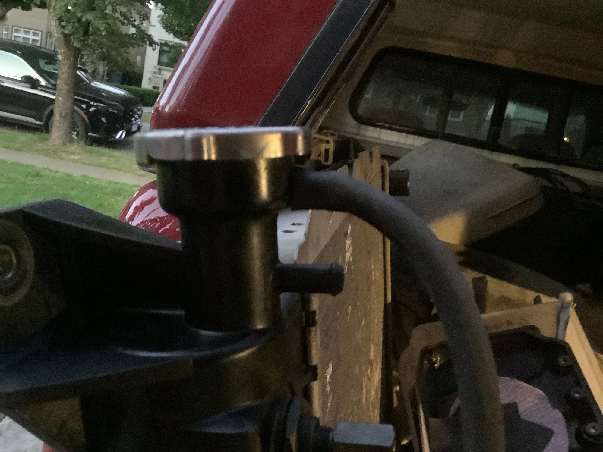

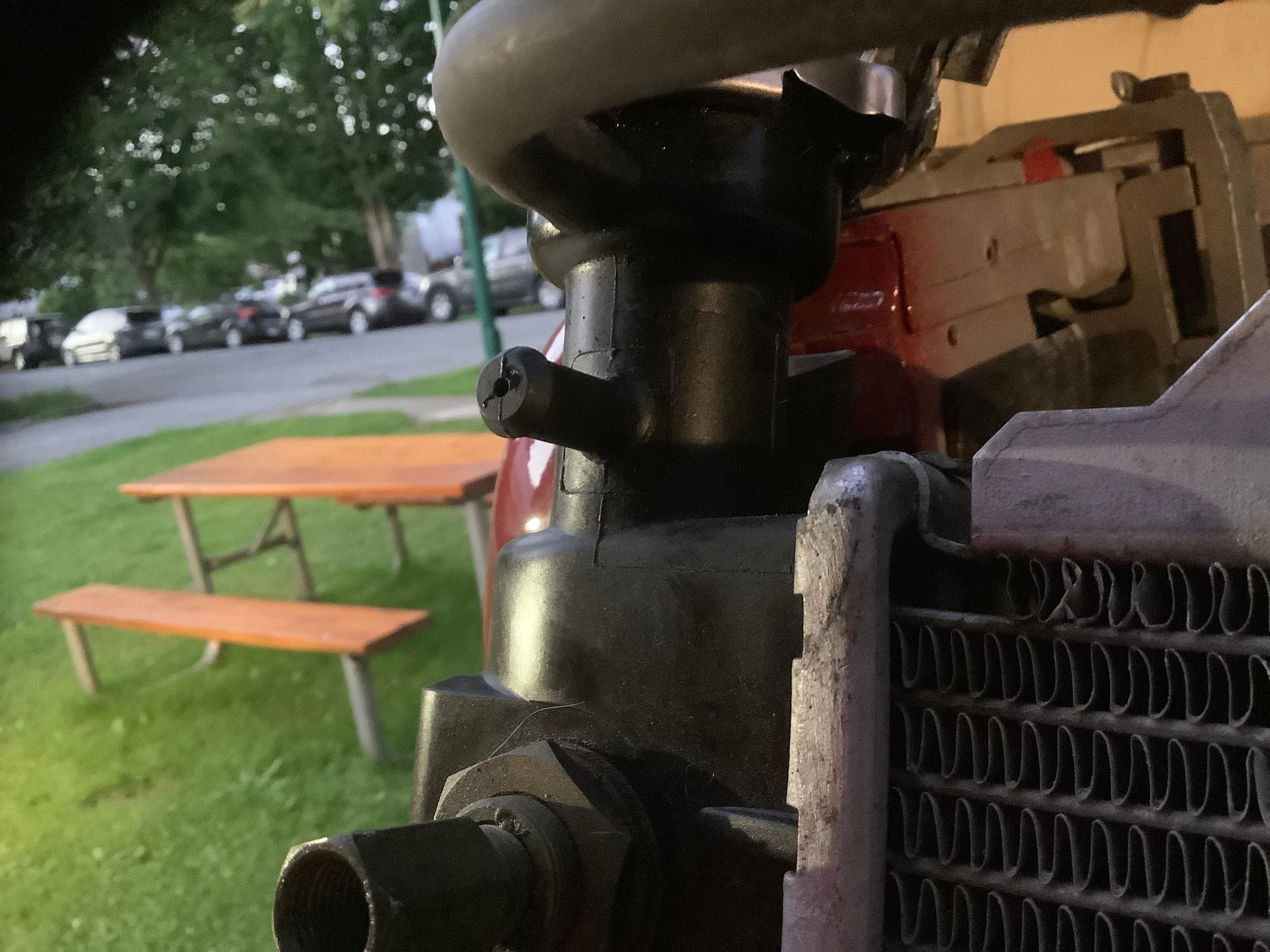

I just wondered what or where did the lower hose connection go to.
the hose under the radiator cap goes to the expansion tank I know that.
but the lower fitting is a direct connection the the pressurized section of the radiator..
and answers would be good …thankyou

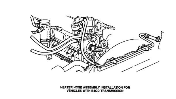

Originally Posted by AuroraGirl
its T'ed into the heater core hoses, i forget which one
Nope. As shown in the picture..
It goes to the upper port on the throttle body. That says with E4OD but I don’t know if the trucks I got that steel hose from all had an E4OD’s or if some only had HD cooling.
yes,i forgot to type when I posted that above, im about to pass out lol.. but yeah I was going to say the OP needs to know if he has E4OD or not, if not it needs to be plugged, if its an E4OD, then to the carb.
I think the 4.9 uses it in the heater core hose because of the cap being on the opposite end of the radiator so its shorter trip, and based on how the water pump is the one pipe and the t stat housing the other .. probably chose for that reason, plus the throttle body on the v8 sits a lot higher than the i6 so it may be just related to whats in the highest point of the cooling system

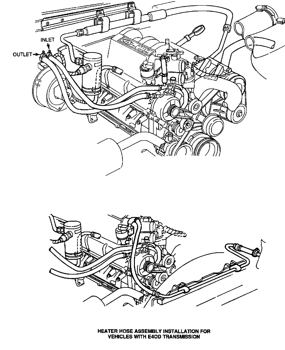

Originally Posted by 1Butcher
That pipe/hose is used to bleed the air out of the cooling system. By dumping the air to the highest part of the radiator, over time, the air is bled out. Mine [5.8/E4OD] comes from the throttle body. I have recently bypassed the throttle valve.
and a often cause of gurgling is having the heater core hoses swapped, because it disrupts the bleeding.
I saw the TSB and then looked at my hoses one day and went "yup.. when i did my water pump they got put on backwards .lol":

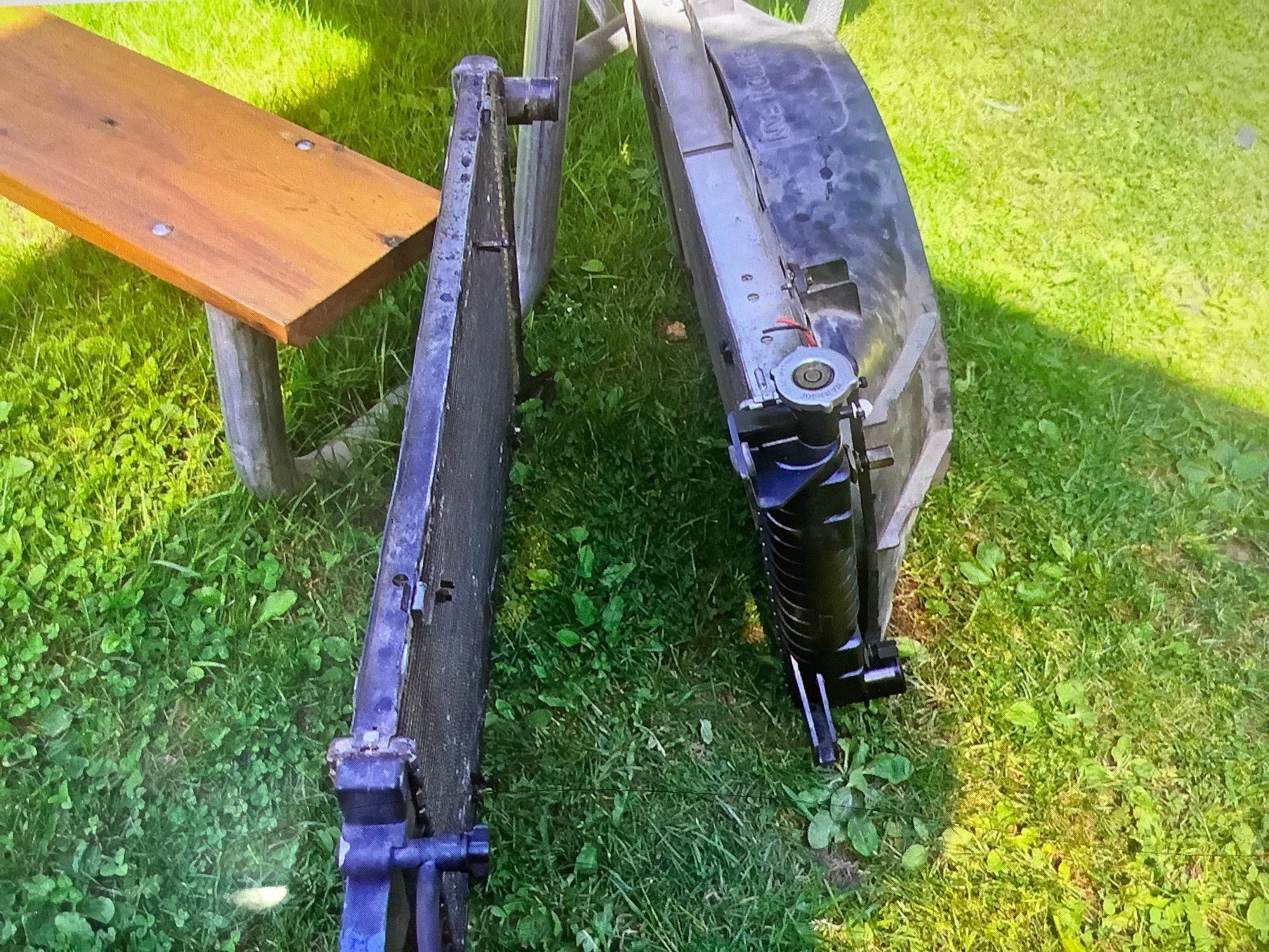

Old radiator next to junk yard new radiator.
plus I gave the fan some love.
i also had an old Honda slim electric fan lying around so I mounted that on the inside of the radiator.
all works pretty good.
cant wait to be going through Lytton in plus 40 going up hill pulling the boat and see what happens ha ha.
this Sunday just gone it was 39.9c in Lytton BC
You might as well put a piece of cardboard in front of your radiator.
You have now successfully restricted air flow.
Don't mess around with the air flow.
Old Jun 10, 2025 | 03:13 AM
rocketroy's Avatar
rocketroy
Joined: Dec 2004
Posts: 177
Likes: 24
From: Vancouver
i ran it and let it idle for 45 minutes to see what would happen..
the temperature was bang on what it was with the original radiator.
even though this radiator is from a 7.5 liter and now it’s in 5 liter.
Correct, I think that was mentioned in your other post "FATTER RADIATOR", they are the same radiators.

a pusher fan needs to be in front of the condensor
The fan in the center is a puller fan , it will only interupt the air flow through the radiator
But you likely have enough flow through it because its large and the core support/openings are big and its a brick so the air pushes through, but now with more resistance
If its mounted backwards it will fight the radiator fan AND be turbulent
its a novel idea but even if it was a pusher it needs to be able to pull air readily, youre just gonna have high amp draw
