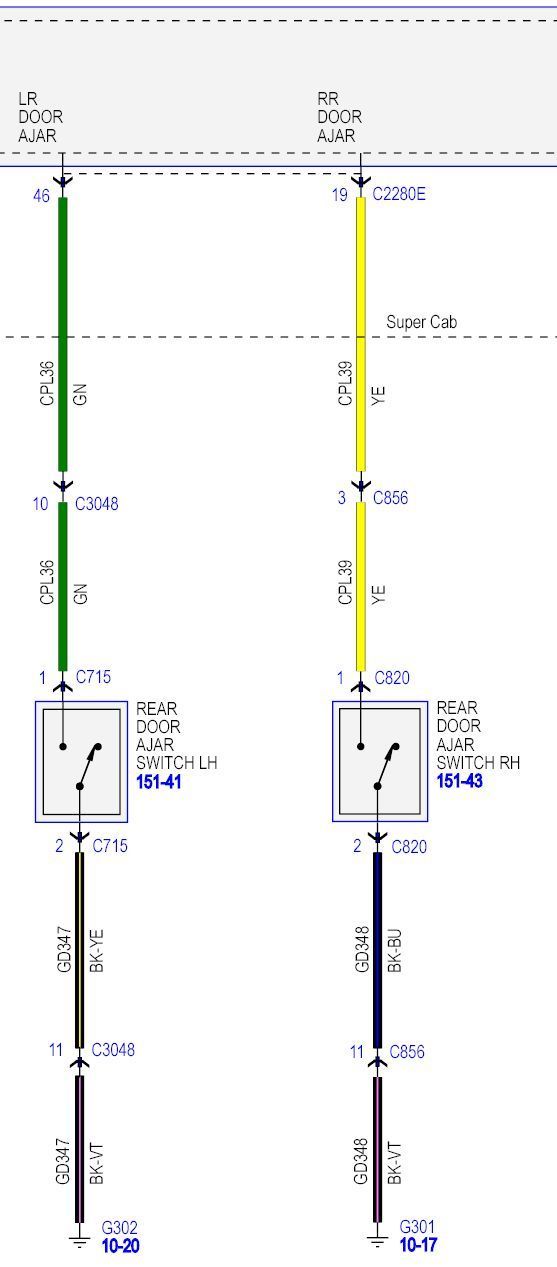

Hello Everybody, Does anybody know color of the door ajar switch's in a 2022 F350 SD (I think it's plug C526 ~ but need the color of the wires) ? I need to tap into them in the cab, past the C510 connector if possible.
Best, Everett

THANK YOU!!! - Do you know if the GPL26 wire is the same for all four doors?

Thank you very much!!! This will help me with my project!!! Best, Everett
