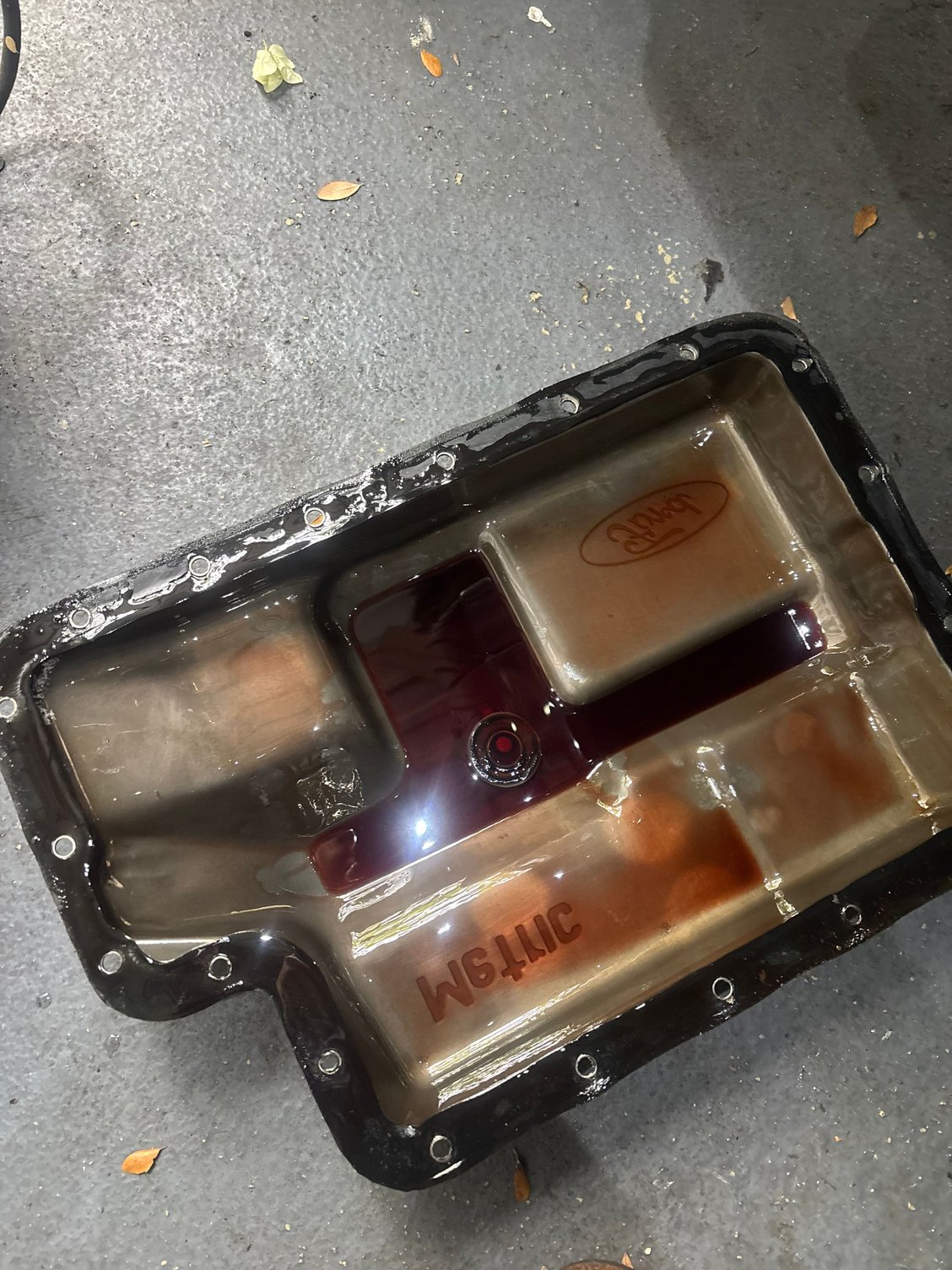

this morning i replaced the solenoid pack in my 94 Lightning after a suspected failing EPC in the old pack. The reman pack (from cobra transmission) bolted right in and was a smooth install. however, now reverse engages extremely harsh, but drive engages a bit softer than usual. in order to move about an inch in drive, i need to rev to about 1500, but in M1 and M2 moves as it should. Worth noting all was normal except for that failing EPC before i replaced the pack. fluid is bright red and at level. there was no major clutch material on the magnet. i suspect this is just a case of bad parts but im willing to hear what you guys think. TIA

this is the same trans that i allegedly cooked. to my suprise. there is no signs of clutch material or metal shavings on the magnet.
fluid looks a little dark but i’m pretty sure it’s just due to wear.

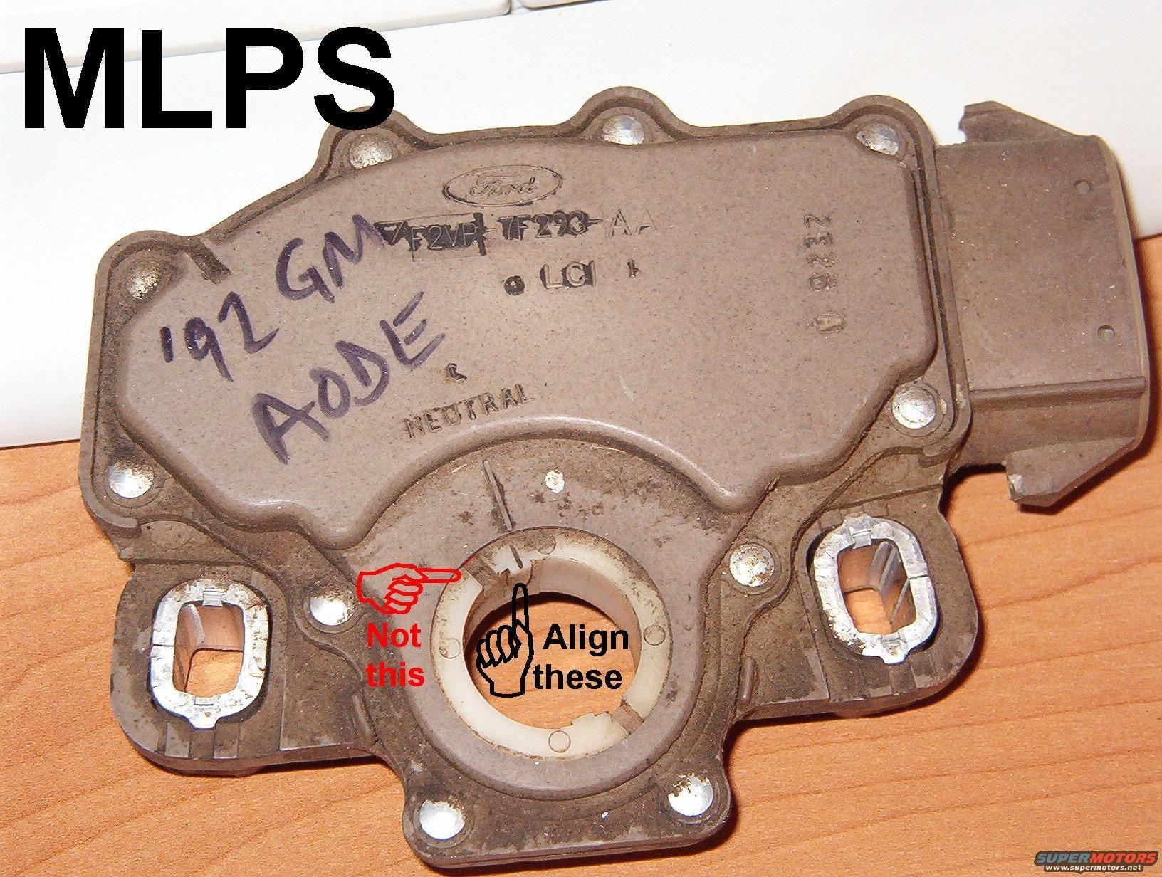

Which ‘plug’ connector, just to make sure we’re all on the same page? The MLPS (TRS) or the Solenoid body?
You need to pull the shift lever off and verify it. Here’s a pic, courtesy of Steve at Supermotors. You need to make sure the alignment notch is aligned. Was it recently removed or replaced?
i’m talking about the plug to the solenoid pack connector. If you guys bear with me i should be able to check the MLPS in a couple days or so since i’ll be out of town. My issues are so intermittent. on my way to work it shifted just fine, but on my way home it started acting up again. in order to get to speed properly i have to shift through M1 and M2 then drive then let off the gas, and it’ll catch third. I turned the truck off then on then the issue went away and shifted normally. weird.
