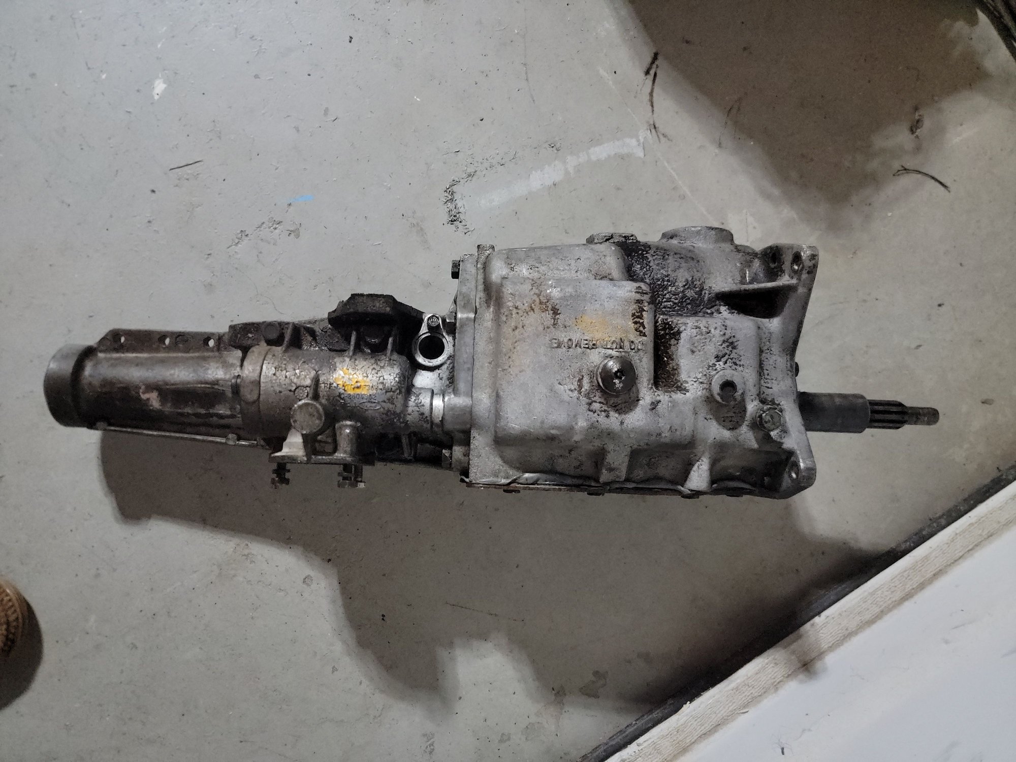

Door jam tag says 'B' under trans.

https://www.google.com/search?q=1984...hrome&ie=UTF-8
You should be able to decode the door tag from there, just verify the model year.
I would think Gary's site would have the decoding too. I know I've seen it before...
Found this,
B = BW T-85 3sp ('76-78 ), Clark OD 4sp ('79-86), Ford SROD/Tremac T170 4sp, or T199 (Mexico only)
https://www.supermotors.net/registry/media/72354

B = RUG SR-OD Single Rail 4 Speed O/D: 1978/83 E/F100/150
Here's an old thread.
https://www.ford-trucks.com/forums/1...nsmission.html

Yep, that's exactly what the guy told me that is doing the rebuild..
I got it out last night though it took me about an hour and a half. It wasn't too bad.

So is it a Borg Warner?
I see it's a Clark OD 4sp, But I'm no expert.
https://www.google.com/search?q=Clar...hrome&ie=UTF-8

And I see it as a Tremac but I cant see to good and got papers to prove it
Any of the 3sp w/ over drive (4sp) are weak and dont last but it is what it is.
It's a derivative of the old Ford toploader design. So technically I guess it is a design from Ford. Who actually made it, Ford or some other contractor, I am not sure. In the one picture above you can see "FORD" emblem cast into the side of it.

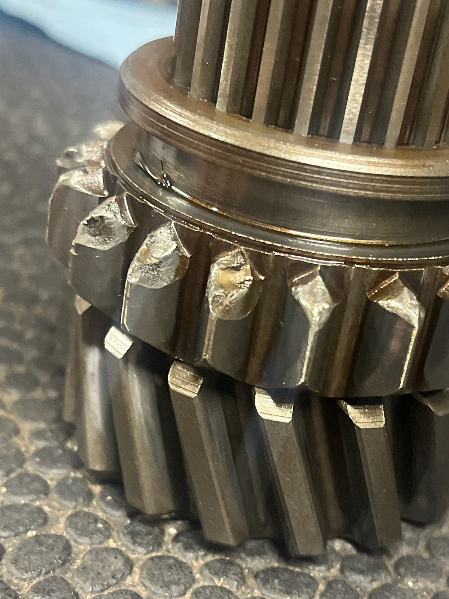

Just to follow up... I took it to the guy who is doing the rebuild. I was there when he cracked it open. It basically had usual wear and tear. There were a couple of broken chips in the pan from one of the gears and that silvery color of fine metal shavings (powder). He is putting a new rebuild kit in it. The bearings were pretty shot. It made almost a roaring sound when I was driving it.
Hey, thank you guys for all of the info. I appreciate it.
here are a couple of pics

He is replacing that gear correct? That might require some hunting to find it. The roar may still be there if that gear is not replaced.

Yes, though some of the parts are no longer available, he did find that part. Hopefully between that and new bearings, the roar will be gone.
