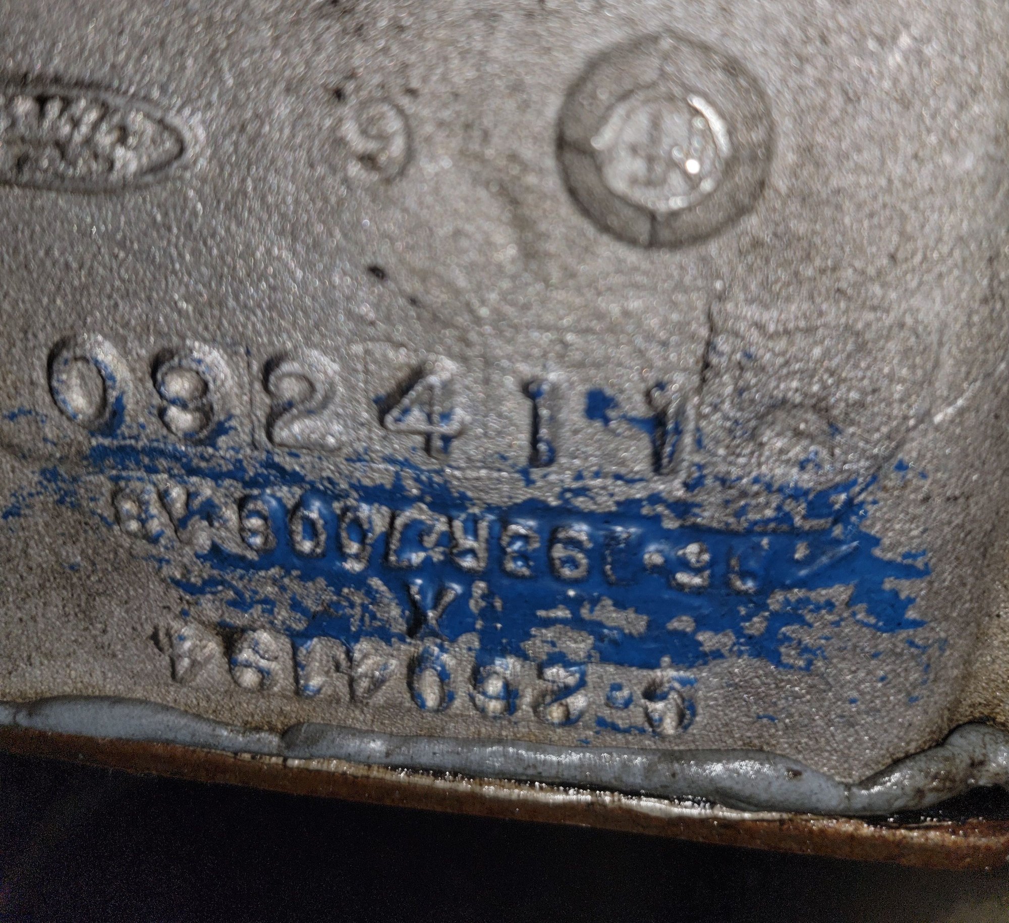

Can anyone decifer this? I believe it is a  Borg Warner.
Old Jun 4, 2025 | 11:53 AM
  #29
Franklin2's Avatar
Franklin2
Joined: Jan 2001
Posts: 56,984
Likes: 2,738
From: Virginia
What is the trans code on the door jamb sticker? I believe Borg Warner did make the overdrive 4 speeds. There are a couple different kinds though.
Yes best to go off the sticker in the door jamb but I did not think either of the over drive transmission were BW's thought Tremic (sp?)?
