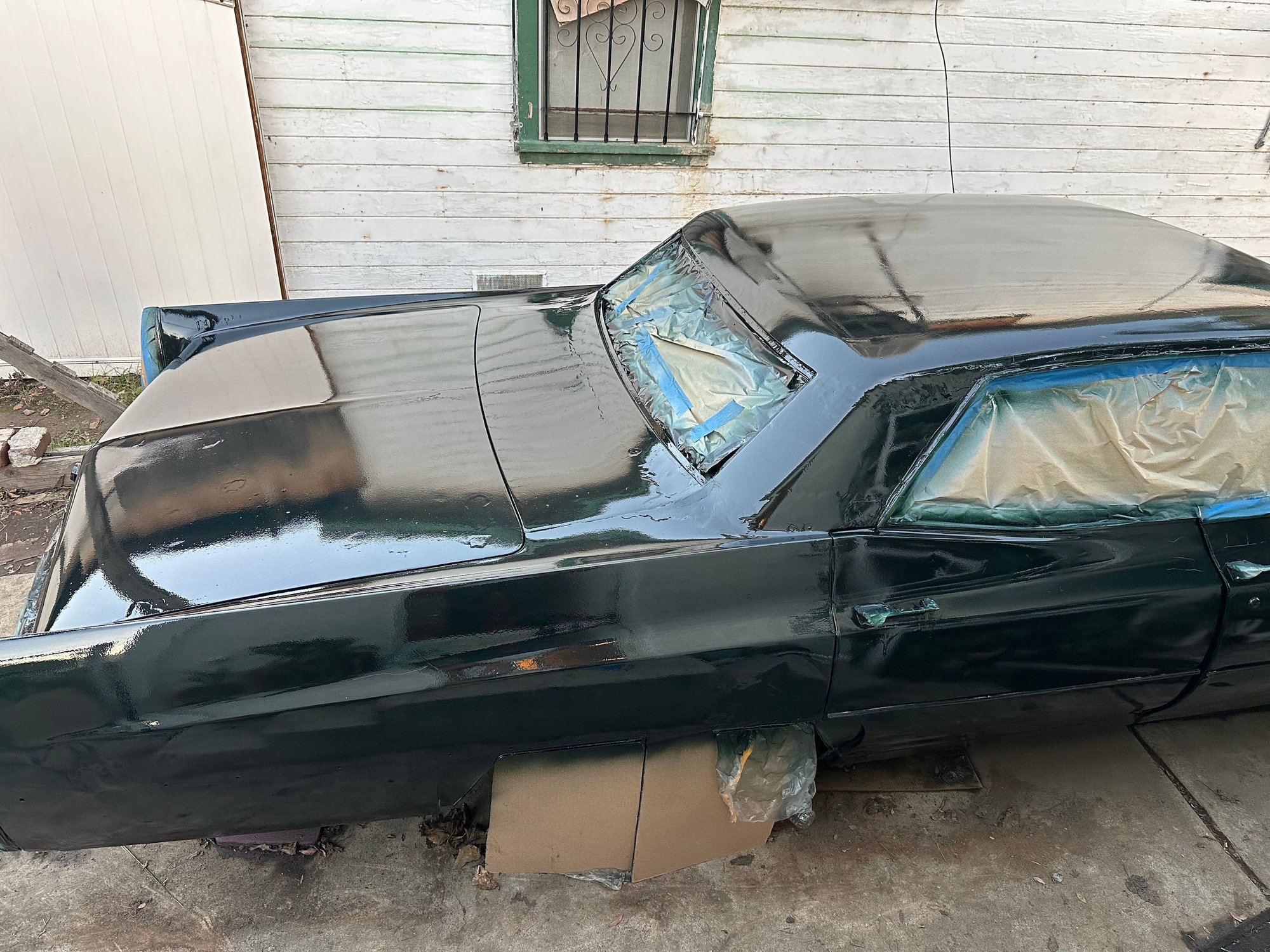

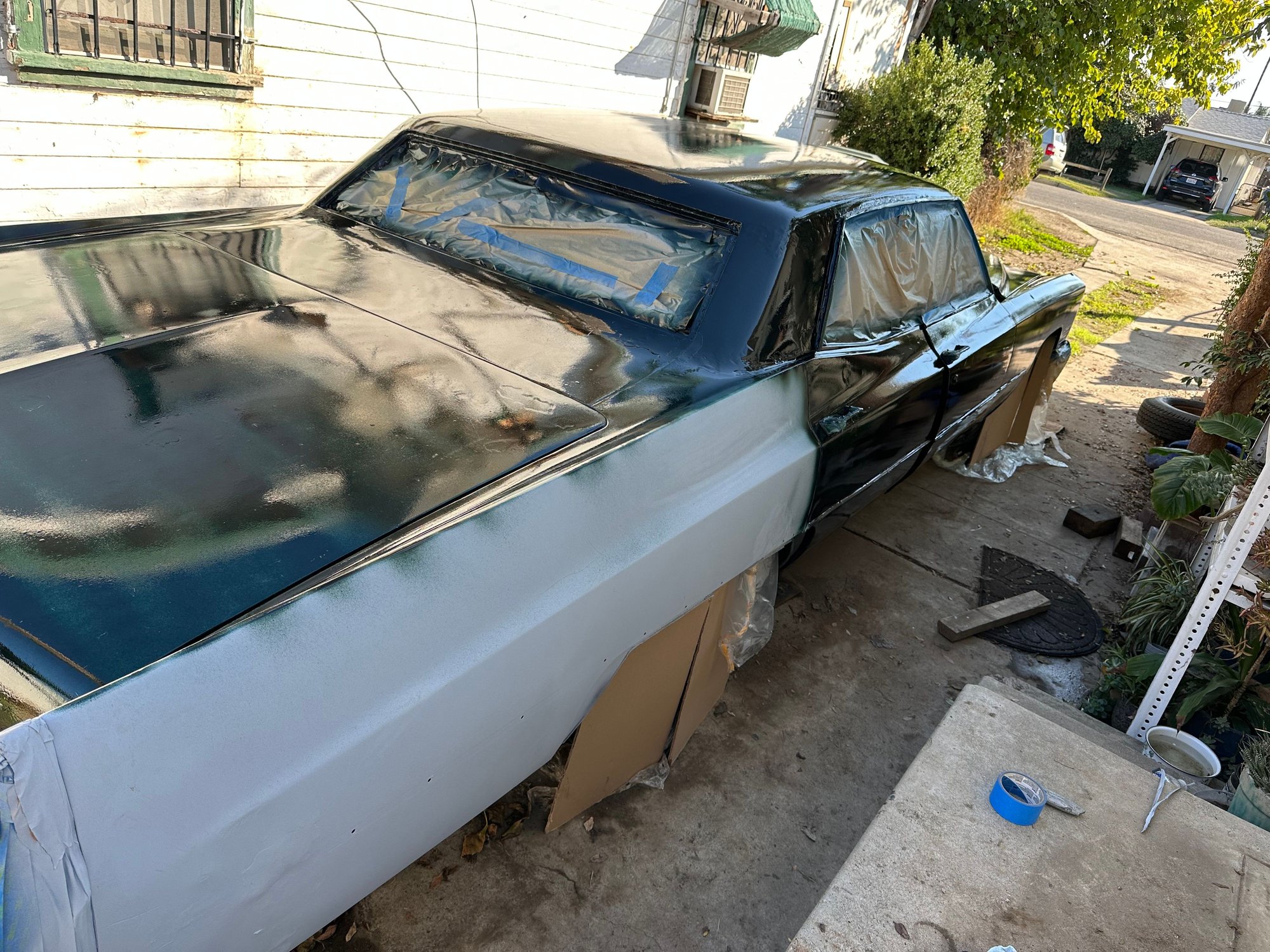

I knew a storm was coming, and the house of cards started falling days ago. I expected to start priming on day 1, but I found more roof rust, then it took me 2 days to mask, ....and the storm was to come soon. The day I primed was the last day I had to spray. The weather said the following day(alleged paint day) would be sunny and warm with a slight breeze. What I missed was the update, which turned paint day into a 30mph gusts and blowing dust. It was almost the worst situation and I was desperate/stupid enough to actually mix and try spraying paint.
It did not go well. Anything I did spray has tons of little leafs and sticks in it. Too dark to see the dirt thankfully. but those were removed panels, like the wheel covers and the front cowl cover.
I sprayed a "fog coat" on a few panels of the car and that became a magnet for blown trash, I thankfully stopped and will more than likely respray those car panels in primer, then start from scratch with the paint.

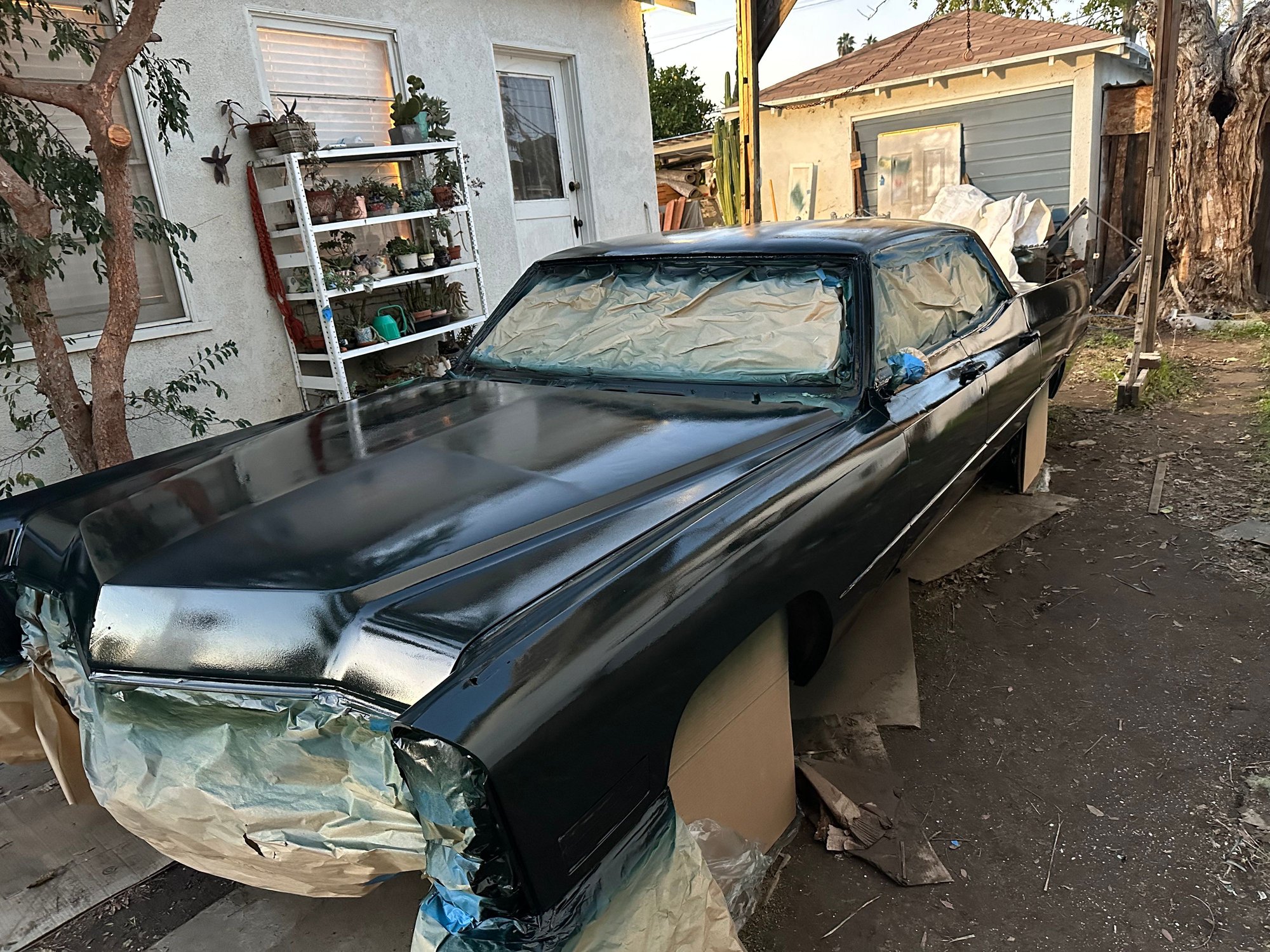

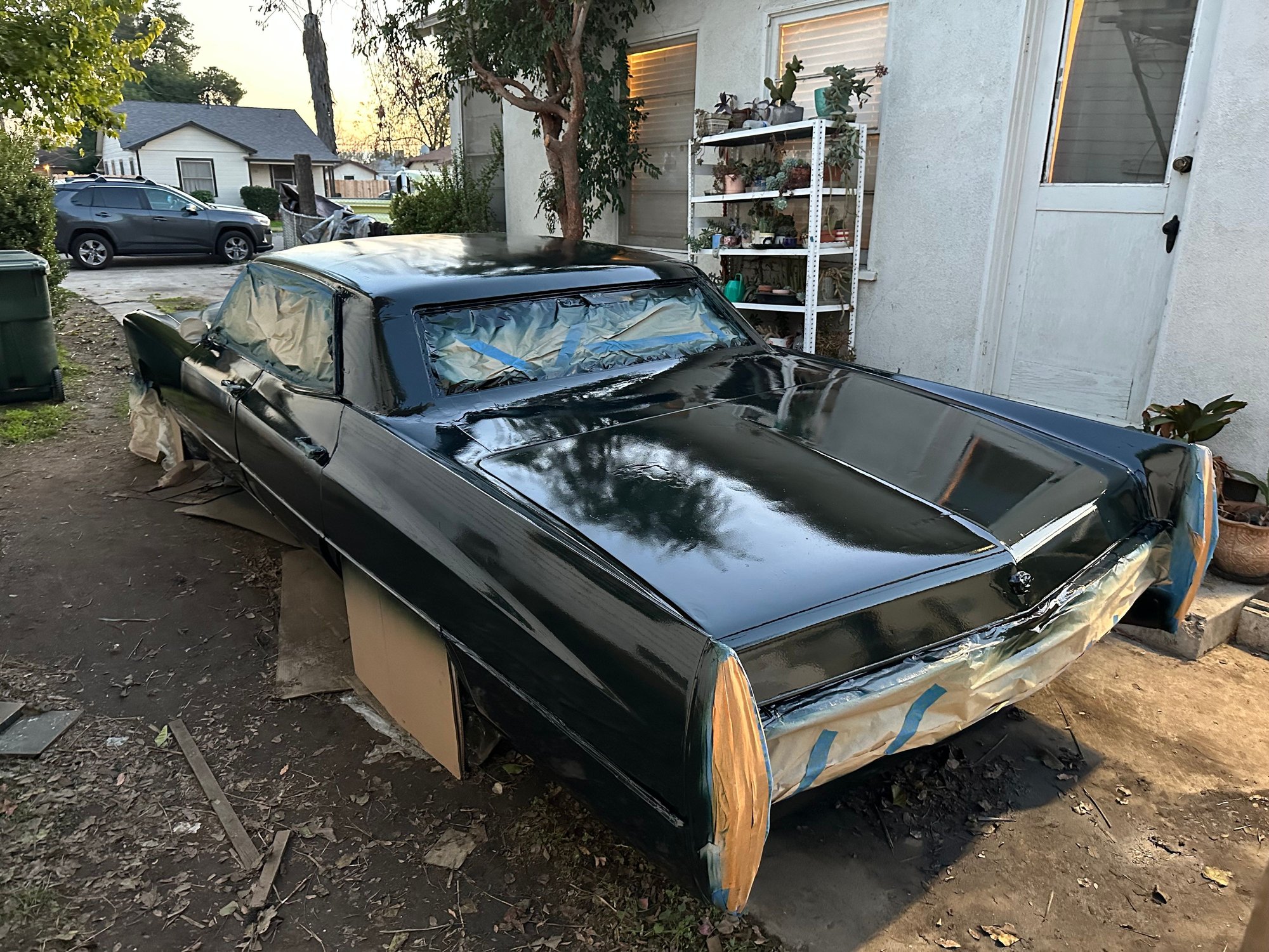

Painted today, 63ºF.
Looks good enough, will not be buffed.

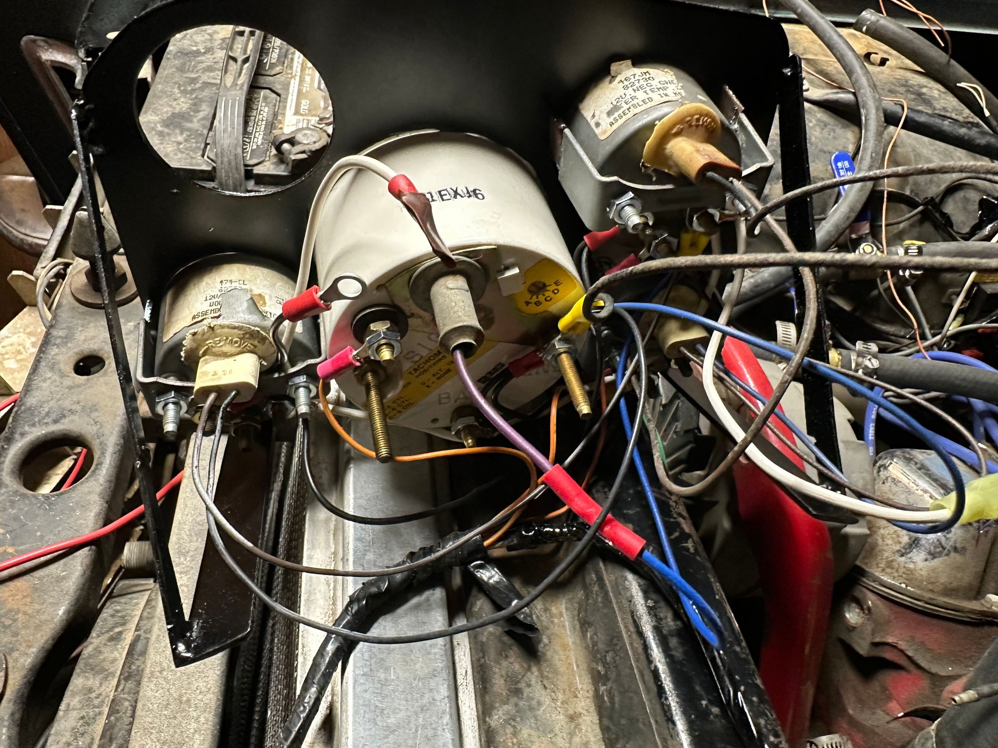

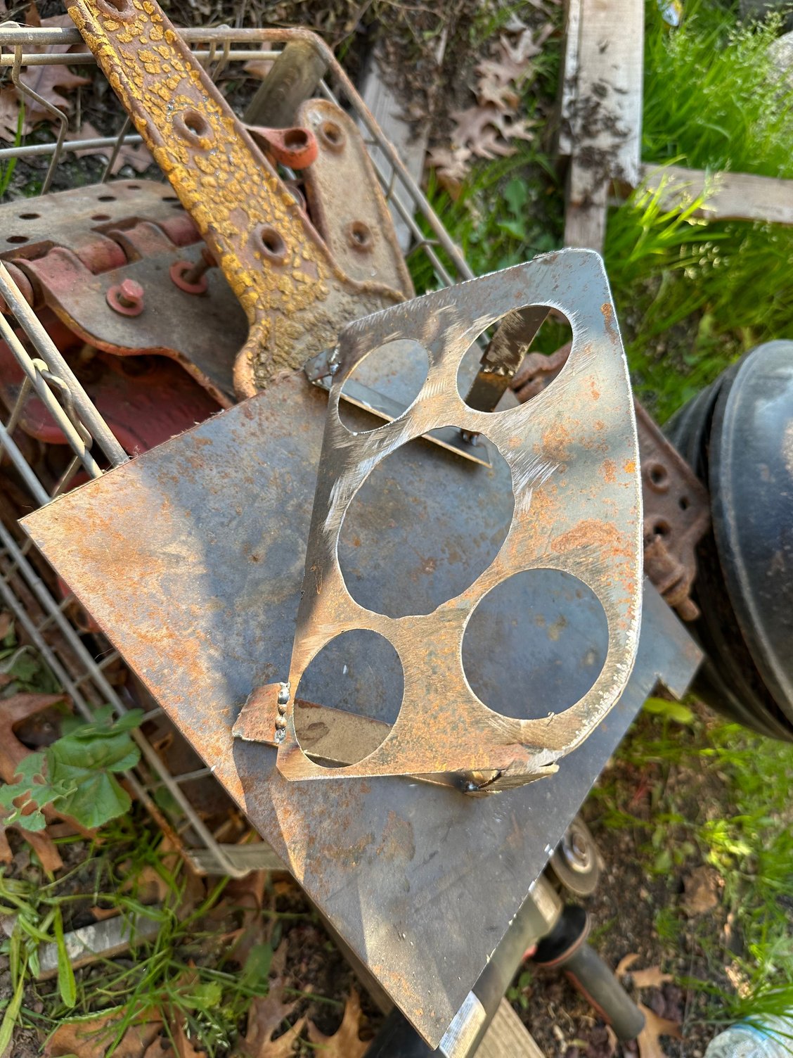

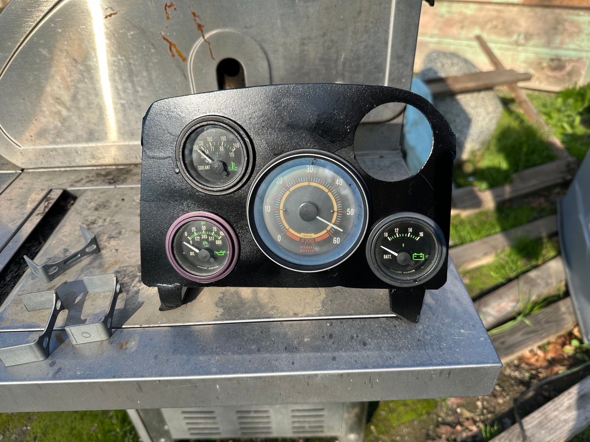

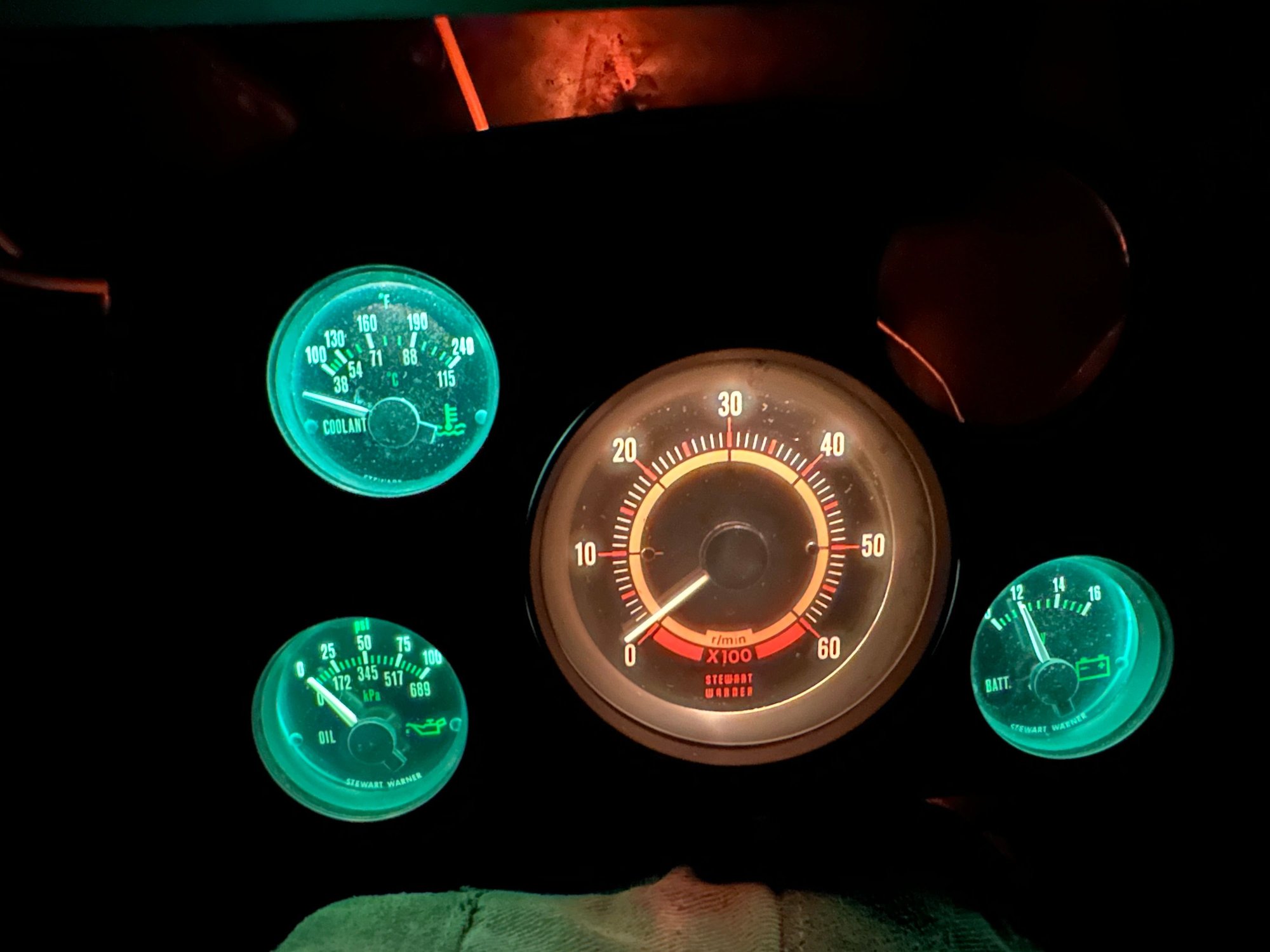

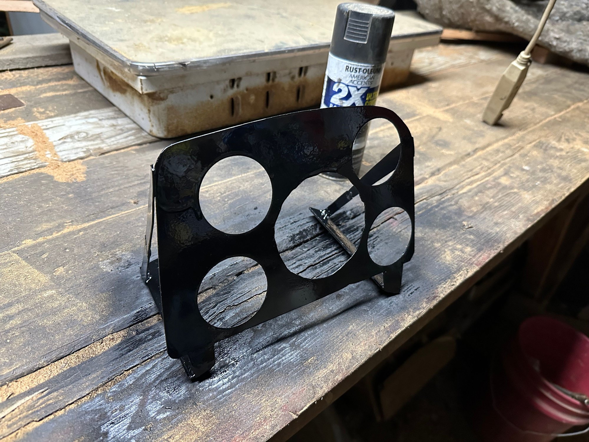

As classless as it is to have cheesy race gauges in a Cadillac I couldn't stand not being able to read the metrics so I carved some holes in a garbage fabricated gauge panel and used some gauges I have sitting around of which all gauges are electric sender type, however I've not yet driven the car with the setup so hopefully it works ergonomically; I may fill the last vacant gauge spot with a trans temp gauge.
