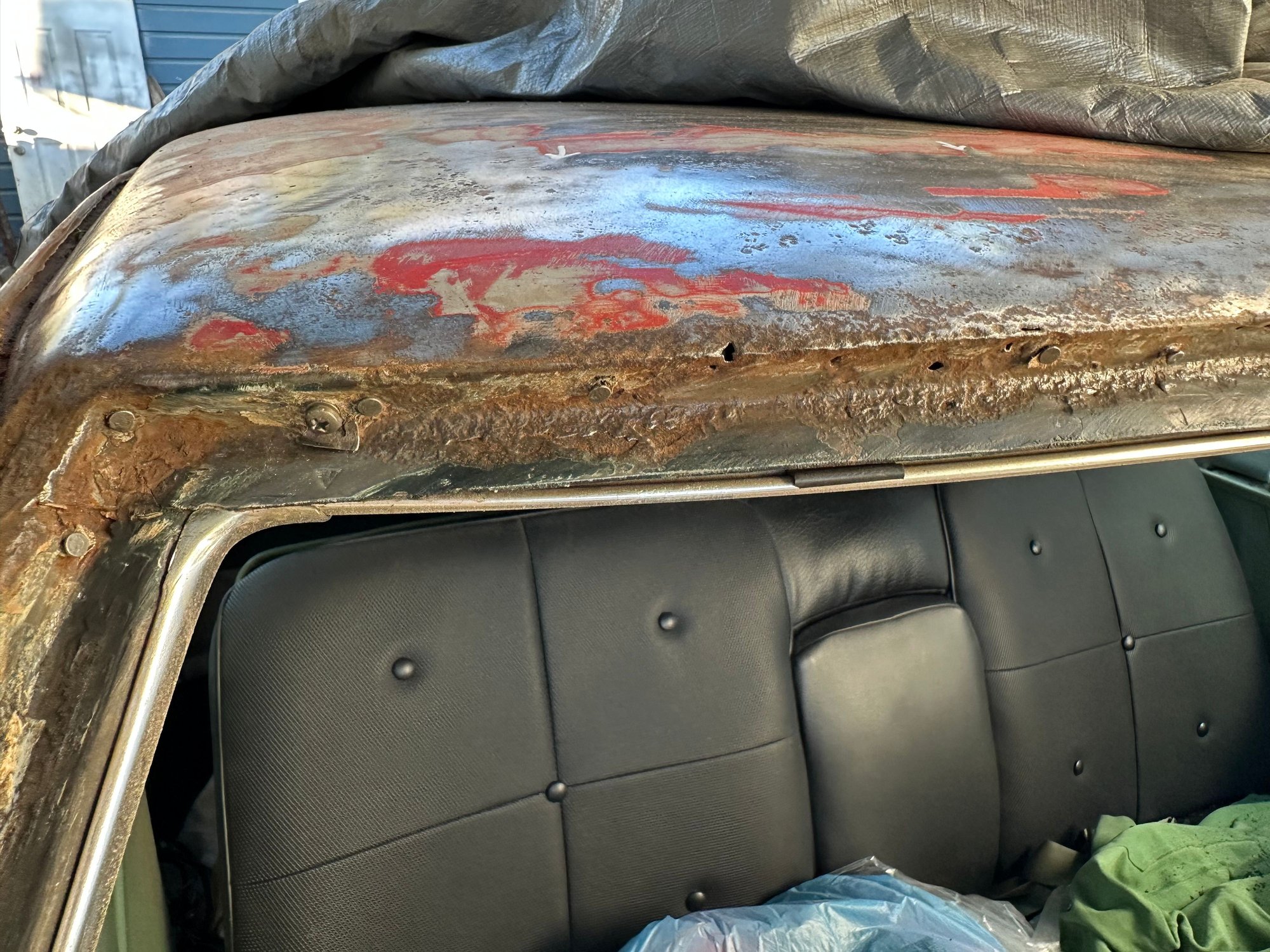

Passenger lower rear windshield channnel

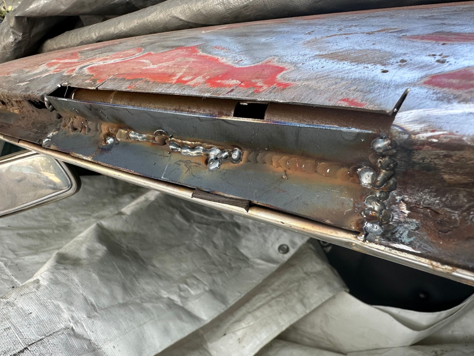

Another random piece of channel

The front window was a surprise, it was much much worse than the rear windshield channel. Added 10 days of extra work I wasn't planning on, 97% of the top front windshield channel was replaced, what a pain.
The nailhead on the left is what they used at the factory to hold down the vinyl top; the nailhead on the right is for the special clips that retain the stainless window trim.

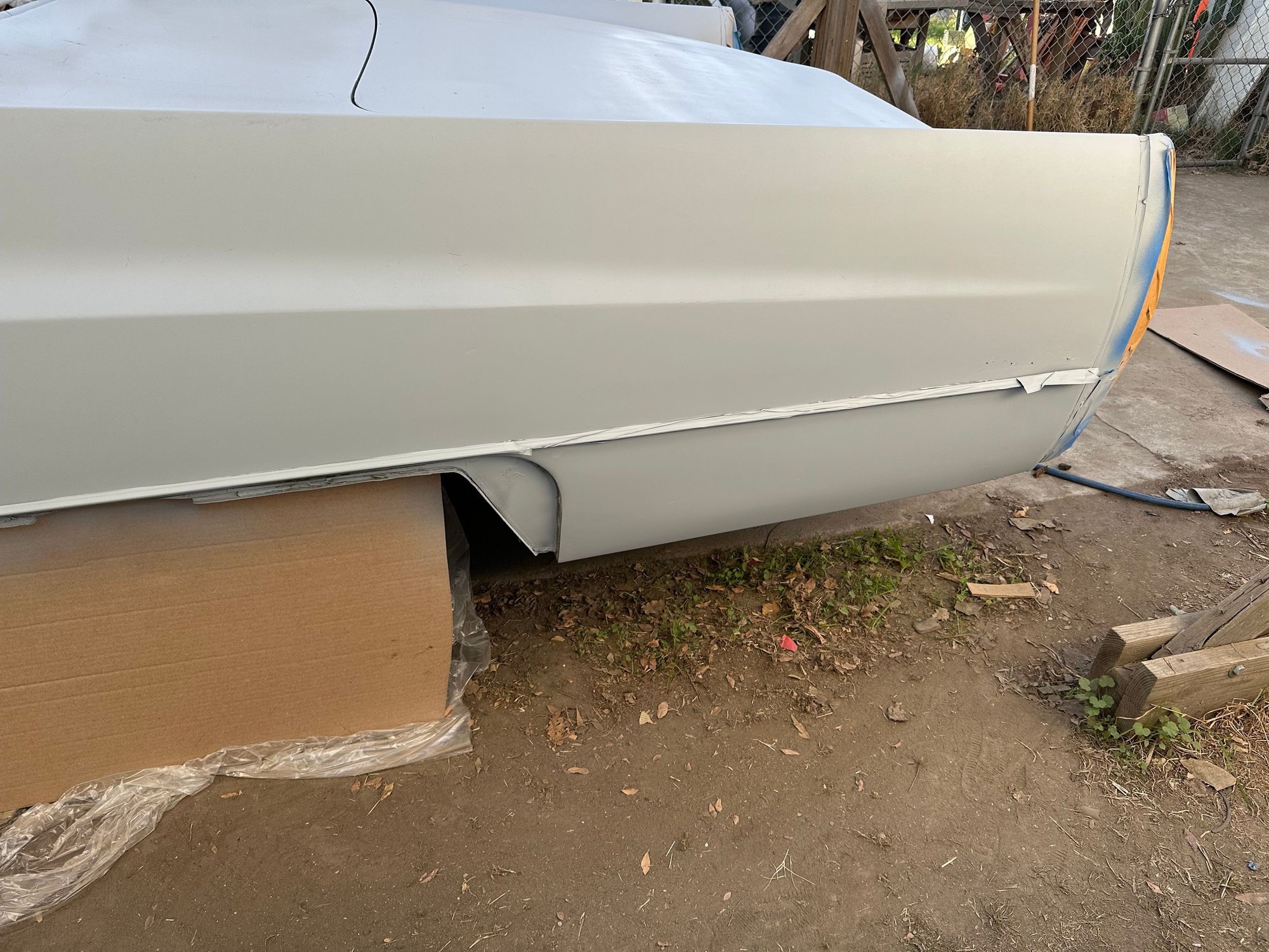

11-5-25
Passenger fender

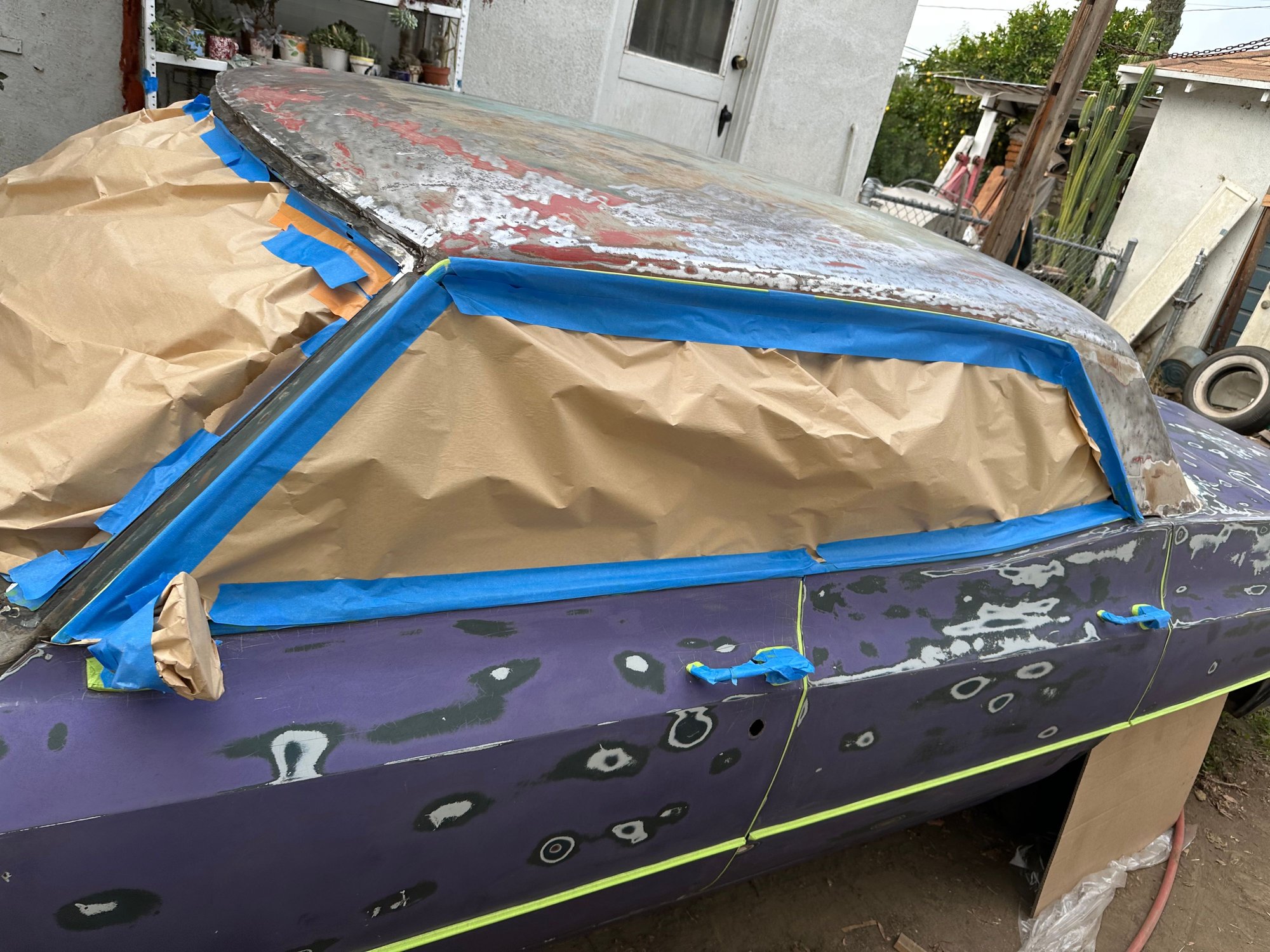

Body filler phase.
I was in a rush and honestly couldn't care less, I was so lazy I didn't even sand it, I got out an angle grinder with a stripper disk and went at it till I though it was good enough. No finished pictures.

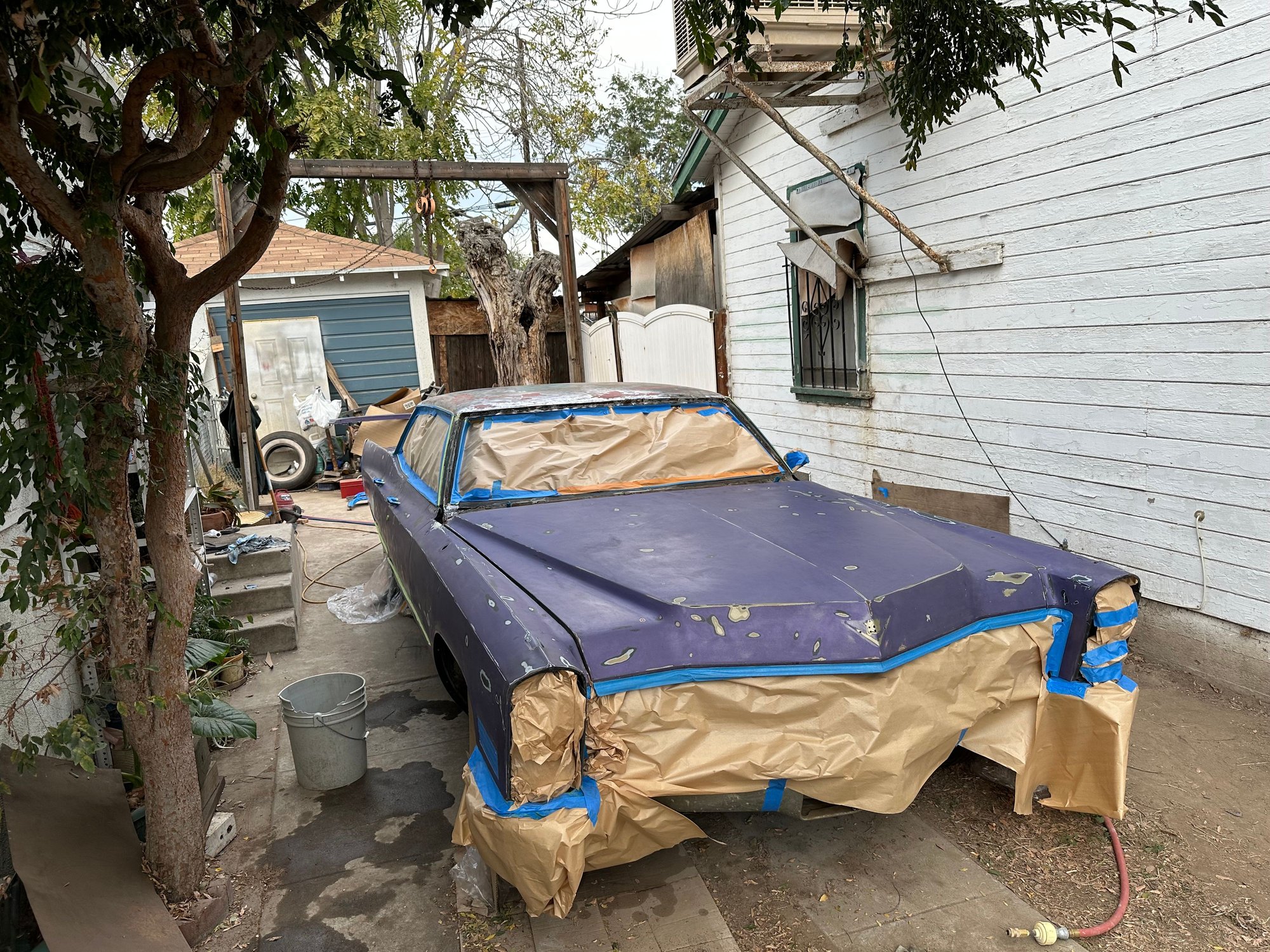

I have done masking before and knew darn well it takes forever, but for some reason I completely under estimated the time it'd take , took 2 days to mask off.

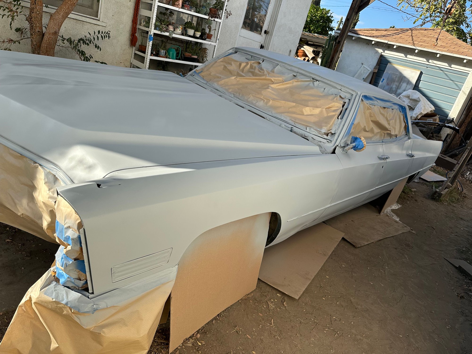

More masking.

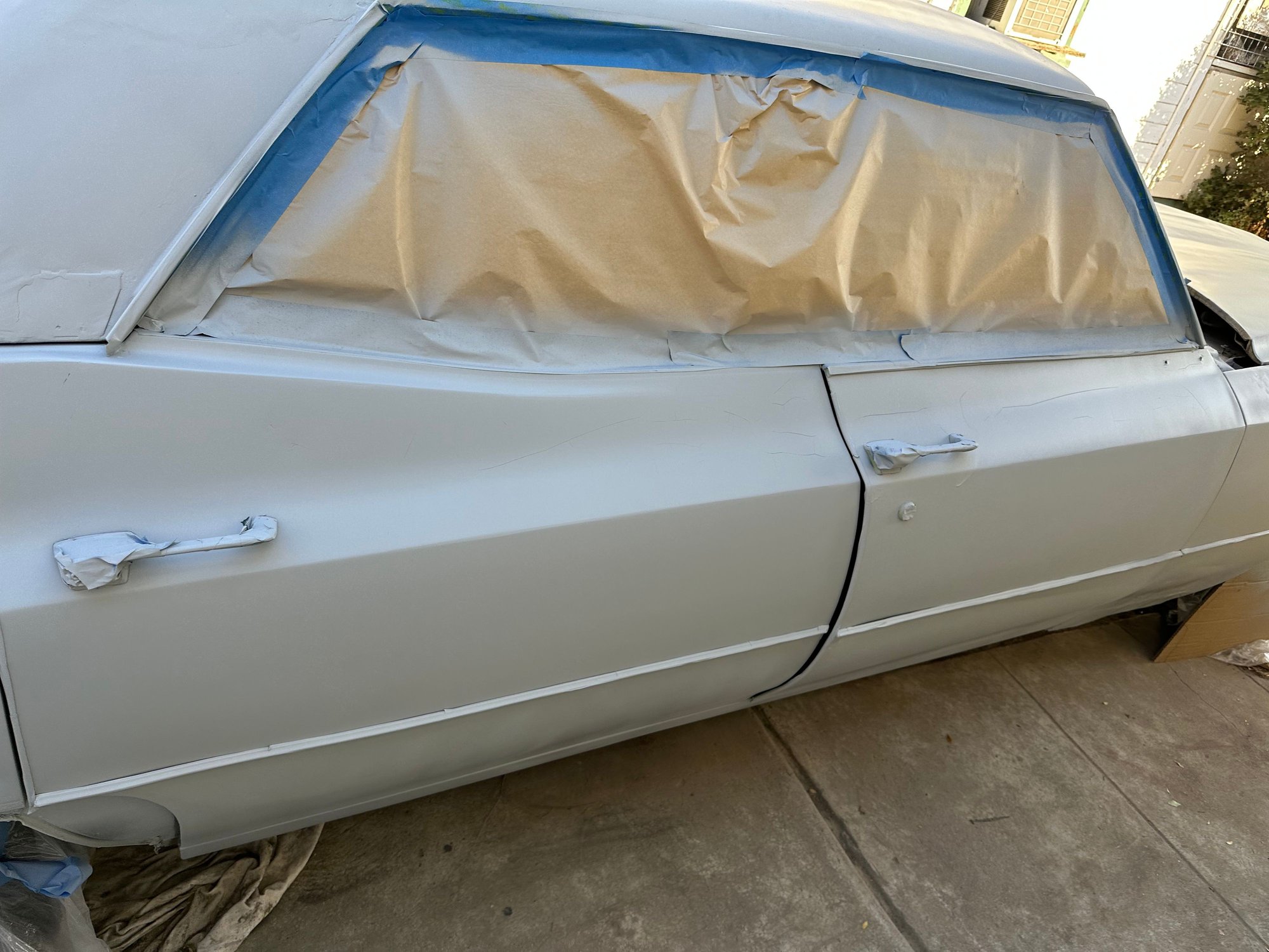

I hate spraying primer because I've never been good at getting it to come out of the gun, sometimes it spatters like its globbing too wet or something, sometimes it's too dry, sometimes it lays down just right.
Could be because I refuse to use a good gun and keep using the $17 harbor freight purple gun. On day 1 I started out ok,I mixed a small cup of primer in a test batch, it sprayed PERFECT.
Then I spent 3 hours, 2 completely wasted large cups , and 2 brand new paint guns....all of it wasted...I could NOT get the primer to spray, then it clogged up gun 1, then I broke gun 2 tring to clean it while brand new. I rushed to the store and bout three more, and in about 1 hour I primed the rest of the car and it worked mostly well.
