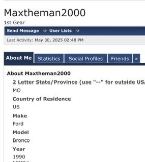

Originally Posted by russmoxon12
You're in luck.. I have a 302 that I want to off load out of a 90 f150! How far away are you from Eureka CA?
Not too bad. The OP’s profile has Missouri
