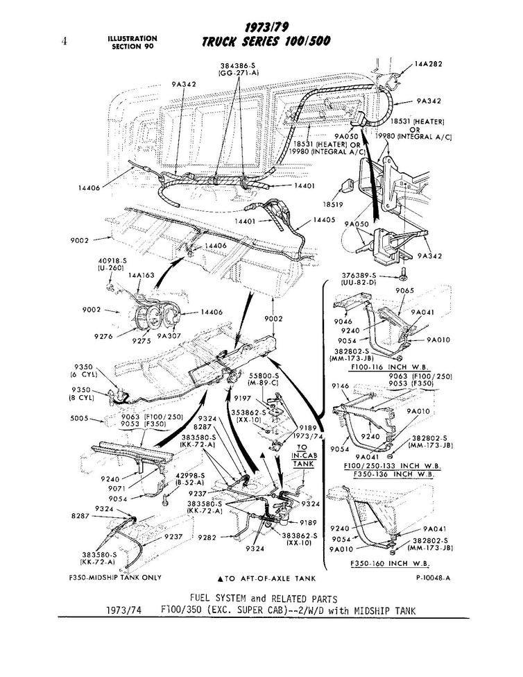

No vacume to it. All electricial, 2 sending units (one in each in tank), one elec change over valve back on the cross member in front of the aft axle tank, and one switch on the enviromental control panel than controls the valve. Test the sending units like this....Disconnect the wire that goes to the fuel sending unit at the tank. It is a 2 prong push on elec connector and hard to reach the back one since it is so close to the bottom of the bed. To pop the plug off for the test, you can barely get up in there with your head and see the plug. While looking at it, VERY CAREFULLY use a screwdriver to pry it off. AND I MEAN VERY CAREFULLY. It is only pushed on like a 1/8". This is only if you can’t get it with your hands.
Once off ground that wire to the frame, making sure the frame is clean. Turn the ignition to the "run" position and watch the fuel gauge. If the gauge swings all the way to full, either the sending unit itself is bad or it has a bad ground. If the gauge stays on empty then either the gauge is bad or there is a wiring problem.
MORE HELP: So if your gas gauge is not working and you are questioning the gas tank sending unit or the instrument cluster VR or the fuel gage itself being bad... read this. Scott Scott posted these troubleshooting steps and I had to save them for there simplicity. Thank you Scott. "The following assumes the oil & temp gauges are working. If the other gauges work, the cluster voltage regulator is good. Ground the wire that connects to the tank sending unit. Turn the key on. The fuel gauge should go full scale. If it does go full scale, your sender is bad.
If it doesn't go full scale, check the sender wire for breaks running forward along the frame. If no breaks & wire shows continuity, remove the cluster. Connect wires to the studs on the fuel gauge, power wires with a 1.5V battery. NOT A 9 VOLT Gauge should go to about 1/4 scale. If gauge doesn't move, gauge is bad, replace it.
78/79 duel fuel tanks frame switch-Duralast/Universal 3 port fuel selector valve used with SW48 toggle switch Part Number: FSV4

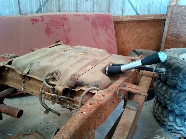

Here are some pics of the selector valve. And the elec connector for the sender. Yes easy to get to with the bed off, HARD to reach with the bed on. You can also use some long handle needle nose pliers.
With the key in the 1st position (truck NOT running) and you flip the switch, you should normally be able to hear the valve change over. Or get back there and get a hand on it and have some one flip the switch, you should be able to feel it click/vibration wise. Also make sure you power to the elec connector. Test light time.
