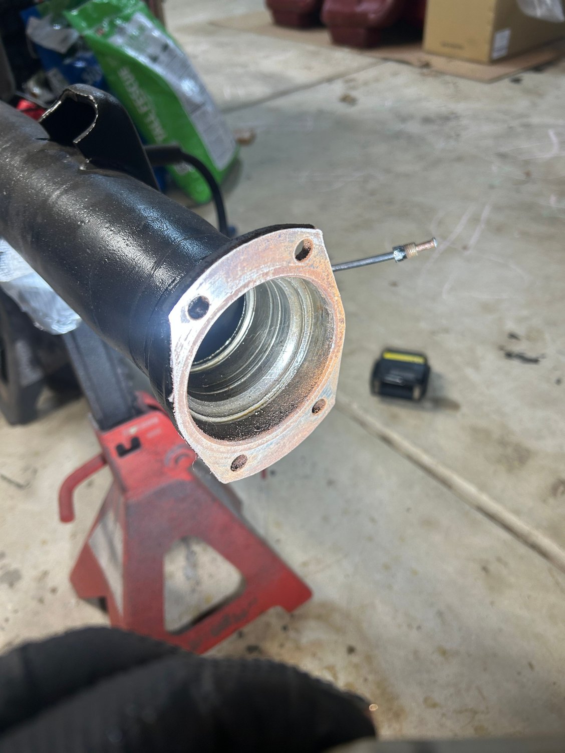

Based on the pictures below where the seals and bearings will sit in the rear axle housing, should I be concerned about the rough looking condition of the housing? I am working to clean up the rust on each end and get painted before it gets reassembled. Also, can the studs be reused in the differential housing if I hammer them out so it would be much easier to clean the rust instead of working around all of these. Thanks.

Don't take my advice as gospel but based on my experience rebuilding the 9" rear in my '84 F150 I'd just clean the race area of the housing real good and get it smooth again. As for the studs I wouldn't trust anything that's press fit to reuse. Just my thoughts. I very much enjoy following the progress on this build, thanks for keeping this thread updated.
