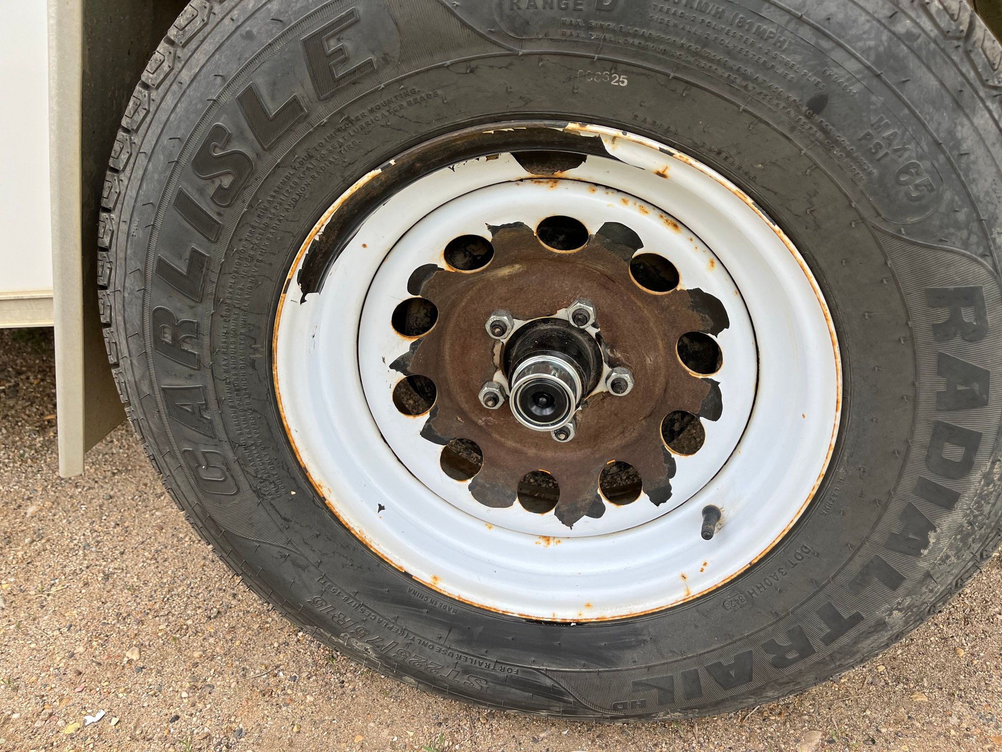

I fixed our scout trailer. It was doing the exact same thing.
I bought 16 new caps for less than what I spent at TSC for the one cap on the pop up camper. I also sprung for a cap installation tool …. Game changer - highly recommend.

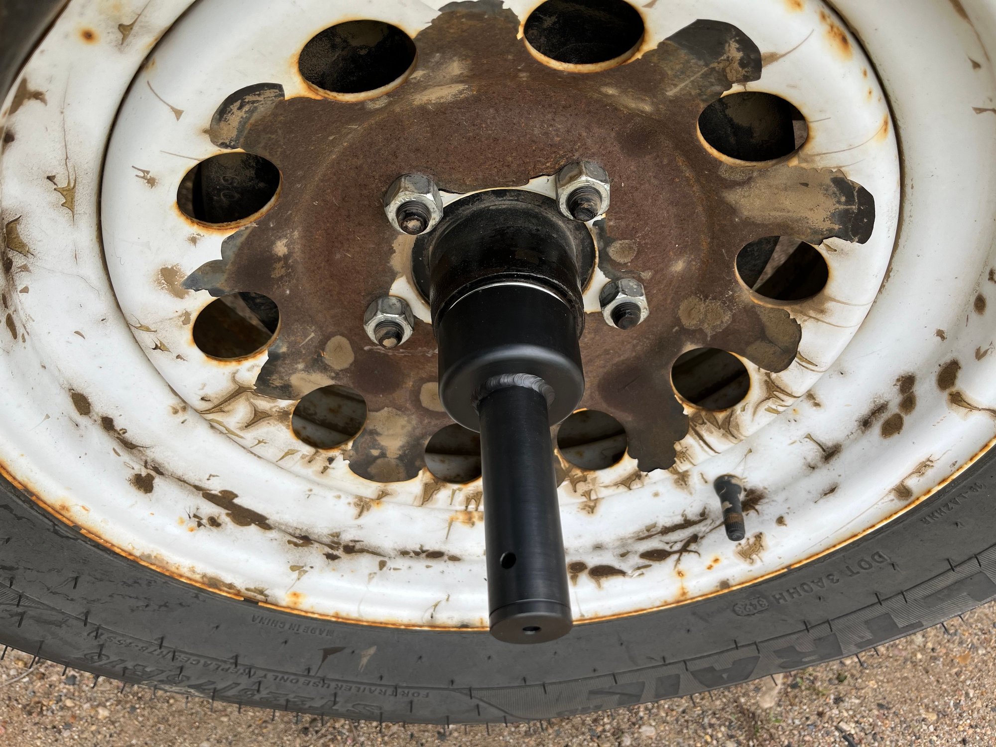

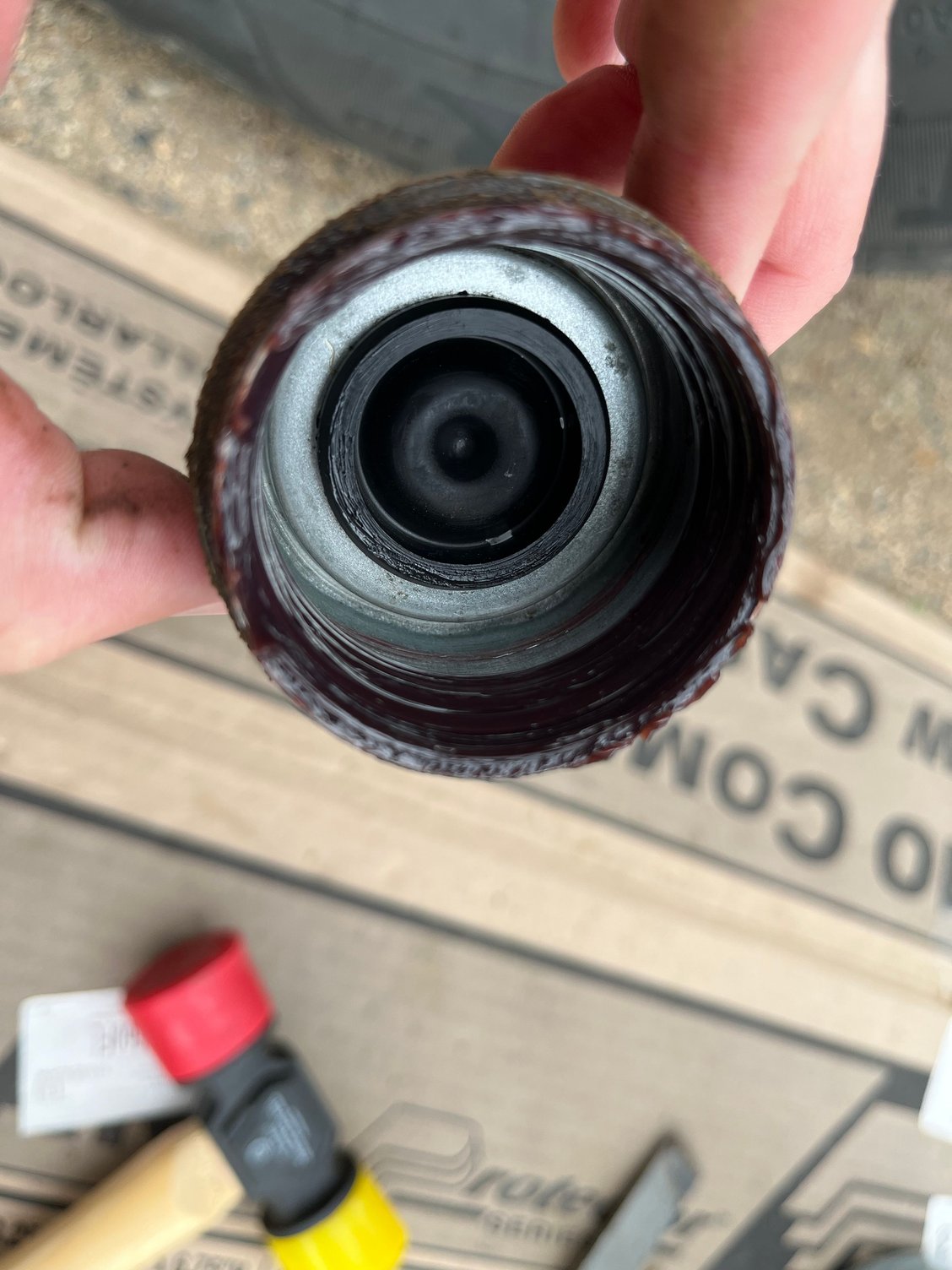

Well, for what it’s worth …. I’ve done many caps without it and I will never do another one without.
Often times the new caps are slightly oversized and are very hard to get started. Then by the time you get it installed it looks an awful lot like the cap you just took off - all dented and misshaped. This thing put the cap on straight and was slicker than snot on a snail.
much like having a race tool for your bearings. You can absolutely install them without the tool, but once you have the tool … again, I’ll never install a set of races without it.

Oh man, you guys are brilliant! I ran with your idea and headed over to AutoZone to pickup an adapter but the muffler section. This adapter fit right on the lip of the dust cap and a couple of taps with my 3 lb. hammer and whatta you know, it seated properly. I had tried to use a piece of wood but it dented the cap and I stopped. Then I just happened upon this thread...Whoop! Whoop! You da Man!
