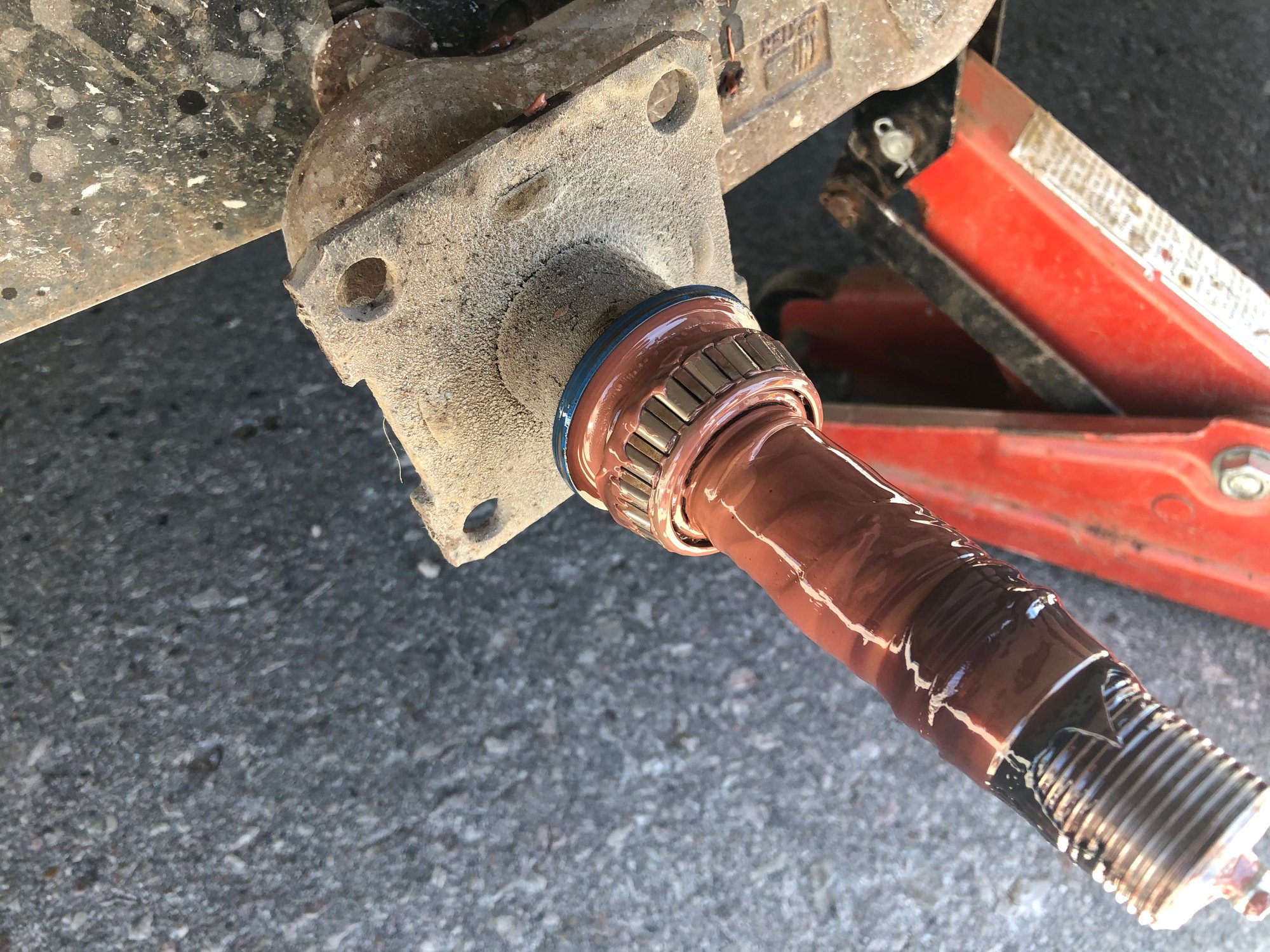

this was my last seal failure. Notice how the inner bearing and seal are stuck to the spindle. Somehow the seal seized to the spindle and the hub was spinning around the seal. When I pulled the hub, things how it came off. Roadside repair was a new seal and fresh grease. This was the one the failed in the rain, but with the hub full of grease the bearings survived. These bearings are still in service and probably have 5,000 miles on them since this happened. So to me, having the hub full is important. Without the extra grease this would likely have ended much differently given the distances driven.

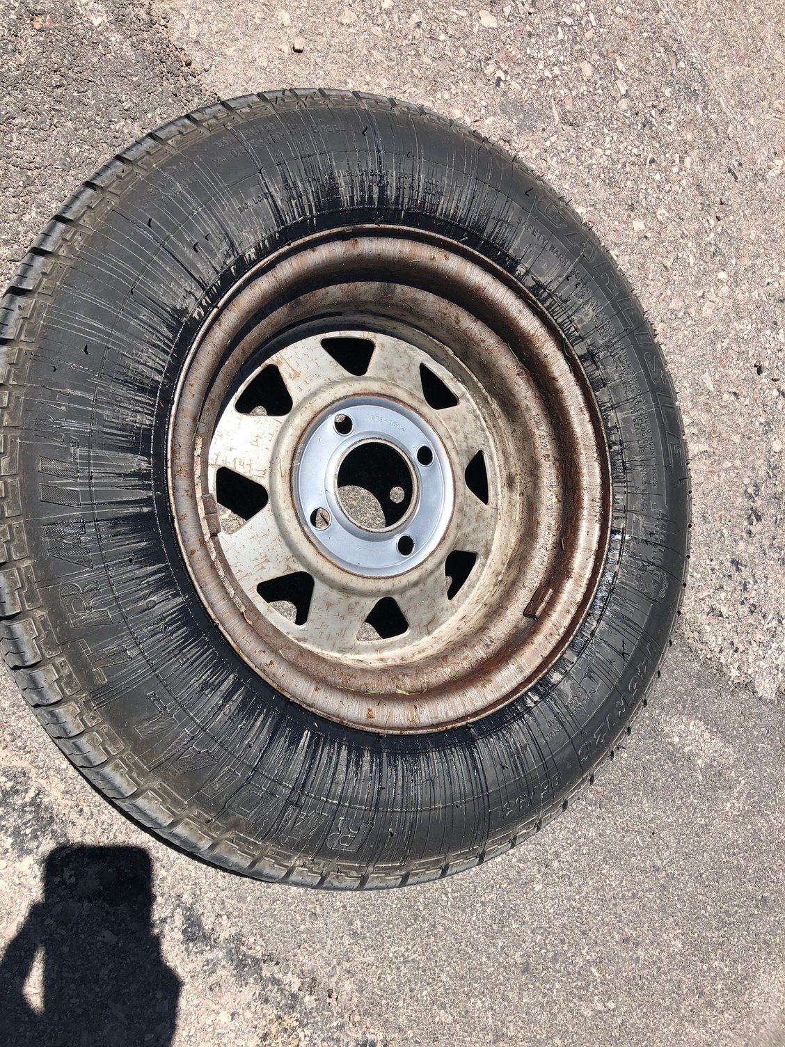

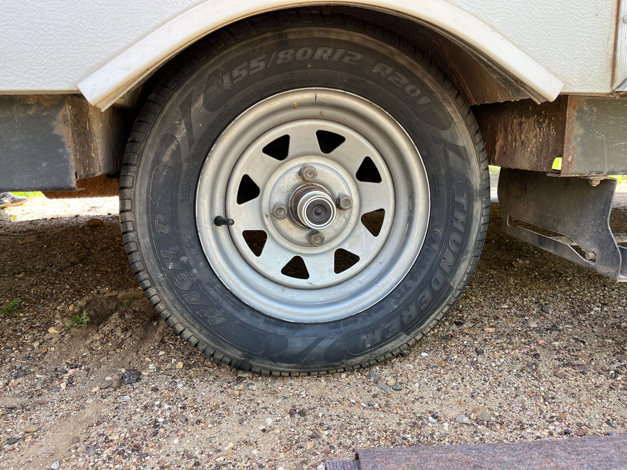

Also, for anyone wondering my “thunderer” car tire got me back to rapid city. Put about 500 miles on the car tire at 70 mph to make it back in one day.
not ideal but it survived. It did run slightly warmer than the dedicated trailer tire on the other side but not enough to worry about. It did seem to bounce more on that side of the camper too. I’m thinking that tire was just softer allowing more sidewall flex and bounce. I’m sure it was over its 910 lbs rating but it held up just fine.
I now have two brand new carlstar 145r12 E tires (formerly Carlisle) that will carry me for many more years and adventures. Still surprised and disappointed by the sudden failure of the last ones, but I really do think it was the road they did it.
regardless, we are in good shape for the final 350 mile stretch back home.

empirically, I say no. If the hub being full was the cause of the seal failure, I’d be having a lot more problems.
the first seal failure was the membrane just ripped. As far as i know, that seal was over 10 years old because I never pulled the hubs, just kept flushing them with the easy lube. Lesson learned.
the second failure defies explanation. What set of circumstances cause the hub to spin around the seal? If you look at that picture you can see the metal interface for the seal is blue from heat. The rubber was perfectly intact, but was somehow stuck to the spindle and the grease was leaking out of the metal/metal interface. Adding to the mystery is the fact that the new seal I installed in the Napa parking lot went in tight and saw 2 years of service before I pulled everything down.
before we went to Utah, I installed new name brand seals and put them in with some sleeve retainer. I may curse myself later for that, but I haven’t pulled the seals since I did. That was in 2023. Cross that bridge in a couple years I suppose.
loosing two tires at once takes the cake so far…. I was only 50% prepared for that.

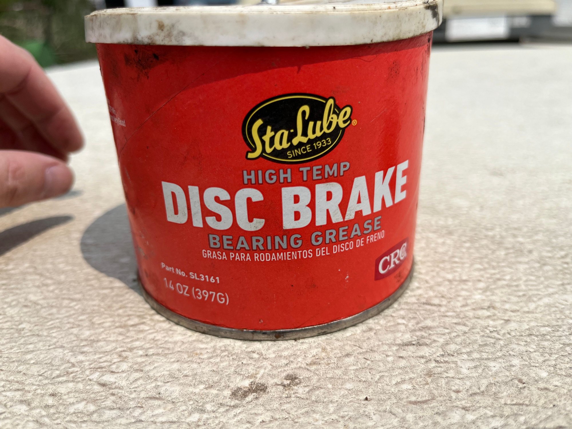

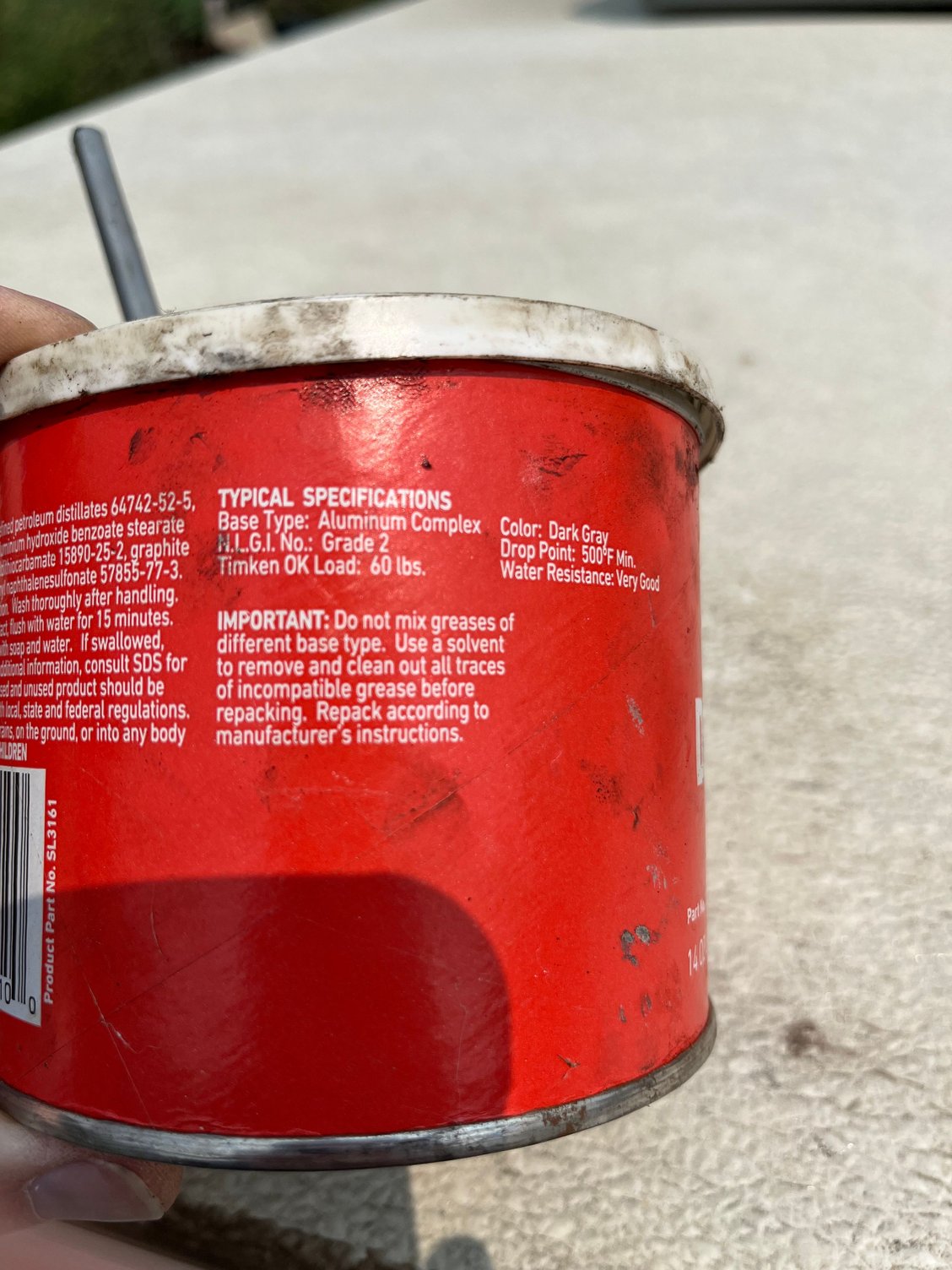

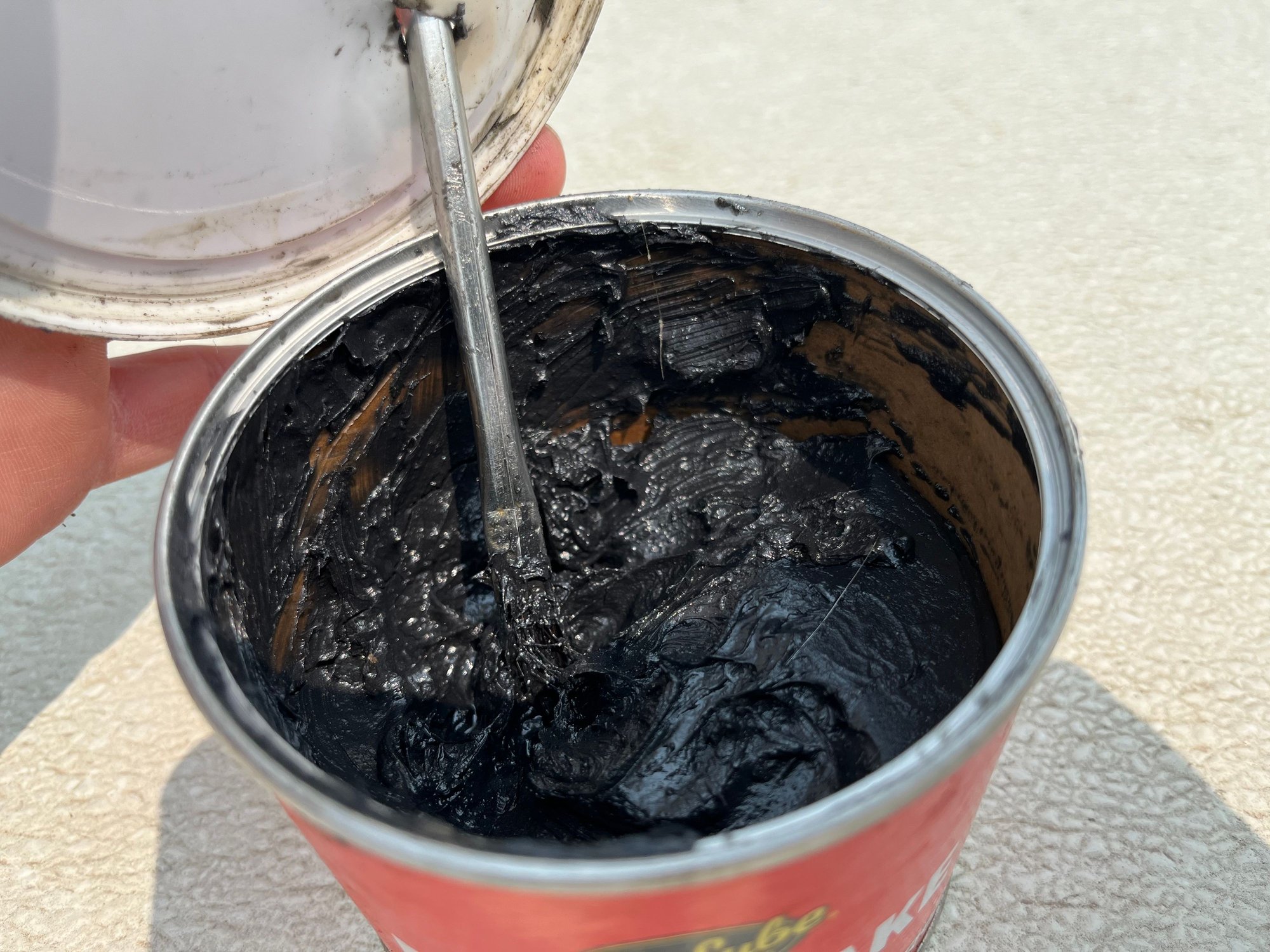

Here’s the inside of the cap I removed (and just threw away). This is all the extra grease that comes past the front bearing during its first time running. It is anything but excessive IMO.
when I had to do the bearing in the NAPA parking lot when the seal failed somewhere in Wyoming, this was the grease I used. It was what they had on the shelf so I got it. I just packed them by hand and scooped the hub as full as I could and reassembled. Ran it two years with this grease. No problems with it, but it is an aluminum complex not a lithium complex so there could be compatibility issues if you don’t get them 100% clean.
I think the CRC grease is what Dave is talking about. No issues with using it other than I prefer to use the easy lube. I will say, though, the bearings ran 10-15 degrees hotter with the CRC grease than they did with the Mystik or Valvoline. Is it a big deal, not really. But it was measurable and repeatable and consistent.
which grease is better? You decide for you.
interesting take on the Citgo products. That’s stuff I dont normally look into. I may weigh that into future purchases. The Mystik is just what they sell locally at the farm stores, so that’s what I got. Thanks for pointing out the other side of it though. It’s interesting and worth considering.
to the thicker is better part of the conversation, I fall on the other side. Generally for a bearing, the thinner grease will flow better and if it will hold up to the heat of service, that has its advantages. If you are using a super high temperature grease and the bearings never get up into the optimal operating range for that grease, it will never flow and can wear out because it never gets replenished. That was why I initially switched to the crimson. I didn’t need the high temperature grease so I went for just a standard temperature offering. It was definitely thinner and in the heat it definitely flowed more than the high temperature stuff.
but looking back, I’ve not had any of them fail so I don’t think it matters much in practice. So it’s kind of a “use what you like” so long as it’s a #2 grease it will be fine. #1 is not the appropriate spec as it would likely not hold up to the pressure.

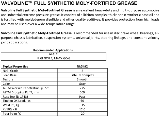

I'm using Valvoline Full Synthetic Moly-Fortified Gray Grease, which is an NLGI #2 GC-LB lithium complex EP grease. It's NOT on Dexter's list. I think I settled on this grease because it was OK for use in my F-350 and it also has the NLGI #2 feature.
The Valvoline Durablend - that is on the list - appears to be discontinued. The Durablend is Moly-fortified, as is one of the approved greases from ChevronTexaxo.
This is the description of the Valvoline grease I'm using. I'm providing this only to show that they say it's recommended for bearings.

That valvoline full synthetic is good stuff. It is one of the few greased that is approved for use in a CV axle.
we used that when we did the rear wheel bearings on my buddy’s c3 corvette. If you know anything about doing rear bearings on that car, you want to use the best grease you can because it is not a trivial task.
I also used it on my CV axle in my Subaru when it lost a boot clamp and slung the grease out. I measured 4 fluid ounces and packed it in the joint before replacing the clamp (twice)
good stuff! I’d use it on the trailers but they don’t get used that hard to require such an expensive grease.
