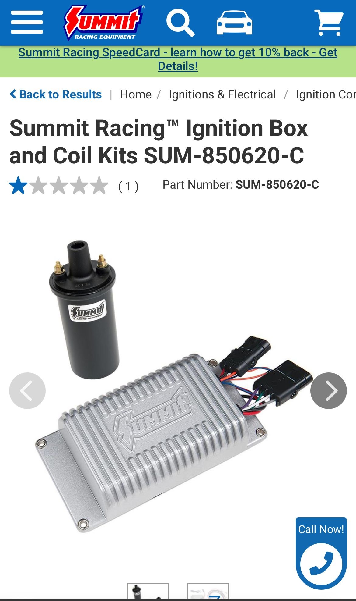

Originally Posted by Renegade212
I've heard from others, opening up the rev limiter is huge on these motors as long as you don't go past low 5s. Did your truck have a 370? Of so do you know what ignition you used? Everything says 385 series 429/460 and I hate to assume. It's a fairly light single axle truck with a light short box so the power is fine, just need some better response and higher rs.
I did have the 370. Here’s the ignition box I used:
I sincerely appreciate you providing the part # and picture.
