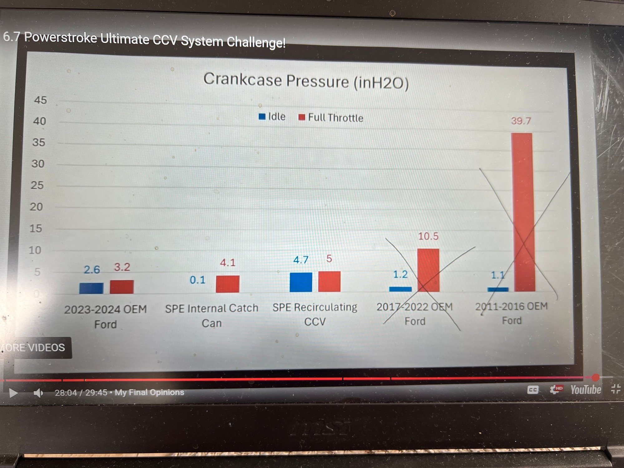

you should replace with the latest ford ccv return to intake box
the new ccv box is a lot thinner and easier to install
the picture tells it all

There are a couple of threads lately talking about this, just scroll down through the threads a little. In your case, I would either swap it with one of the most current Ford OEM CCV's, or do a reroute. I myself have been debating this for the past couple of weeks and decided to take advantage of the 10% off code at SPE MOTORSPORTS (important: not SPE Labs) and opted for their CCV reroute without the internal catch can, and then I also added their external catch can. With the code this was $520, so not the least expensive option at all. In fact, this is the most expensive option I have come across...
And.... I am still not sure if I made the best decision... I really don't want to see "smoke" coming from under my truck, and while I don't think that I will care about the smell, this is also hanging on to how much smell will their actually be. I don't really want either to be a nuisance, or to draw attention... I have read so may threads lately, and watched many YT videos... it seems the amount of smoke and smell will differ from truck to truck, as well as installation to installation... so there will be no way for me to know for sure until I hook it all up. I did not add the internal catch can because I want to minimize blockages to flow/pressure, and instead opted for the external catch can. I hope that this will be sufficient in catching and the smell and minimizing vapors... I guess I will eventually see!
The only way to completely not worry about either is to keep the CCV recirculating. SPE Motorsports also have a nice looking CCV Recirculating kit, however, it lacks a "crank case depression regulator" and based on my limited, non expertise opinion, I don't like this. Had they added this to their recirculating kit, I would have 100% went with this option, and I wouldn't be second guessing my final decision while waiting for the parts to come in... If you want to keep the CCV recirculating, the newest FORD OEM CCV is the best option, however, it is not a one and done thing... depending on use and your motors health, it can deteriorate in either a short, or long amount of time. There is no good way to tell. Also, FWIW, another user here showed his new OEM CCV leaking oil soon after installing it... so... yeah...
Besides this, there is a proper way to se up a CCV reroute, otherwise, this can actually increase CC pressures, which would make things just as bad, if not worse than having a clogged OEM filter. As well, there is some discussion as to whether or not the whole intact system benefits from the negative pressure created from the turbo as to whether or not it helps remove some CC pressure (obviously with a non clogged filter). Then, there are even some that believe that removing the CCV and rerouting it to atmosphere/catch can/exhaust will actually wear out the seals in the turbo... I am no expert, so I can't say for sure... but all of these things get talked about and there seems to be very little scientific data to back up any of the claims. Just a lot of "use-based data."
Anyway, here's probably the best video on the subject that will get you going down the rabbit hole! Good luck!
Does this graphic include the "non filter" OEM box that was replaced on my 2015 under a previous recall?
