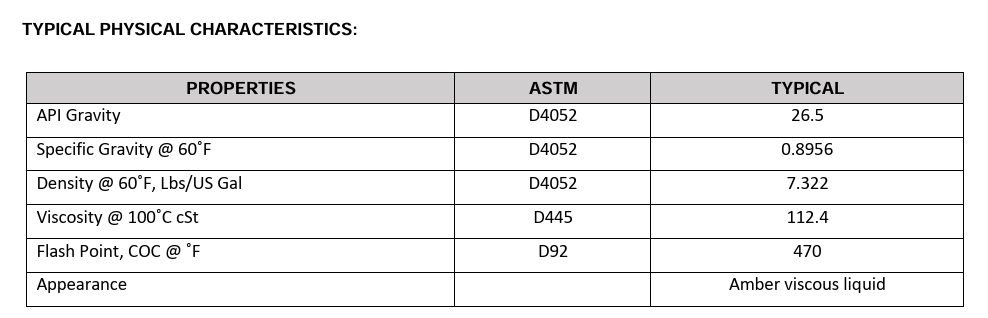

On the next oil change I would skip the Lucas.... that stuff is crap. Nothing but super heavy basestocks with nothing in the additive package:
A complete scam.
