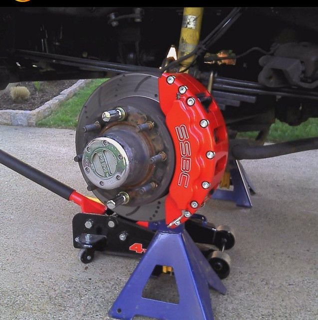

Ive got a set of the SSBC 8 Piston calipers on my rig. Im using EBC pads. Not sure of model/ type. This brake system was already on when I bought it. So I have no experience on what the stock brake system feels like. Ive had other full sized SUV's. These SSBC's work great though. Ive put them thru my own test in an attempt to familiarize myself with how much mass Im movin around when driving it. There's a street which has Id say 30-40 degrees of slope to it when entering the neighborhood where I live. Its about a city block in length. Ive come down it a good 30-35mph several times when there's no cars in front of me, and smashed on the brake pedal to see just how effective a $2K big caliper brake system is on a huge SUV. I dont have numbers for you but I will say they work very well if you need them. I'd say these are definitely worth the investment.

I have the SSBC V8s on my rear axles and Russell Braided Stainless all the way around. Big improvement over stock. The biggest performance increase in my opinion is the increased reliability of the pistons and slide pins. Having more smaller pistons and a quality machined made in America brake kit as opposed to a reman means greater reliability. This solved my original issue of the rear pistons getting cocked sideways in the bore and dragging, even after multiple resets. Each brake piston is responsible for less braking force since there are 4x as many over stock. This translates to less wear on each piston, which should increase the serviceable life of the pistons/caliper. I do not tow so I cannot speak to hauling heavy loads but SSBC does fine in highway/street applications. I absolutely plan to put them on the front and I expect even better performance than what I have now. They are definitely pricey, but the way I see it is; buy once, cry once. Besides our 20+ year old trucks need the TLC invested in them to keep them on the road. It is simply the price that is required to maintain/upgrade our Exs. Still cheaper than buying a new 3/4 ton truck.
