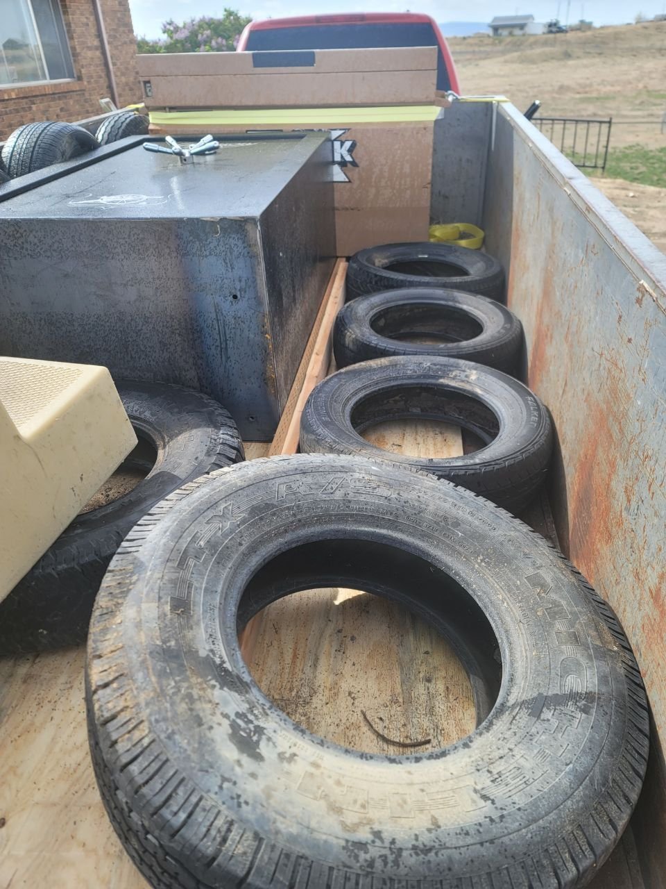

this is an 800 lb gun safe in a Big Tex dump trailer, the specs on the trailer say it is close to 5,000 lbs empty
the tires are to keep the safe from sliding around, the toolbox has some stuff in it also
