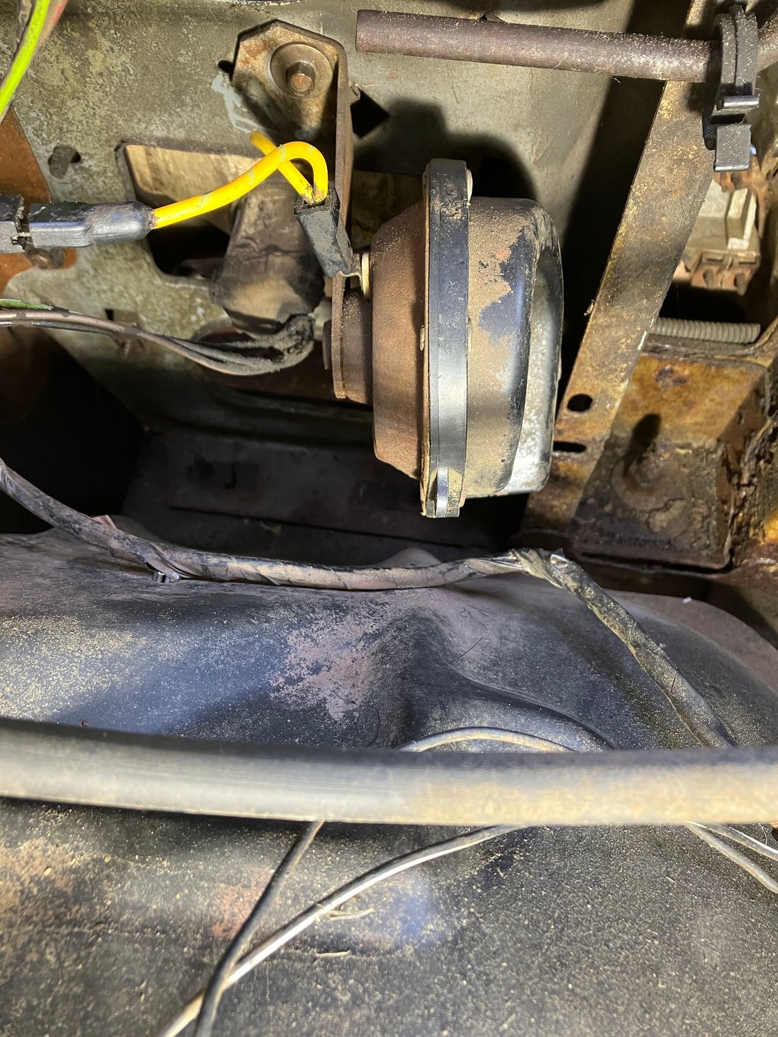

After putting up with not very loud horns, for a long time, and reading around the web and finding something about turning the screw on the side of the horn 1/2 to 3/4 turn. Today I finally decided it was time to look at the muffled horns.
I took both horns off, after spraying the bolts with fluid, then sprayed the Phillips head screws, after a few minutes I turned both screws about 3/4 turn out, put one horn back in the truck. Boy was I surprised when it sounded normal. Both back in and they sound like real horns now.
I think it was one of the Dave's that mentioned doing that.
That was easy.

I should go out and get a picture, so others can see the screw, It really is an easy fix. It's stopped raining again, I'll go snap a photo.
First is the horn behind the driver's side headlight, second pic is the one behind the bump, that shows the screw.

You can also turn the screw while the horn is make noise, if you are looking for a certain pitch. If you have 2 horns, try for a blend of different tones.
