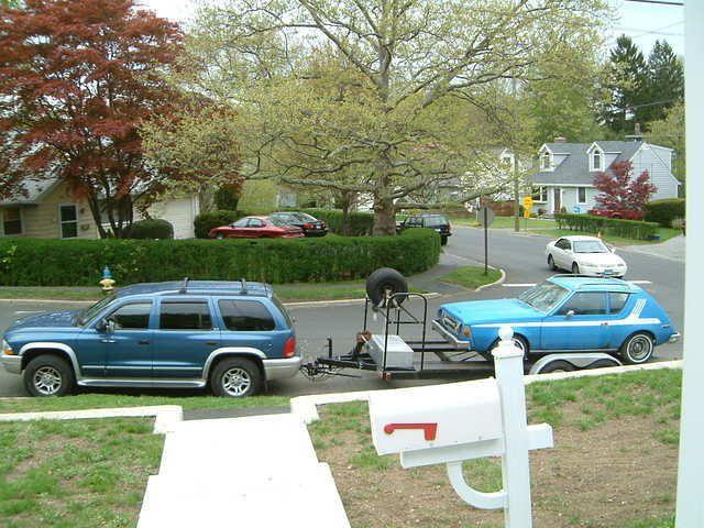

Before the wheel straps came into play all new car haulers had hooks that fit into holes or slots in the frame and they would "squat" the suspension.
Now my thinking is vary few cars, SUV's and some light truck have frames so putting the hooks in a hole / slot could bend and pull out.
You also had to squat the suspension because of the loading and unloading the chains could come out and not the load is loose = not good!
Now if your trailer, like mine, dose not have the tie downs, E-Track?, for the tires how do you use the tire straps?
If you only hauled 1 thing, say race car, once you knew where it sits on the trailer you could add tire tie downs but then if you haul something else and it dose not sit in the same place then what?
I have hauled a lot of different cars, SUV's, pickup's and even a van on my trailer and never had a problem with straps to the rear axle and front cross member or A arms.
I use axle straps, they are short straps with 2 loops and a cover over the strap to protect it, that you hook the ratchet strap to and the other end to a D link on the trailer.
I cross (X) the rear straps so the rear cant move side to side, yes before I did tis I has a small light car shift on the bed, open center bed.
The front is just straight on as the weight of the motor has kept the front from moving. I also squat the front suspension when on the front / motor cross member.
CT to OH & back more than once for racing
Not this car but another one I have, CT to NJ or MD and back many times for racing but you can see they sit different on the trailer.
I hauled the race car above, the other Gremlin not pictured and a 2nd Javelin, like the race car from CT to NC when I moved without issues.
Just my .02

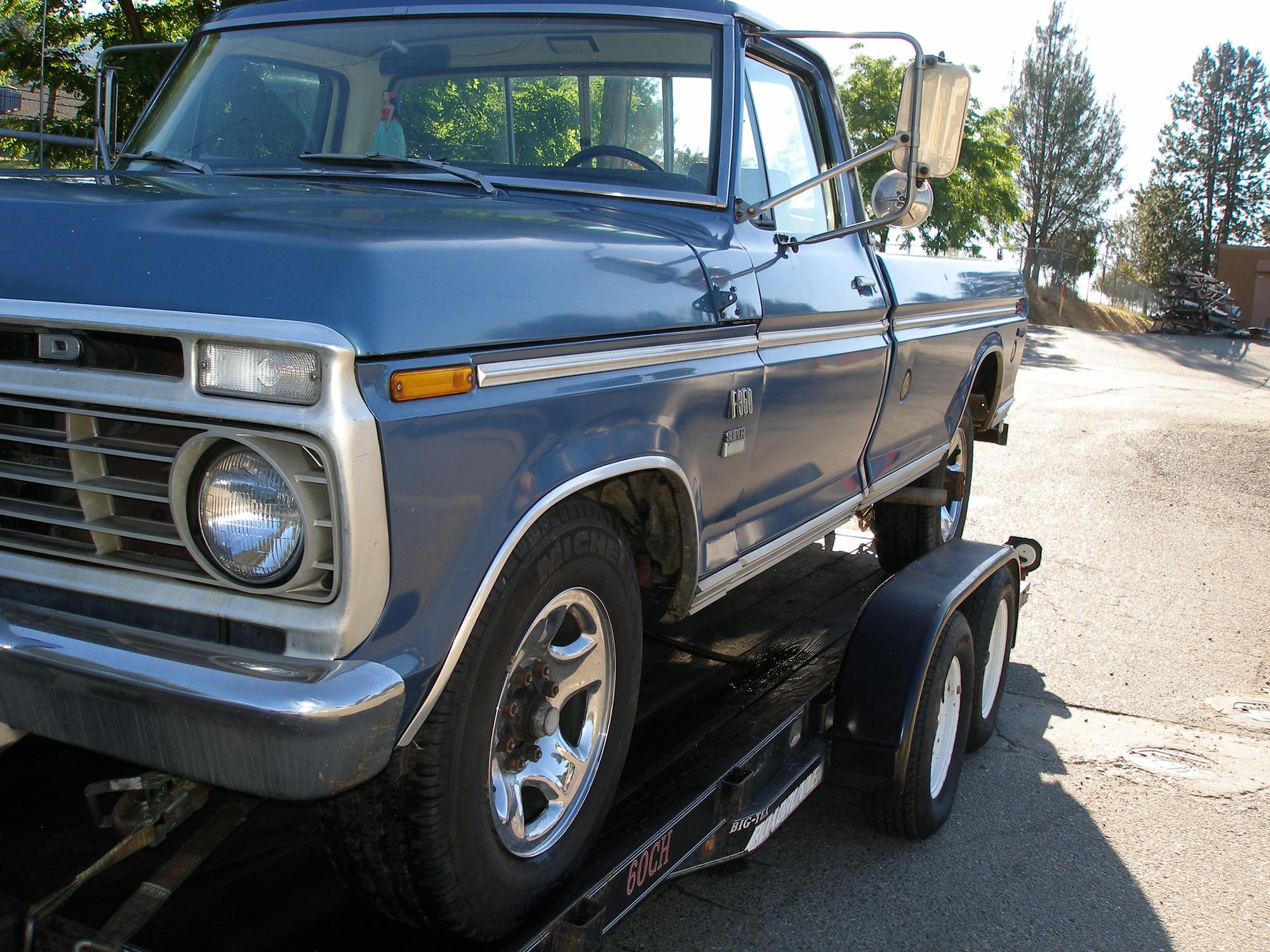

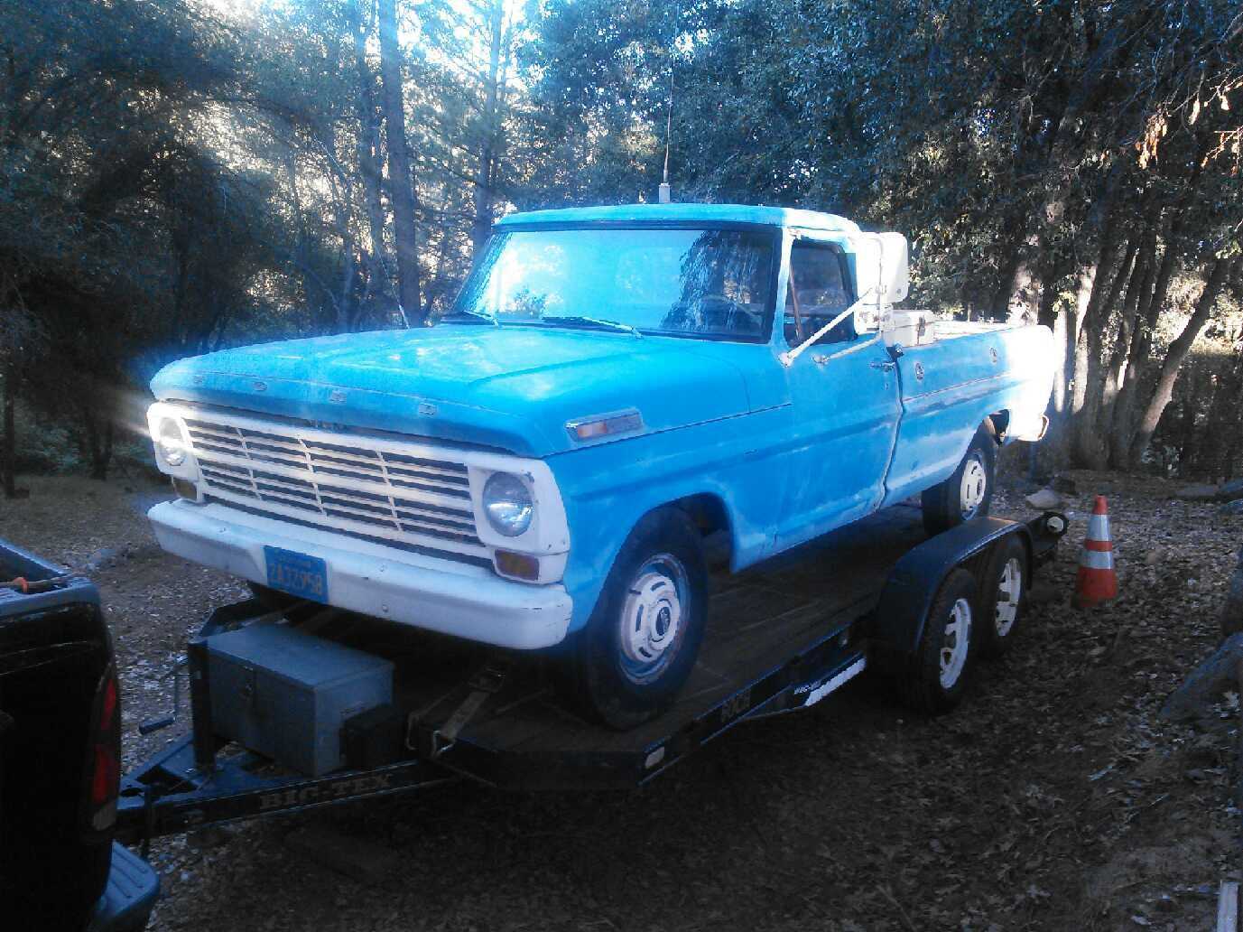

Having been towing, trailering and recovering cars/trucks/equipment and what not since appx 1986, USMC 3523, Vehicle Recovery Mechanic, 1986-1992, the securing method does change depending on what it is...
Say a tank, or HE of some sort, skid-steer etc.., chains and binders and and dog it down tight, then I usually stopped maybe 30 mins/50 miles in and checked everything, and as Fuzzface said, then at gas stops or piddle breaks, and make sure everything is still how it should be.
For cars/trucks back in '93 when I drove a tow-truck in OC, they had the chains with the T-hooks and the J-hooks, I never liked doing it that way, as you had to put some healthy force on the chains to settle the suspension down as ****-sideways stated. And yes, there were some coked up dudes I ran across in the towing business... had to fire 2 because of it, drugs and doing tows on the side when they were allowed to drive the trucks home. 🤦‍♂️
I've had my Big Tex flatbed since like 96/97 and have hauled over 50 (at minimum) trucks/cars and I have used the nylon ratchet straps with zero/nada/zilch failures, on my trucks in the front I go over the I-beam or axle if 4x, and back towards the ratchet to another tie-down point close to it. On the rear, same thing, over rear axle back towards ratchet, I try to go as far out towards the wheels as I can. Seems about 10-12 yrs ago or so, the big thing became guys crossing the straps, R side of vehicle to L side of trailer and vice-versa. I've just stuck with 4 straps straight, 2 up front, 2 in the rear, never had one loosen or fall off.
Funny I saw this post, this weekend I was just pondering buying some of the wheel net types for my trailer to see how I liked them since a couple of my straps are due to be rplc'd soon, I haven't experienced any of them bouncing excessively and causing issues, so I can't see a huge difference in going to the wheel net straps...
