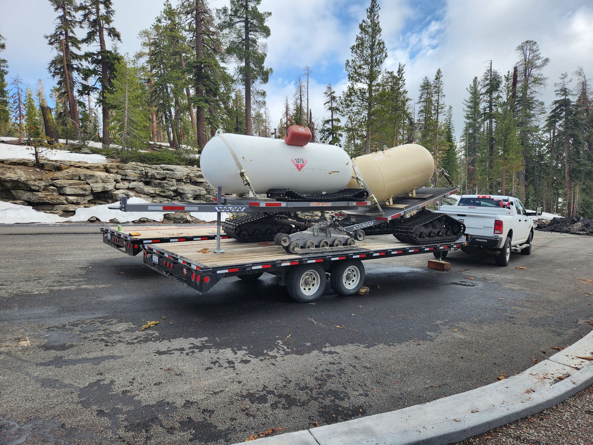

I did have one issue, not with a truck or car, but with our tracked trailer we tow behind the Sno-cat, the trip on the 99 S of Sac was just brutal, and we strap around the trailer frame as there is only one axle. Adding to it, is the trailers purchased to put the tracked trailers on is a heavy duty one, way overkill since the tracked trailer and 500 gal propane tank are ~2000 #'s, the flatbed trailer is basically running empty and bounces harshly really unsettling the tracked trailer, enough so that one of the straps came off, luckily I check my mirrors quite often, especially after a harsh stretch of pavement, and saw the strap loose.
This was when we dbl'd them up on a trailer for a short trip to remove the tanks, the trailer tows the same, you barely notice the the extra bit of weight.

You may do this already, but lowering the tire pressure from the MAX recommended can help a lot. If they are top tier tires you should be able to find a chart that shows the load capacity at various pressures and adjust accordingly. If it were a company trailer used for all kinds of things that could be dangerous, but it sounds like it's dedicated for this one purpose so it should be pretty safe. A tag/label at the coupler stating "Tires at pressure for X load, adjust as necessary" or similar might still be a good idea.

Thanks, did that, since they are dedicated for transporting these trailers, and we're the only ones towing them, did that after I had the one come loose, when I stopped for fuel I dropped them down to 55, smoothed it out a bit.

Looks like 5,400 pound axles there. It will probably ride rough if lightly loaded until you remove leaves from the springs.
