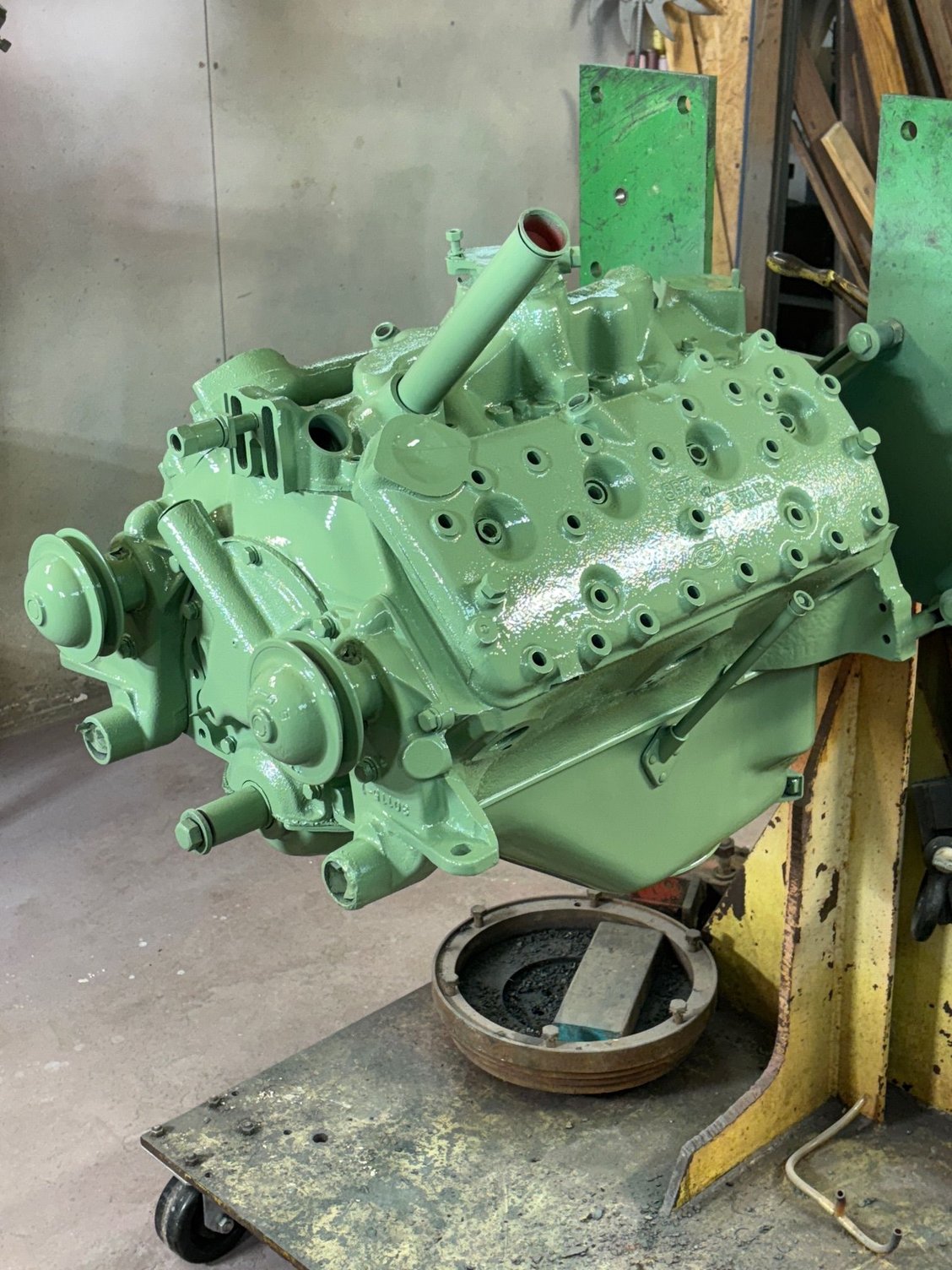

I have finished my rebuild, including paint, etc. We assembled the valves and pulled the original adjustable lifters out of the box we sent everything to the machine shop in and they were not machined, so we called the shop and they said, "Oh, we can't machine those lifters, they are convex and require a special machine." Nice to know after they take the job!
I have since called all over the US for someone to machine them and have a guy from Arnold Motor Supply that knows a guy that claims he can get new ones.
Does anyone have a machine shop source (preferred) or source for new ones?
Also, here is the engine, painted on the stand, waiting for lifters so I can do valve lash / clearance and reinstall in my truck.
