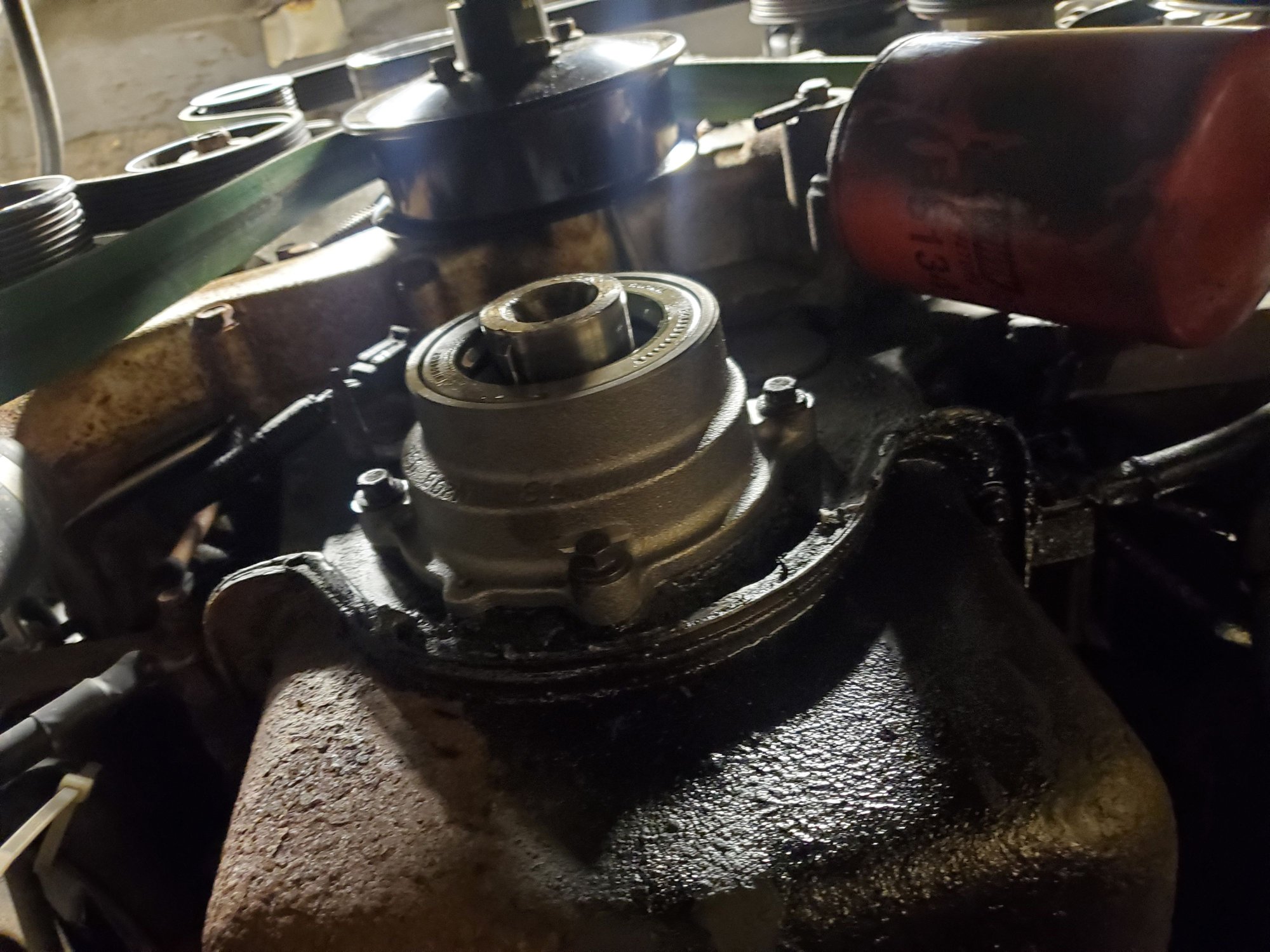

For what it's worth I have the International style pump with the filter on it. Had it for years. Decent shot of it here when I just replaced the oil pump. It's a much cleaner install then adding more hoses and brackets as mentioned.
I like the idea of this pump. Do you know if this pump has an external port on it like the stock pump does? The supply port used for the external filter system.
