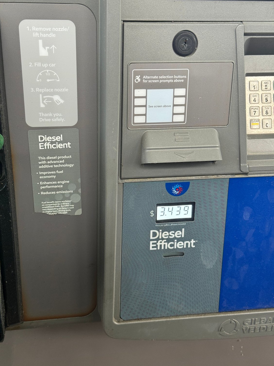

I stopped at Speedway truck stop a long I-75 in Brichrun, Michigan to fuel up. I noticed while fueling my truck that it was bio-diesel I was putting in the tank. I have owned diesels trucks for a long time and never paid much attention to the fuel I was putting in, but after reading this forum, after buying a new Ford f-350 I have been more concerned with the fuel I am adding. I guess the question I have is, is it OK to use bio-diesel or am I better off looking for a better grade of fuel. I have been using 16 ounces of Power Services Diesel Kleen on every fill up

I don’t see anything in that picture indicating bio fuel and would be surprised if “speedway” had it.

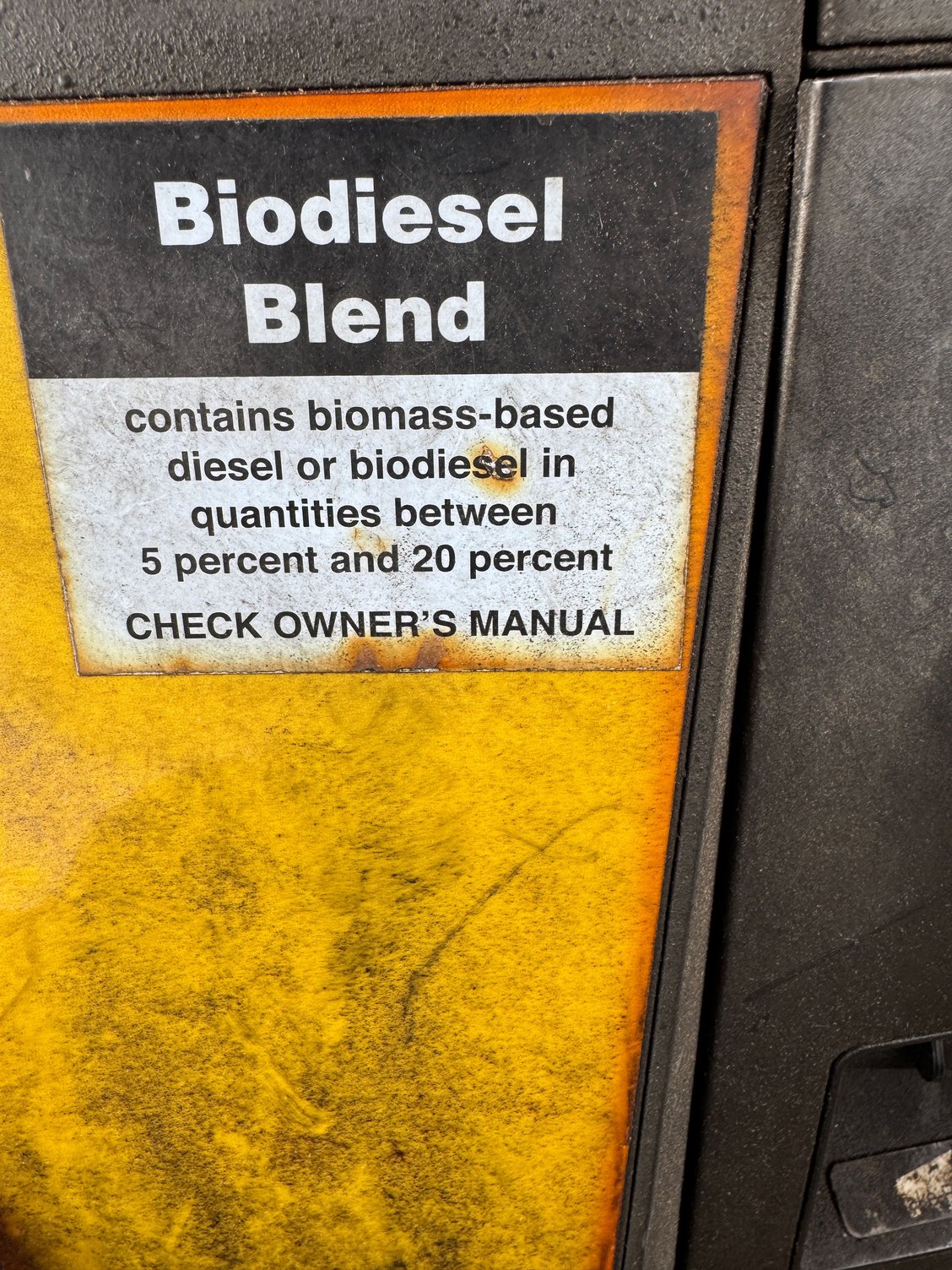

There were 2 pictures I took today during fill up. This is the second one.

Just found this article from 2013 about biodiesel labeling at the pump.
From there;
"The Federal Trade Commission (FTC) regulates pump labeling within four categories; B1-B5, B6-B20, B20+ and B100. FTC biodiesel pump labels are blue in color. Orange labels denote the broader category of biomass-based diesel which could also include renewable diesel."
Another article here.
From there:
"Biodiesel, Biomass-Based Diesel, and Their Blends
Labels for biodiesel and biomass-based diesel and their blends must be printed in black on a light blue background.
For biodiesel blends above 5%, but no more than 20%, the label must disclose the percentage volume of biodiesel followed by the term “Biodiesel Blend,” for example, “B-20 Biodiesel Blend,” or simply state “Biodiesel Blend.” Either way, the label also must state “contains biomass-based diesel or biodiesel in quantities between 5 and 20%.”
For biodiesel blends above 20%, the label must disclose the percentage volume of biodiesel followed by the term “Biodiesel Blend,” for example, “B-70 Biodiesel Blend.” The label also must state “contains more than 20% biomass-based diesel or biodiesel.”
For 100% Biodiesel, the label must state “B-100 Biodiesel” or “contains 100% biodiesel.”
For biomass-based diesel blends above 5% but no greater than 20%, the label must disclose the volume percentage of the biomass-based diesel followed by the term “Biomass-Based Diesel Blend,” for example, “20% Biomass-Based Diesel Blend,” or simply state “Biomass-Based Diesel Blend.” Either way, the label must also state “contains biomass-based diesel or biodiesel in quantities between 5 and 20%.”
For biomass-based diesel blends above 20%, the label must state the percentage volume of biomass-based diesel followed by the term “Biomass-Based Blend,” for example, “70% Biomass-Based Diesel Blend.” The label also must state “contains more than 20% biomass-based diesel or biodiesel.”
For 100% Biomass-Based Diesel Blends, the label must state “100% Biomass-Based Diesel” and “Contains 100% biomass-based diesel.”
[Note: Edited January 2024 to reflect [url=https://www.ftc.gov/news-events/news/press-releases/2024/01/ftc-publishes-inflation-adjusted-civil-penalty-amounts-2024y-asked-questions]Inflation-Adjusted Civil Penalty Maximums.]
October 2016"
So it seems the label you found is correct by the above lined FTC article. You could always go and talk to the person in charge of the fuel deliveries. I regularly buy fuel at a popular carwash chain here in western New York, Delta Sonic. At least a few years back, I spoke with the female in charge of fuel for the station I go to. She stated they get fuel from two different distributors. And they were a B2 through a B5. One was a B5 IIRC. You might be able to find out how much of a blend you are buying by just asking.
