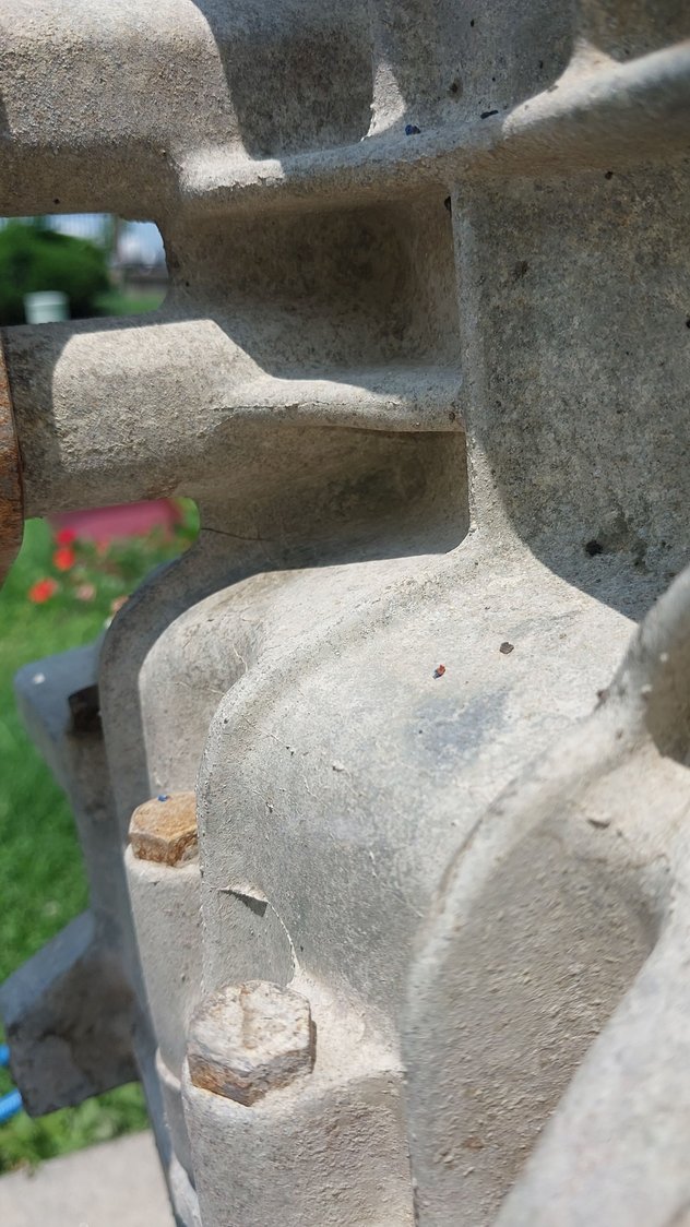

How to fix a crack??
I've taken the transmission out but I've found a crack in the rear case. Should I start looking for a new transmission case or can it be welded? I'm not trying to break the bank on this.

can be welded up usually

Find the crack and win valuable prizes? I don't see it. But it's cast aluminum and special welding procedures should be followed if you go that route. Be aware that weld zone on aluminum reduces the strength of the welded metal. Get professional advice on welding up a crack.
Maybe it's only a surface crack? Not leaking fluid? Perhaps a liquid metal application will do? JB weld or other epoxy may be better that welding and creating a heat affected zone.

I found a guy who was willing to do the repair on such a small crack. He cut into it with the grinder then filled it back in with a tig. We cleaned it and pre heated to remove any moisture. The crack hadn't gone deep enough to reach oil yet, so I feel this repair was sufficient.
It was a hairline fatigue crack on the web between the bolt hole for the tcase level and the gear casing. Still a surface crack but it was heading into the gear case. Unfortunately I'll have to live with the heat affected zone. Hopefully it doesn't reduce the surrounding strength much. The welder built up around the area to beef it up. The area didn't get crazy hot either, while uncomfortable to hold you hand close to the weld, it was not incredible hot.

Good chance the crack was a casting anomaly. If that weld is not in a high stress area you'll likely be fine.

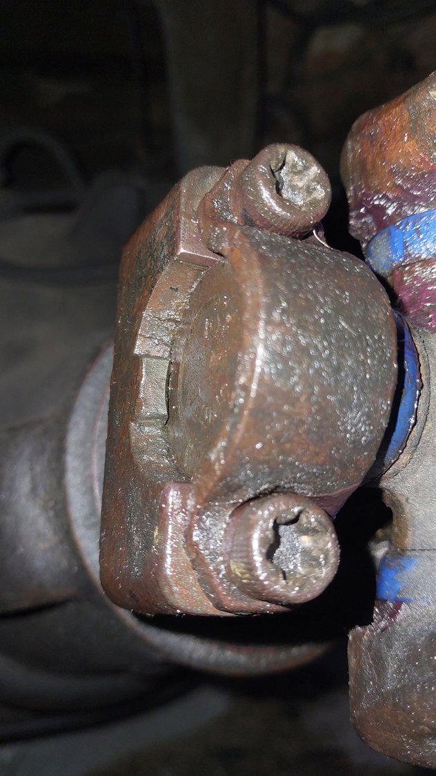

Vibration and u joints question
This thread is diverting a little from the original issue with 5th into more general drive line issues.
I got the truck reassembled, with the t case rebuilt (new bearings and seals with pump arm fix). I had clutch issue come up which is why everything was removed.
I have what I believe is a drive line vibration above 62 ishmoh (speedo is ~10-15 off). I haven't changed anything about the rear driveshaft since taking it out with the transmission. About a year ago I rebuilt it with new slicer u-joints and a new carrier bearing. I don't remember there being such a vibration before removing the transmission. I did notice two things.
1) rear u-joint at pinion is stiff and has a spot in the rotation where it hangs up just a little.
2) The u-joint caps don't fill the space on the rear yoke perfectly. There are two tabs one on each side of the pinion that holds the u joint caps in as seen in the photo. When I installed the joint it has a little play better these to tabs. Is that normal? I would think it could cause centering issues.
I plan to replace the u joint, but I'm also concerned about this yoke issue. Anyone have some input?
Old Jun 9, 2025 | 10:23 AM
knottyrope's Avatar
knottyrope
Joined: Apr 2016
Posts: 7,201
Likes: 1,340
From: Bahstun
you need a new yoke if there is space there
