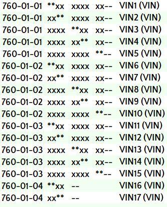

Hello, I recently purchased an 18 f350 LT. I am in the process of upgrading a couple of things. I am adding an ACM that has Sirius, as that’s all I listen to when driving. I am also upgrading the instrument cluster to a 12 inch display. I think I need the correct VIN for both of them. I have FORSCAN, but have never used it for doing that. Can someone tell me what modules to do that. I assume for the ACM it is in that module, for the cluster I am not sure.

The ABS module is one with your VIN in it. Addresses 760-01-01 through 760-01-04.
