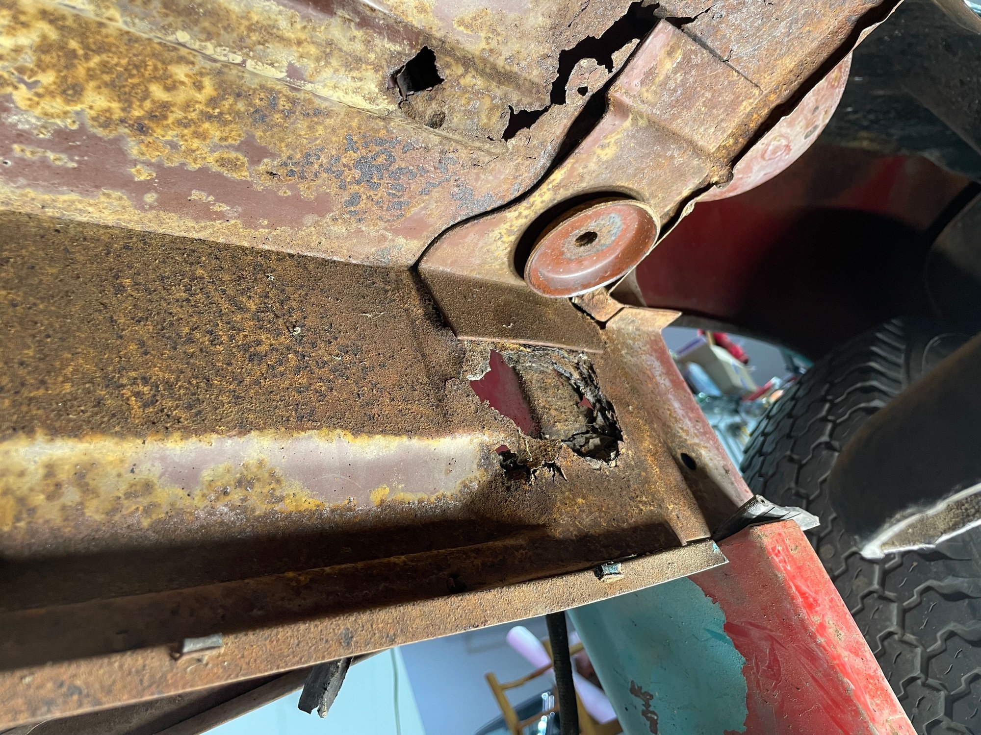

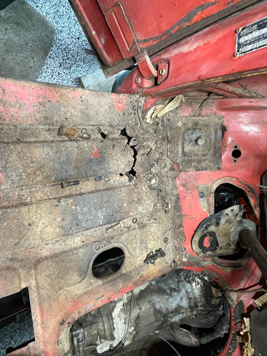

Next on my to do list is patching up driver side floor, rocker, and cab corner. Outside my wheel house of experience but going to give it gol. I started building a cart at summit but looking for recommendations from those who know.

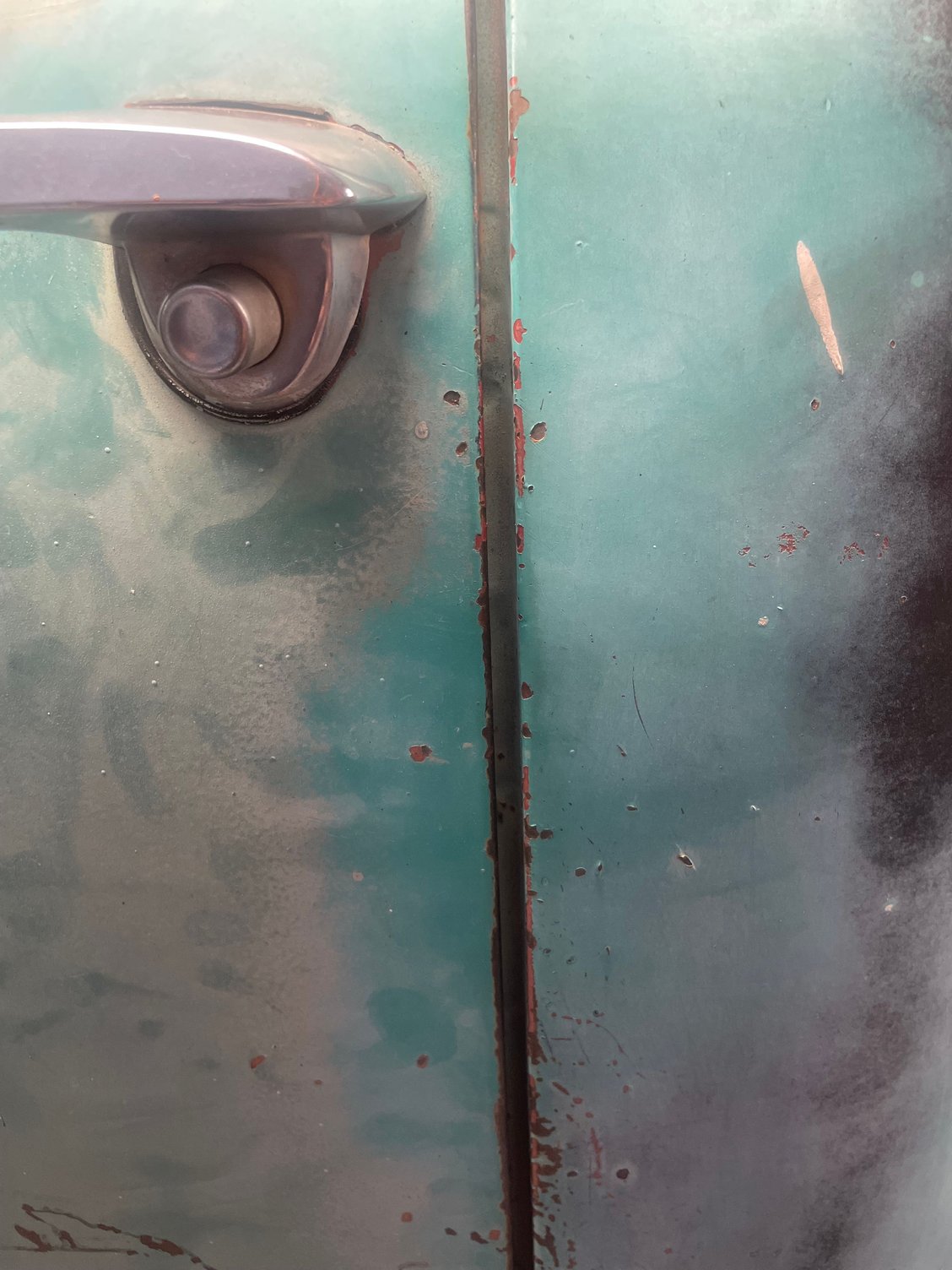

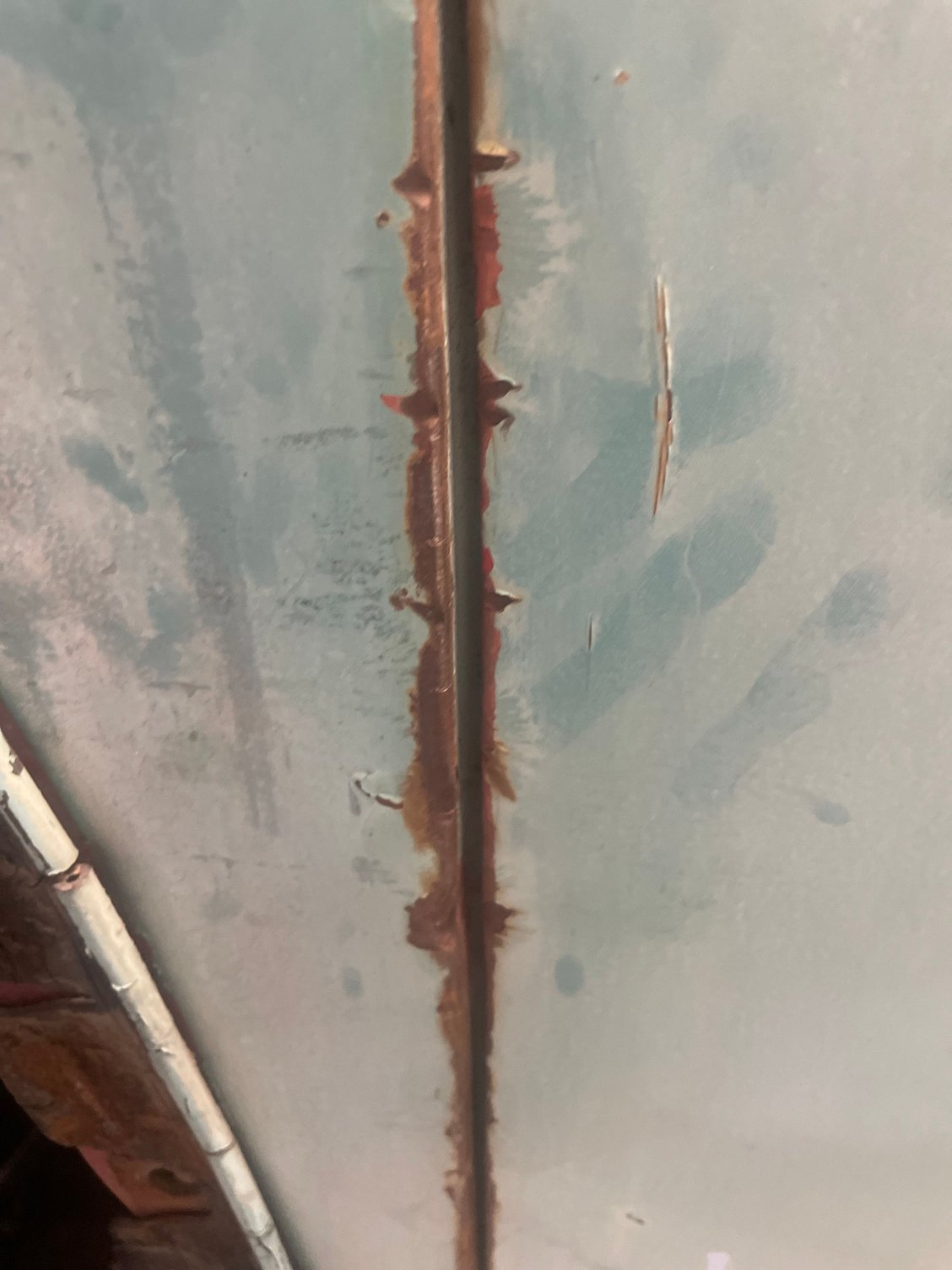

Appreciate tips! I will work on the parts sourcing this week and keep on the look out for a well priced used one. Had not considered Tig so o will need to do a little home work on the type of welding. I already have door gap issues as the leading edges are rubbing tight on the forward edges. Passenger side is a lot better rust wise as door glass was gone on the drivers when I got it but still runs hard pops when you open it.
driver side pictured this maybe getting a little ahead myself try to fits these until I fixe the drivers floor?

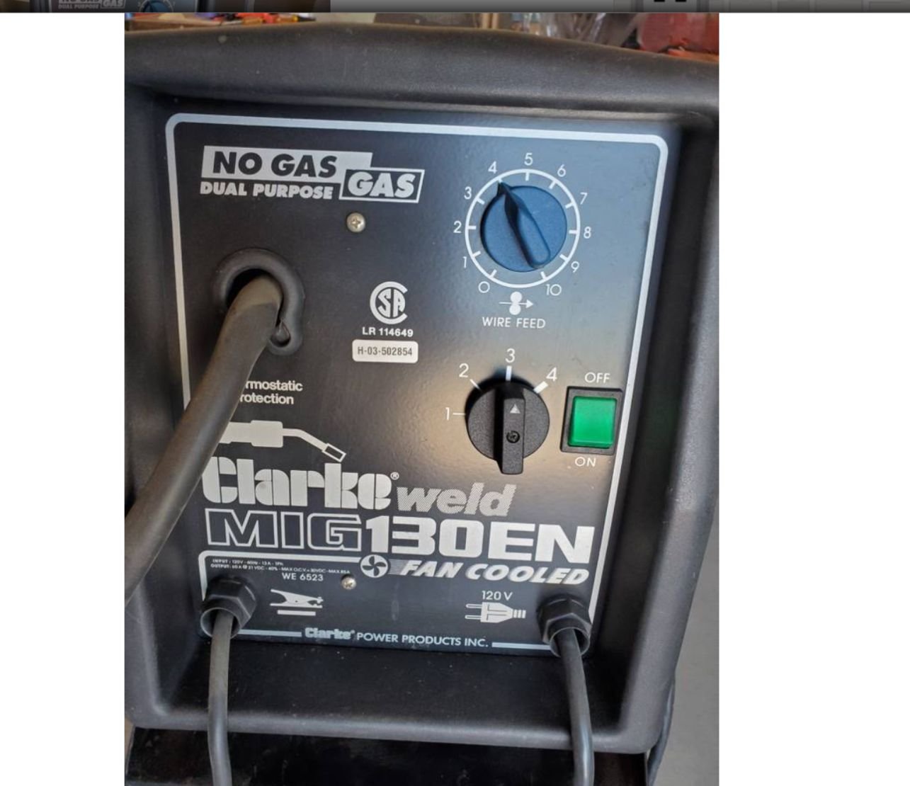

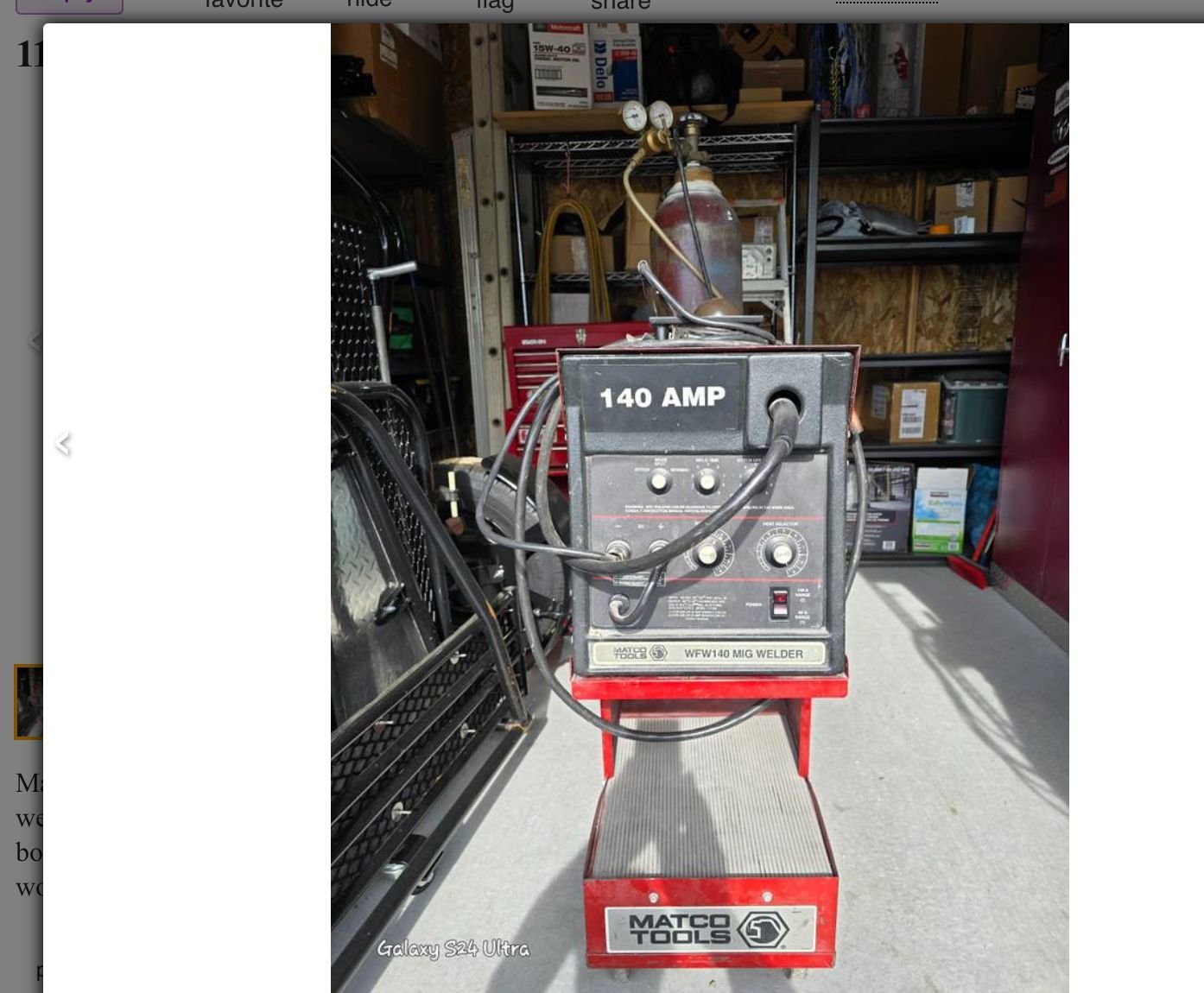

Opinions on these two welders at $450? Both come with bottles which looking at used seems to make the better deal in my minds eye.
I can't speak for the welders, as I'm not familiar with them
You do need to see if the bottles are owned or leased.
Mine, for example, belongs to American Welding Gas and I have to pay a rental fee every year. Even if I don't use it.
If they are owned, you need to find out if they can be exchanged or filled locally. Otherwise, they are of no use. Also, if owned and refilled, they will eventually need to be static tested, or they won't refill them. The test can be nearly as much as a replacement bottle.
Not intended to scare you away from them, but these are questions that need to be answered when determining if they are a good deal.

Research to see who makes welders for Matco. It's probably fine but it would be nice to know the manufacturer if you ever needed parts for it. Is there somewhere that will service it? Clarke is a good brand (afaik) but that one doesn't seem to have a lot of controls and appears to be a more basic and entry level machine. It may be fine if all you'll ever do with it is sheet metal repair, if it will power down enough, but as you get better and gain talent you may want a better machine in the future. Again, check for service and parts availability. See if either of them can be set up to use .023 wire for welding light sheet metal. If .030 is the smallest it can use, you may want to rethink it. The Matco may be more versatile. See if you can find out how many miles are on them. If one's been used hard and the other has only had light home use and only had a couple rolls of wire through it, that may be a consideration. That's my 2c.
appreciate the feedback back tips. The Matco is noted as a Lincoln/century but neither of these indicate what wire they can run.. I assumed the bottles would have been paid for and you could exchange, probably should not assume that! I will send out some questions to the Matco guy..he is significantly closer to me.
