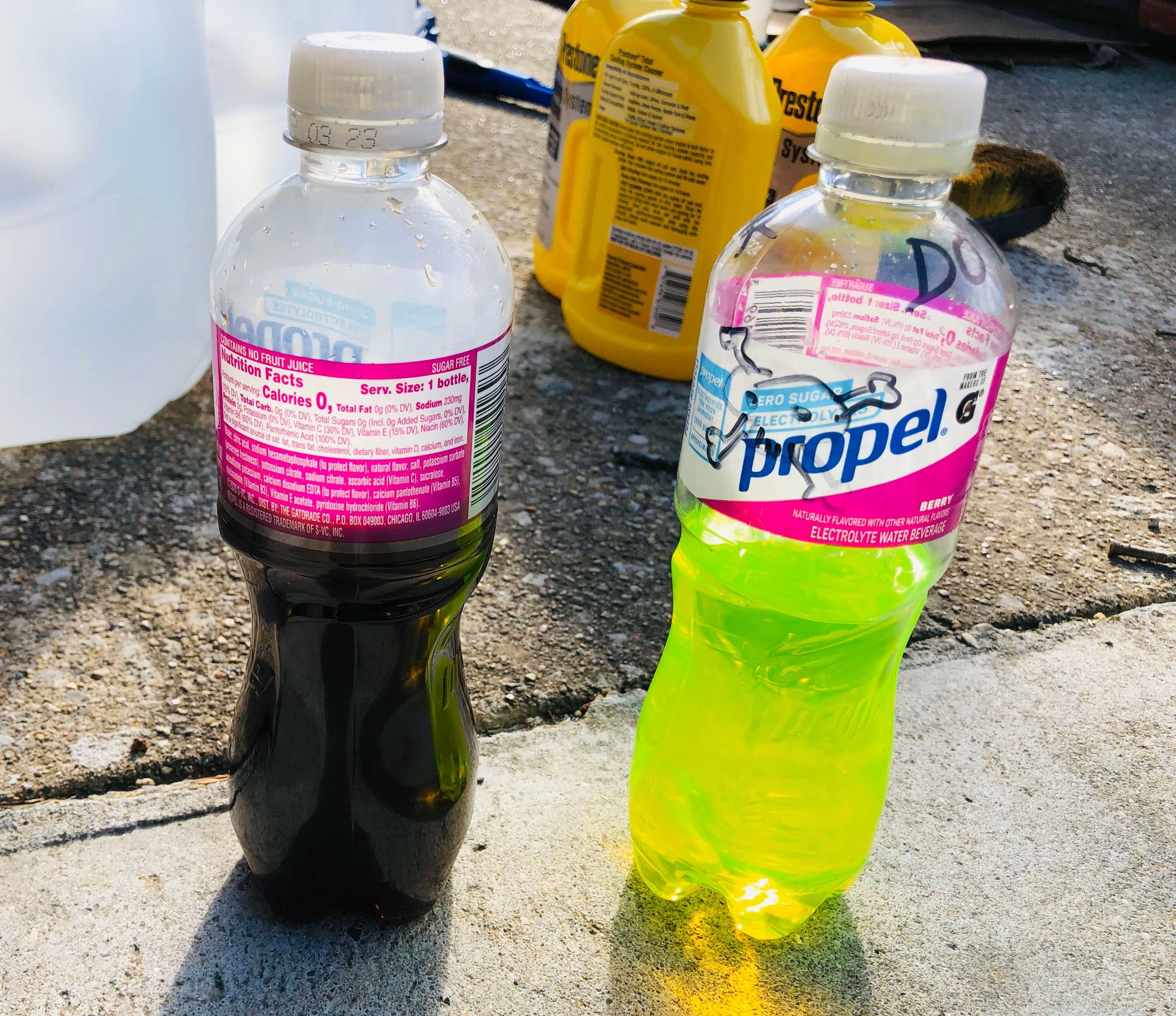

Coolant flush: 3 gallons of Prestone Universal 10 years/300,000 miles antifreeze ($39), 3 gallons distilled water ($4). I flushed the coolant following FordTechMakuloco's procedure found on Youtube. I settled on the Prestone coolant after a lot of research and talking with my mechanic because the OEM antifreeze that Ford used in 1999 is very hard to find any more. Below is a photo showing the old vs new antifreeze. Glad I didn't skip this maintenance!
Left bottle is what drained out of radiator. Right bottle is the new coolant.
Left bottle is what drained out of radiator. Right bottle is the new coolant.I'll go into more detail for the coming maintenance and repairs centering around the steering, braking, and suspension systems, spark plugs, and the exhaust.

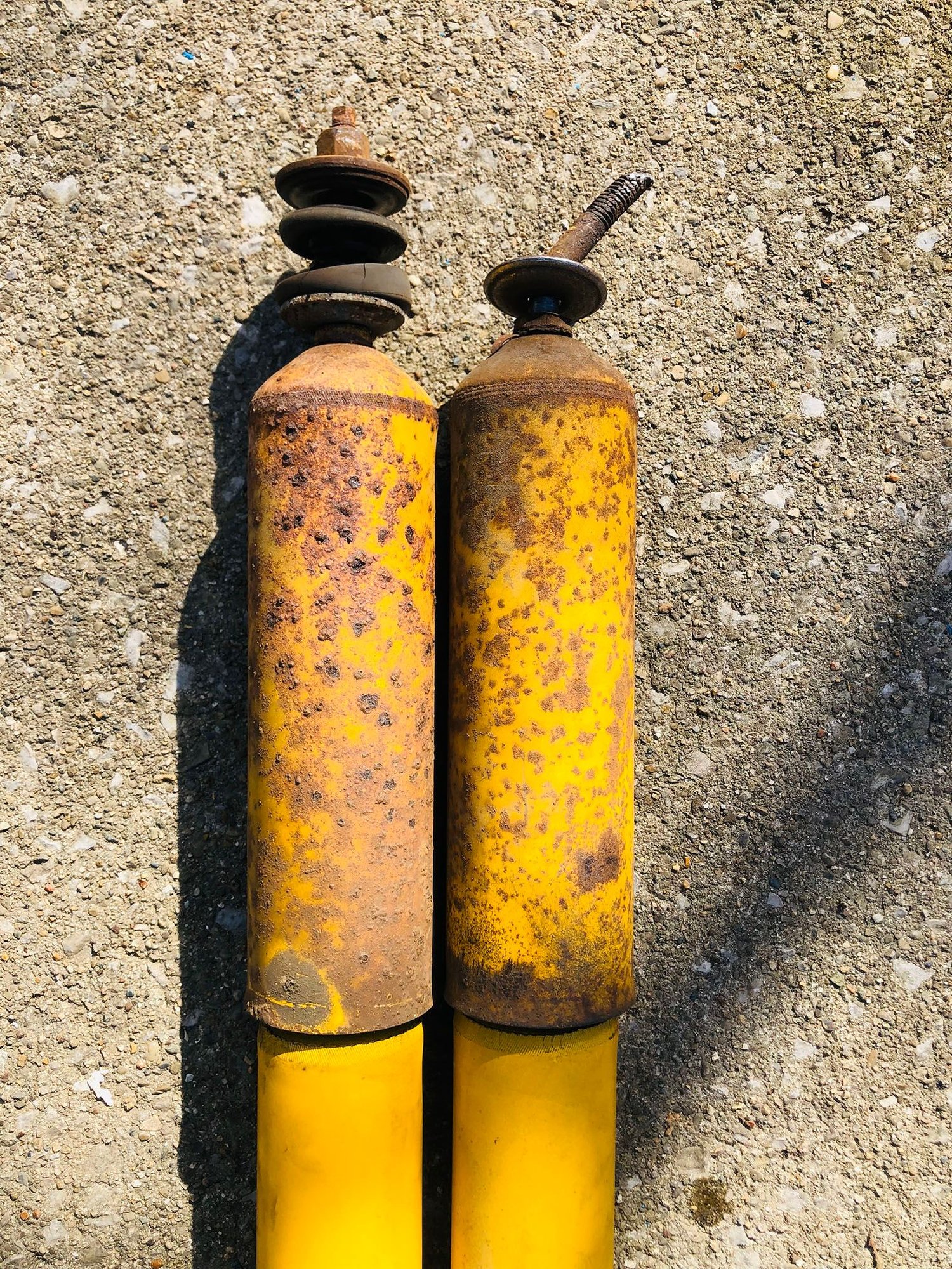

I replaced the existing shocks with some KYB Excel-Gs ($155). They seemed like a good combination of quality and value, though I know the Bilsteins are more commonly recommended on these forums. Maybe I'll go that route next time. Getting the nut on the top of the front shocks was a bit of a pain, but not as bad as some videos I watched. I think those were on E350s, so there may be some differences.
Old shocks were in bad shape. Most took many seconds to go from fully compressed to relaxed

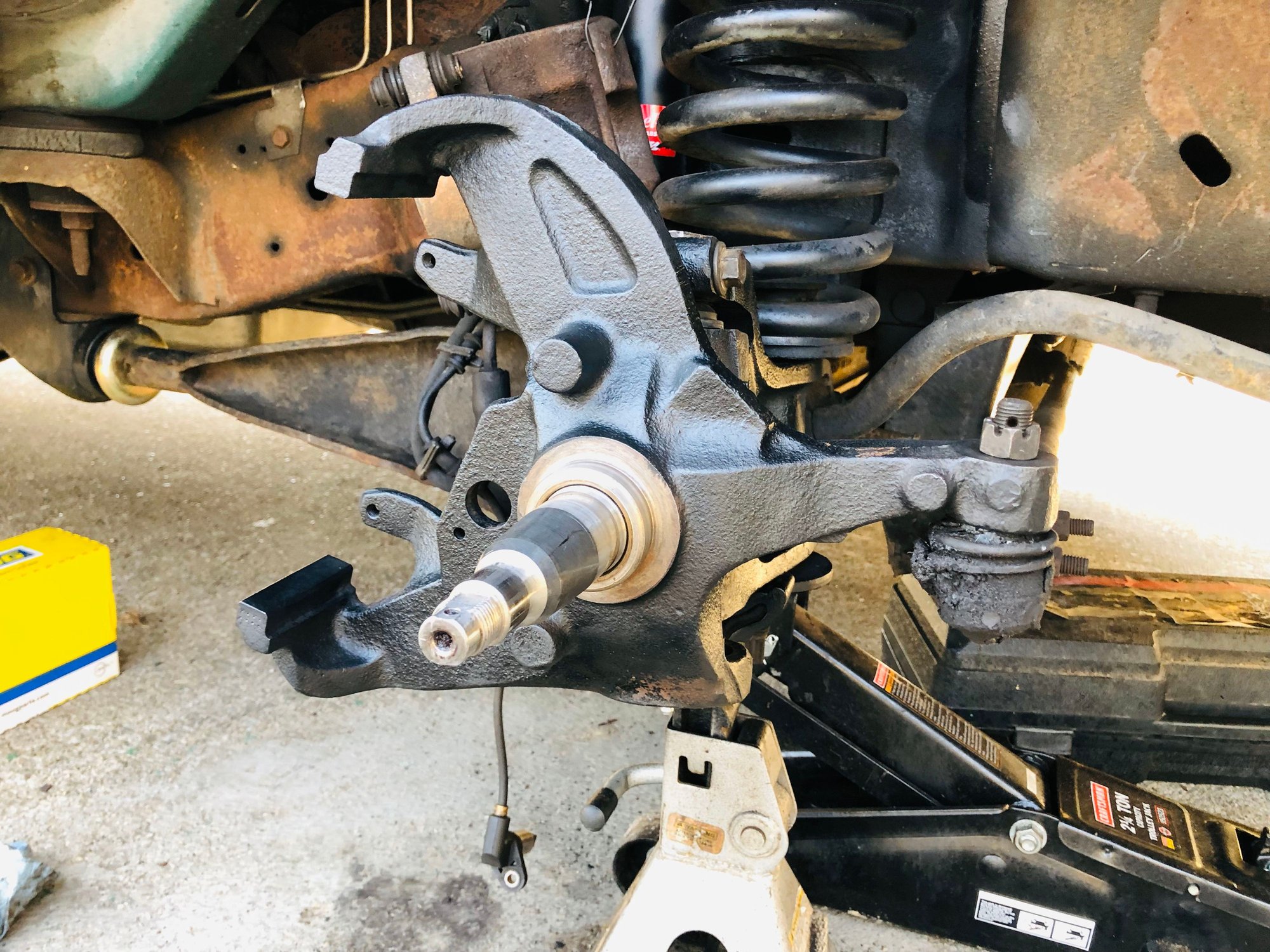

Moving on to the front of the van, I purchased a suspension kit including ball joints, tie rods, and center links ($130). I also had to purchase a ball joint press kit since this was my first time DIYing ball joint replacement. Press kits abound on Amazon and I bought one that was a step or two above the cheapest. I figured it would pay for itself in this one job, and if I could get a couple other future ball joint and u-joint jobs out of it, it would be money in the bank.
Stripping the front wheels down to the spindles is fairly straight forward. Luckily nothing was terribly rusted or frozen up, so most things came apart without too much drama. I decided to take the spindles completely off the van to make access to the ball joints easier and while I had them off I could give them a quick refresh by wire brushing them and spray painting them.

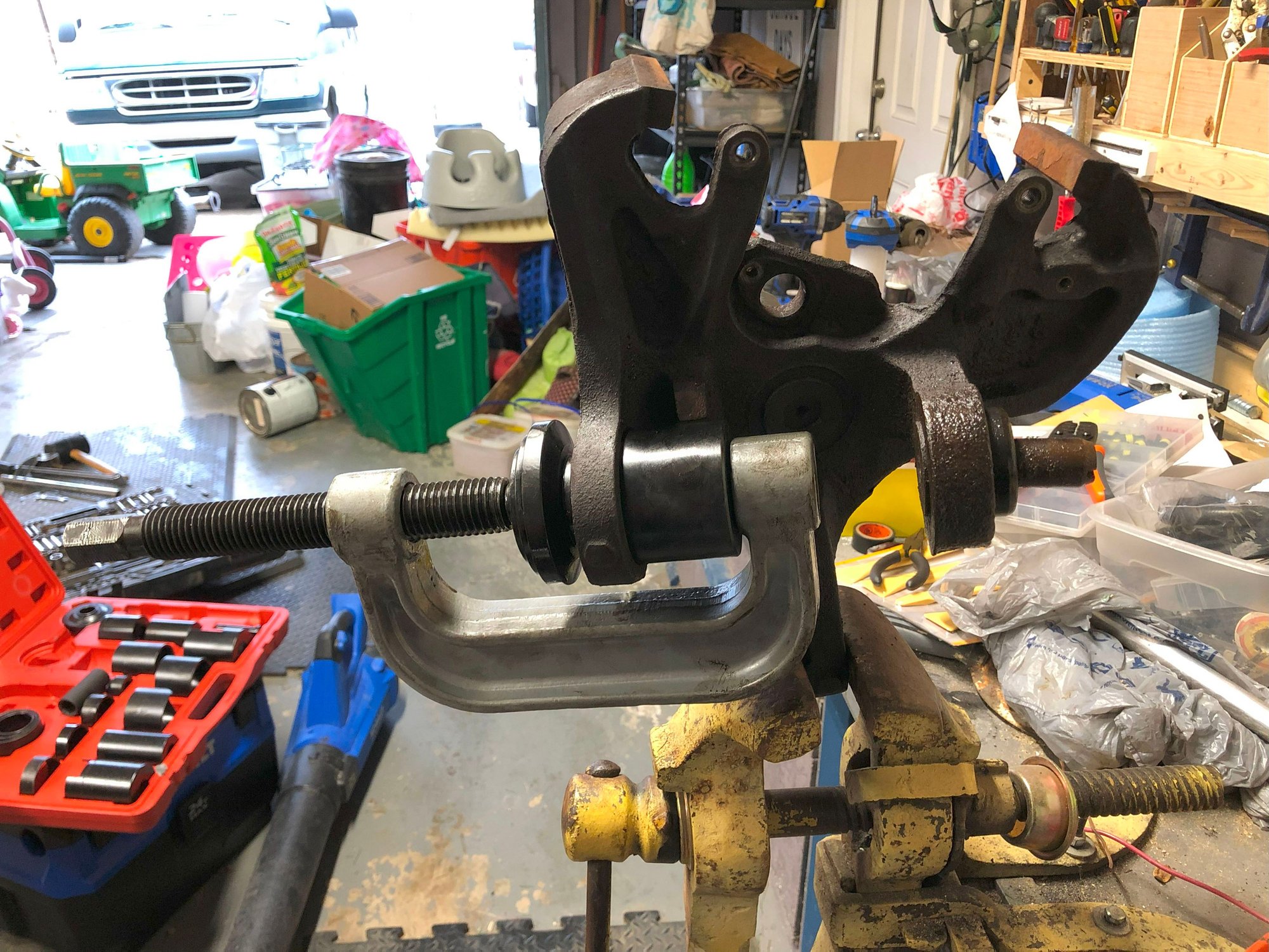

Pressing the old ball joints out
Spindle cleaned up and reinstalled
With the spindles off, I went ahead and cleaned up the coil spring tower and shot it with some more black spray paint.
Cleaning up components when I can. I little elbow grease and black paint goes a long way
With everything off the spindles, it was the perfect time to refresh the brakes and replace the wheel bearings. I decided to replace the rotors and pads. I got Raybestos 66455R discs ($98) and Raybestos EHT632H ceramic pads ($40). The calipers appeared to be in fine shape, so just cleaned them up and greased up the slide pins. I used National A13 inner bearings ($20) and National A12 outer wheel bearings ($18) as well as Timken 4148 wheel seals ($15). I packed the bearings with grease and followed the factory directions to correctly torque them down.

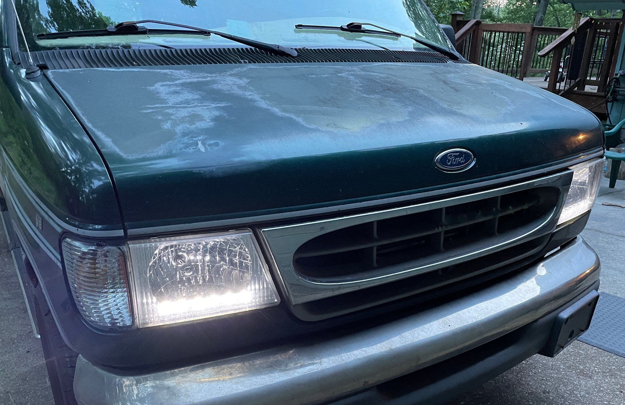

Maintenance and repairs are coming along nicely and at this point, I can see light at the end of the tunnel. To have a change of pace, I decided to do something "fun" and not fix anything, but give the van an upgrade. The headlights on the van were lackluster at best. So I found some headlamp housings with built-in LED light bar that I would use as daytime running lamps and I would use some LED headlights. I found the headlamp housings on eBay for about $100 - Autozensation F8UZ-13008-AA, and the light bulbs were Sealight 9007 HB5 ($46).
Headlamps before and after
LED strips wired up as DRLs (done later in build)
New headlamps and LED bulbs - bright, but not annoyingly so

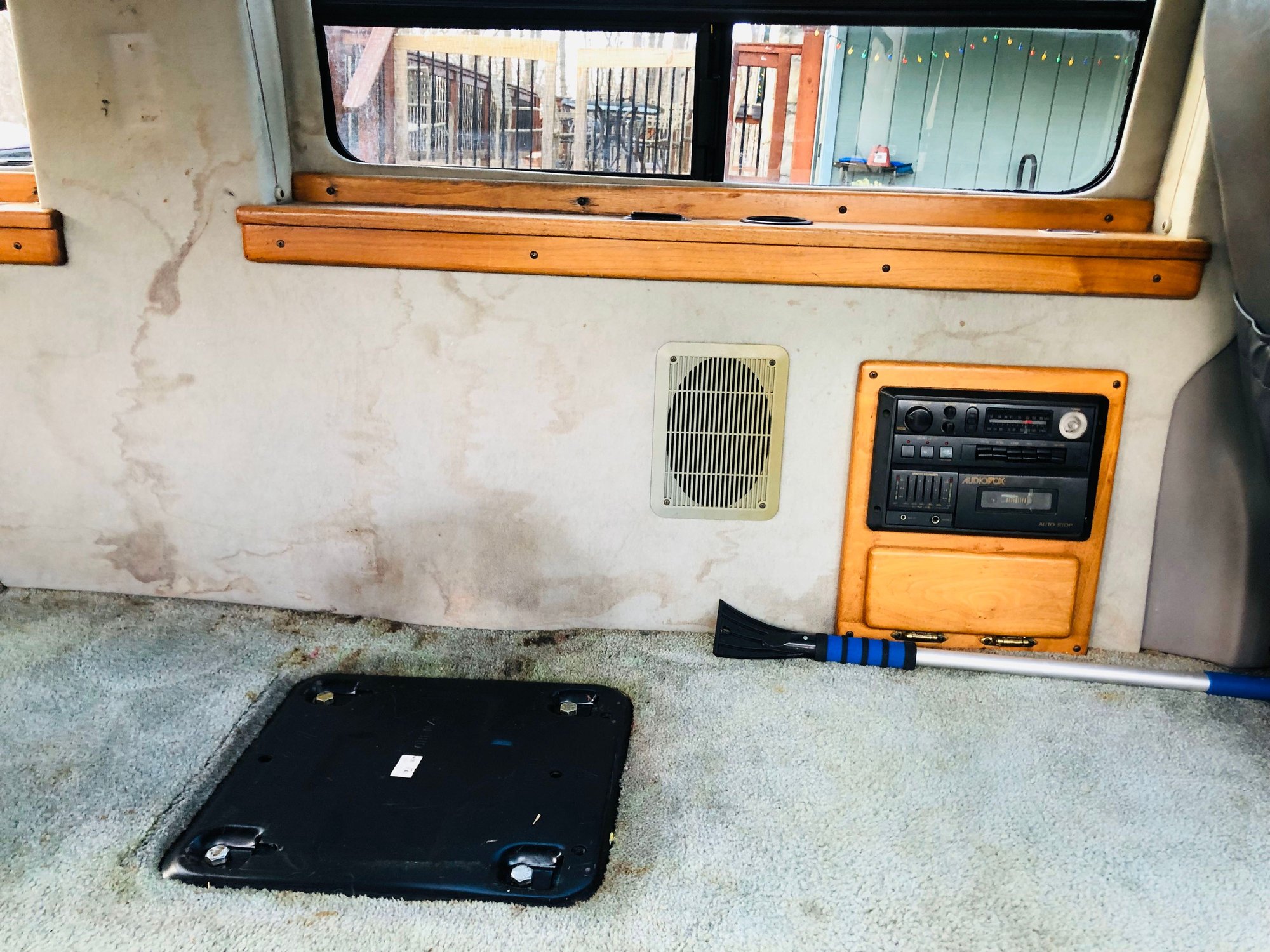

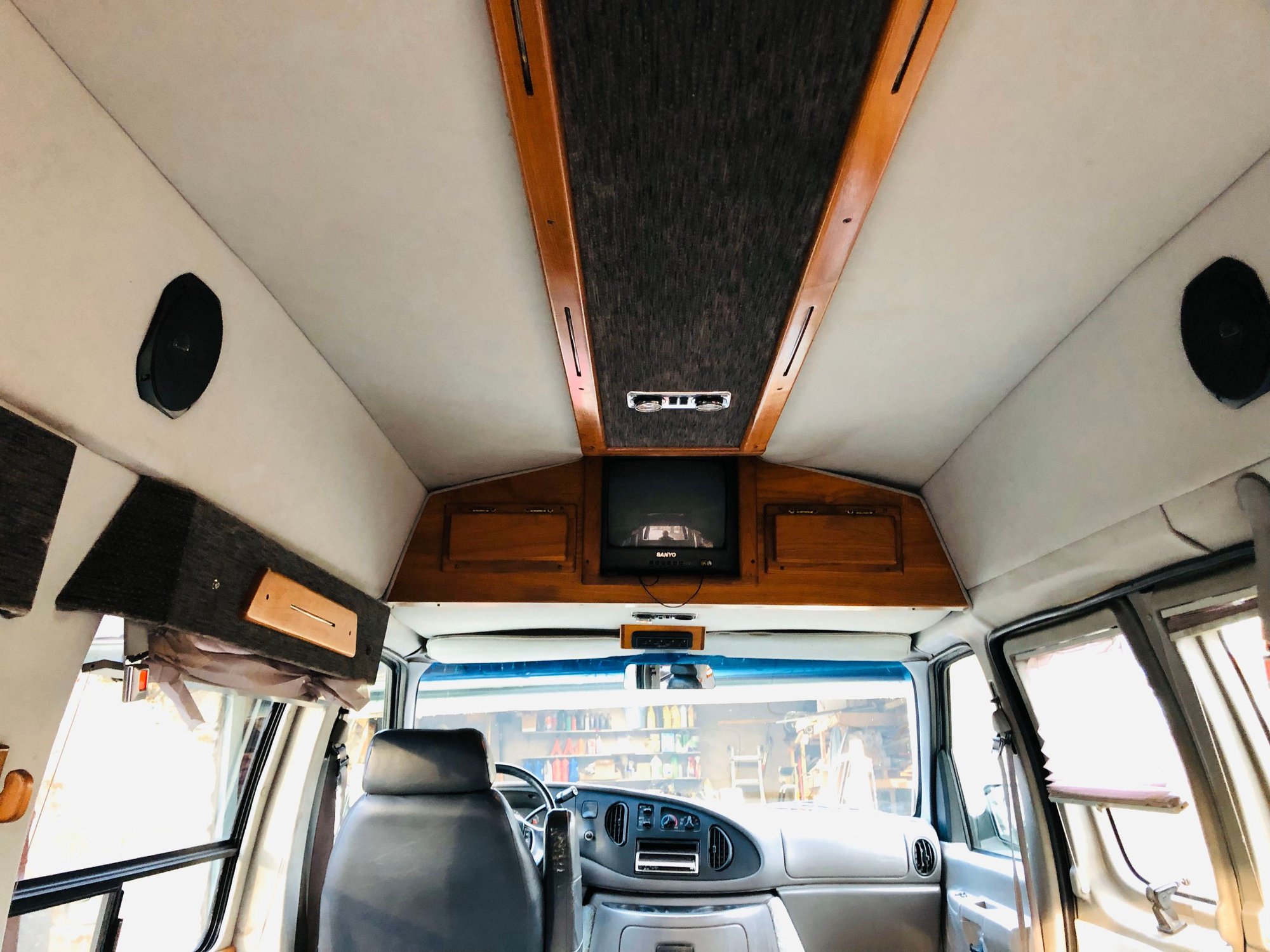

We were cleaning and assessing the van's interior during all the mechanical work I was undertaking on the van. We originally were thinking that all that was needed was a good deep clean and a few upgrades and repairs. However, the more we got into it and the more it was on my mind, we came to the conclusion that a full tear-out and new interior build was the proper way to go.
The pre-existing interior:
The van came with a dirty green interior with greenish-grey headliner on the ceiling and walls. The carpet was a badly stained "pistachio" green a few shades off from the headliner material. I'm sure when it was brand new it looked fine, but boy was it in need of some help!
The seats were after-market faux-leather bucket and bench seats commonly used by the conversion companies. Seating was for seven, two buckets up front, two in the middle, and a bench that folds flat into a bed in the rear. The seats are quite comfortable but the leather material has seen better days. The two middle seats are easily removed without any tools which is very nice. The two front seats use the factory mounting holes, and the rear bench seat has minimal adjustment forward-back.
The van's entertainment setup was a product of its time and a lot has changed in the 20+ years. A CRT TV and VCR were mounted in the upper compartment above the front seats. The sound system was hooked up to a cassette player.
Finally, there were a few cubbies, but I noticed that there was a lot of unused space - something that I would fix with the new build.
Here are some photos (most with seats already removed):
Looking forward towards front while showing ceiling
Looking towards back (middle seats removed)
Middle side and media center cubby

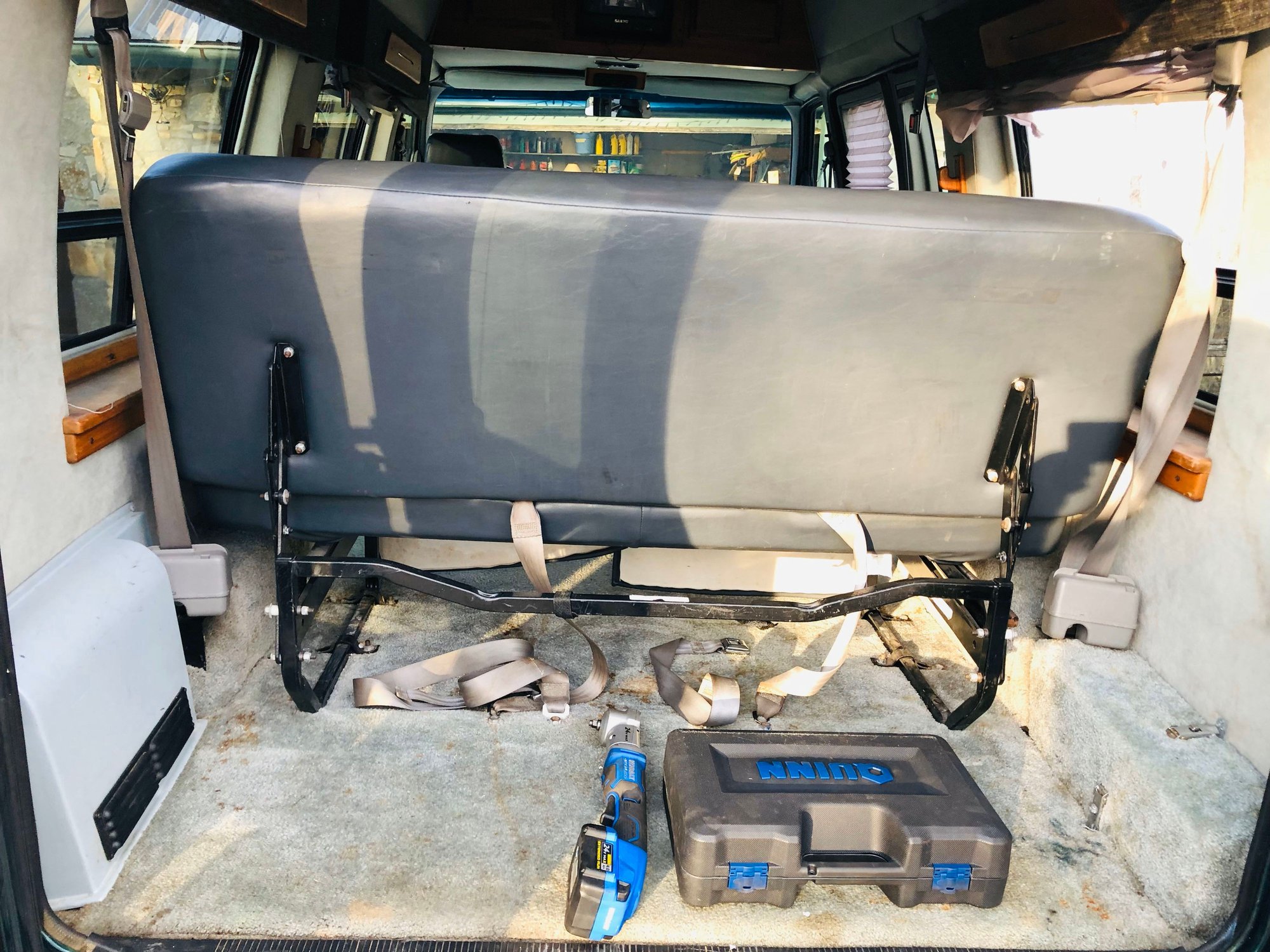

The first step in stripping the interior was removing the seats. As mentioned, the two middle seats are easy to remove, there are two star-handled bolts that can be removed by hand, then the seat slides out of the base.
The rear seat required removing 8 bolts that secured the frame of the seat to a bracket mounted to the floor via 4 clamps.
The front seats, although using after-market bases, still used the factory mounting with two T55 Plus bolts and two 18mm nuts, then unhooking electrical for the power bases and seat belt sensors.
The driver's seat came and went as I sometimes needed to move the van or take it on an errand, so I got plenty of exercise moving that thing repeatedly.
Rear bench seat ready to come out
Most seats removed and ready for demo

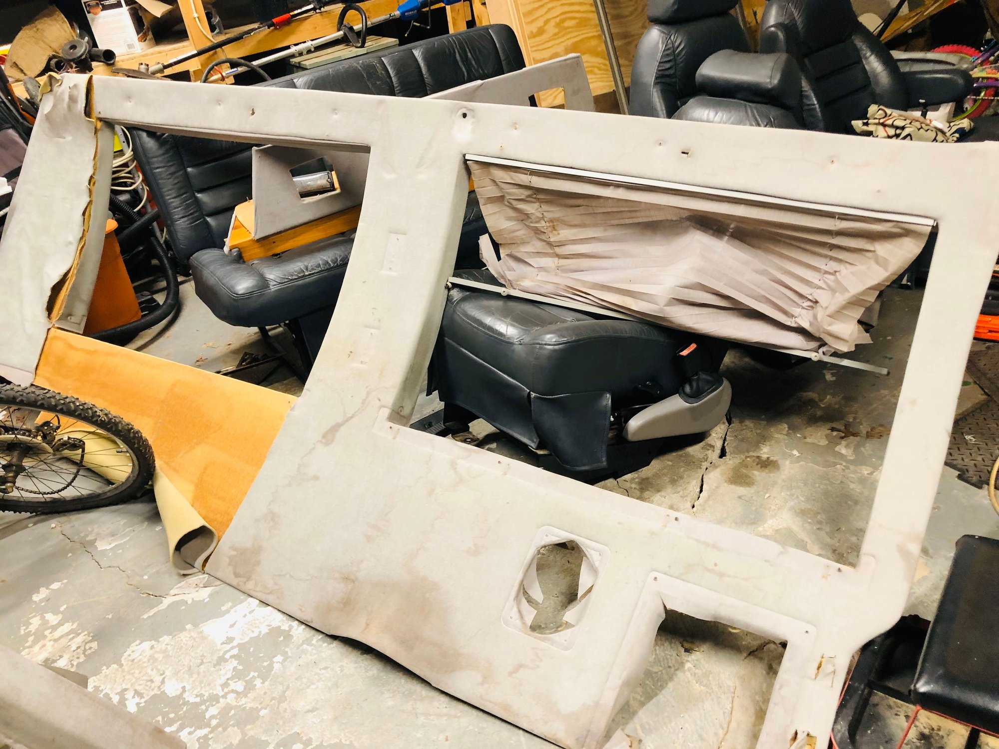

I wasn't sure how the interior walls and ceiling were constructed but I was about to find out! I was a little surprised that they were constructed of sheets of 1/4" tempered hardboard with a few pieces of plywood for support and shape, wrapped in foam-backed headliner material. It all seemed a bit flimsy to me and this reinforced my decision to tear it all out and start new.
One of the wall panels removed. Saved in case needed as template later on

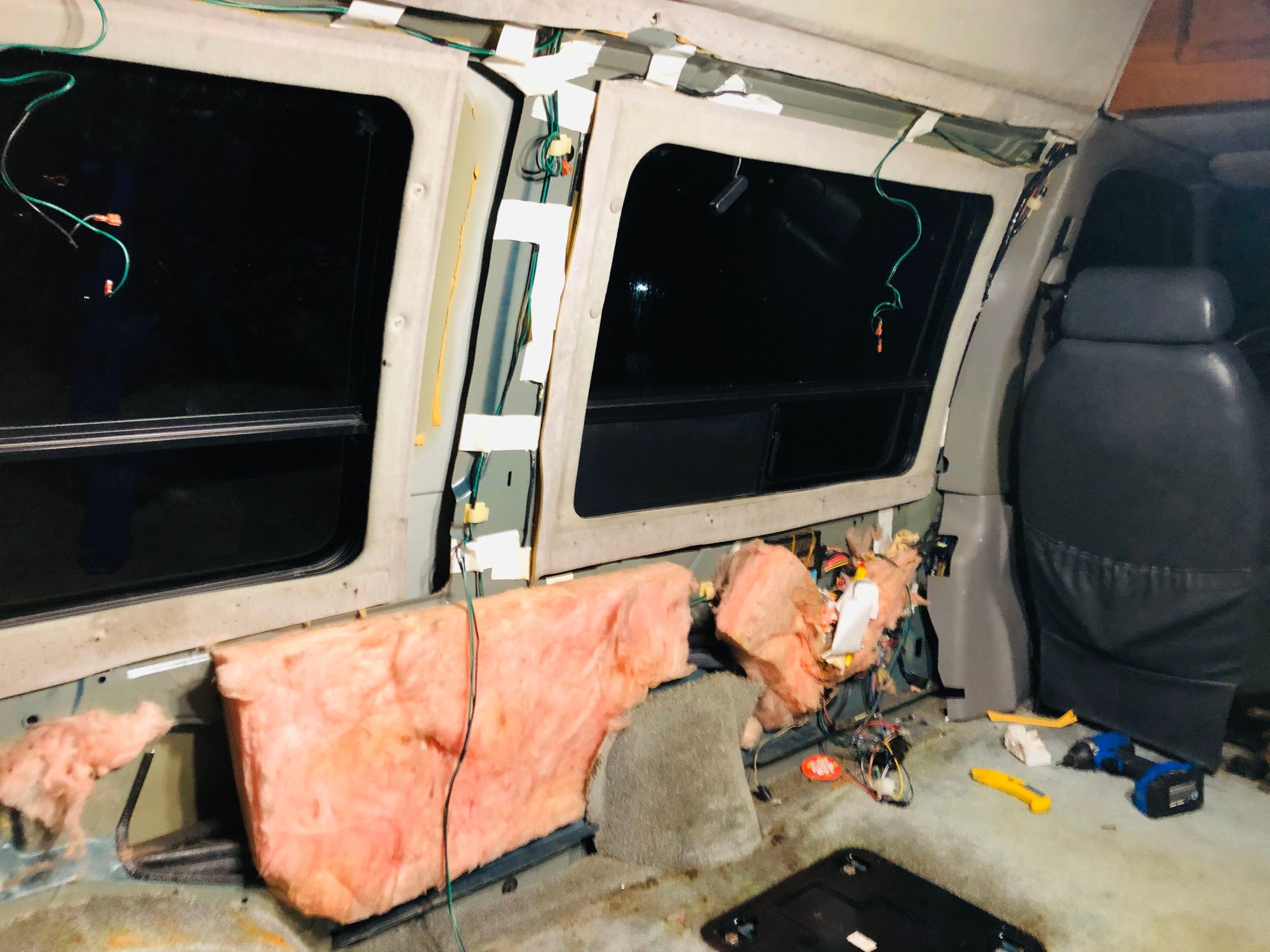

There was sporadic fiberglass insulation (and plenty of trash) hidden behind the wall panels. The windows had their own headliner-covered trim.
Behind the wall panel

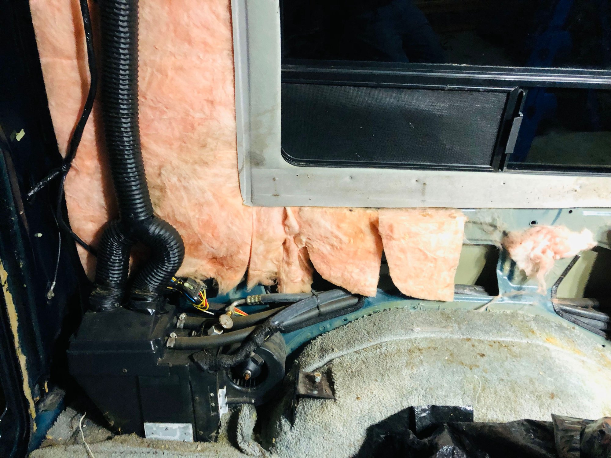

Behind wall panel exposing more of rear HVAC

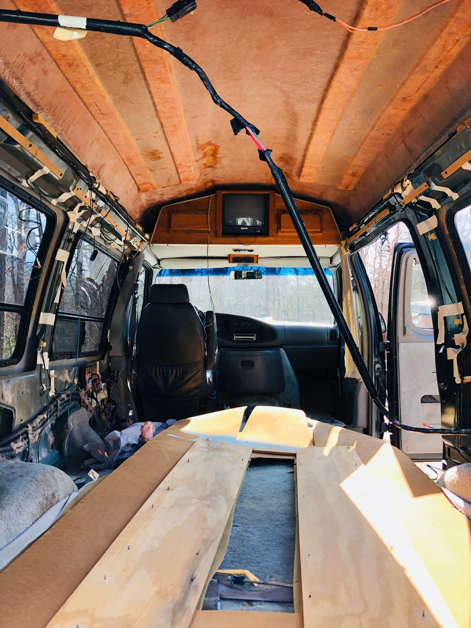

Ceiling
Finally, the ceiling panel had to come out. The middle section with wood and lights came out easily enough, but the rest was one panel and a bit heavier than expected due to more substantial plywood backing. It was a bit awkward getting it out without prematurely tearing out wiring or hitting my head, but I finally got it down and out and exposed the underside of the fiberglass high top.
Ceiling panel resting on floor exposing underside of fiberglass topper

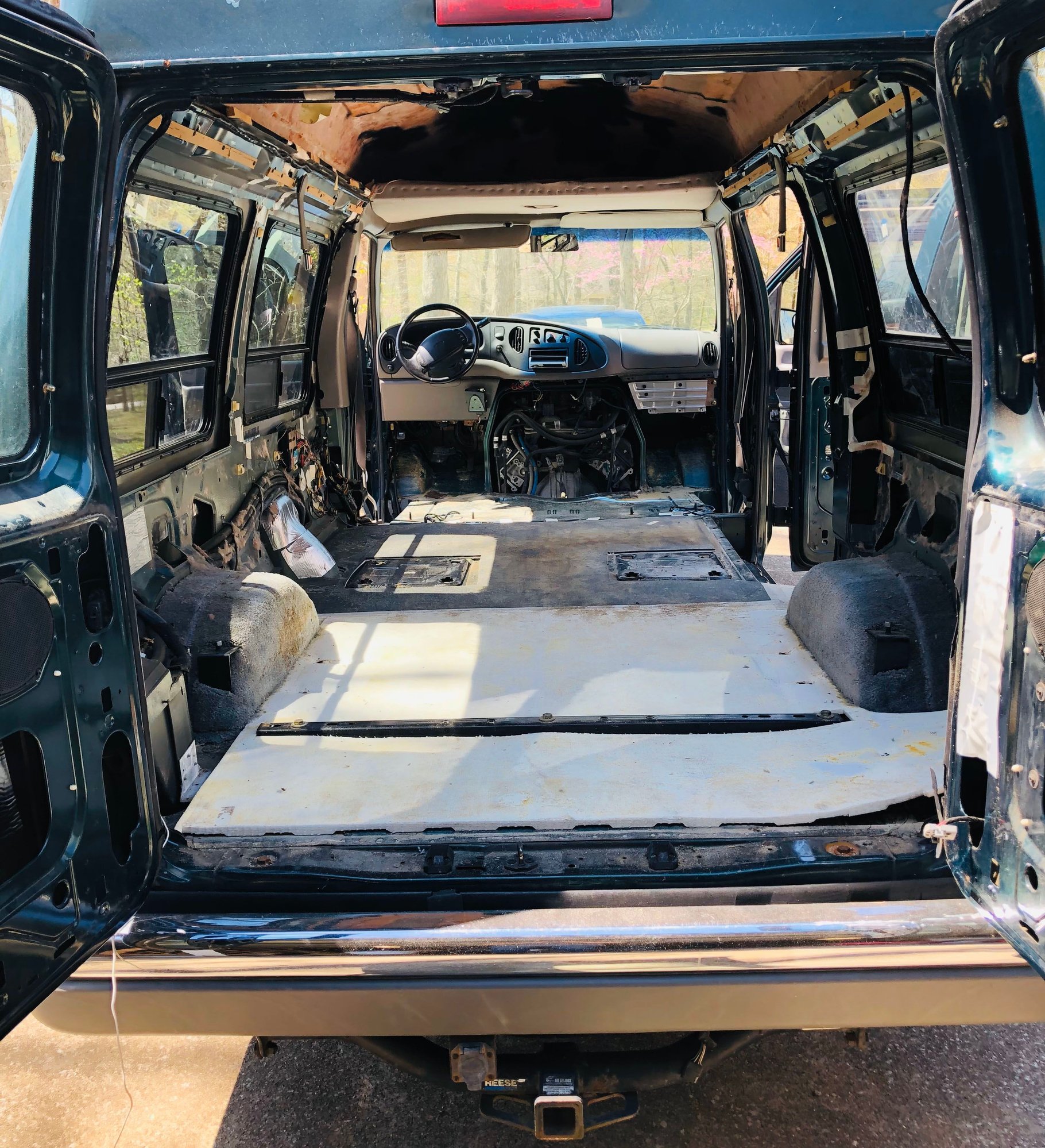

Everything from the floor up had been removed at this point, so it was time to turn my attention to the carpet. Luckily for me, it came out very easily. It was glued down in a few spots, but came up without much force. I removed the carpet in one large piece and set it aside to save it as a template for the new carpet.
The gross, old carpet removed and set aside as a future template
I found that there was foam padding under the carpet from the back of the van to the back of the front seats. The foam padding was built up to match the ribbing in the stamped steel floor. I removed this and set it aside, unsure if I'd be reusing it or not. By now, my garage was filling up!
Foam under carpet padding
There were a couple of rust spots, but nothing too bad. The worse of it was under the driver's left foot area - apparently a common area. I cleaned the loose material and applied some POR-15 over the rust areas. I was overall happy with the condition of the steel hiding under all the finishes.
The worst rust spot in the drivers foot well
The worst rust spot in the driver's foot well
So here it is, the van stripped down to bare metal. Now that I could see exactly what I was working with, I could come up with more concrete plans for how I would rebuild it and wire it up. This is when I was doing a lot of research to get ideas and soon found out that virtually nobody was building a van as a road trip and passenger vehicle, everything was about turning them into campers or "van life" vehicles - which is fine, but not what we wanted. The interior is completely stripped down
