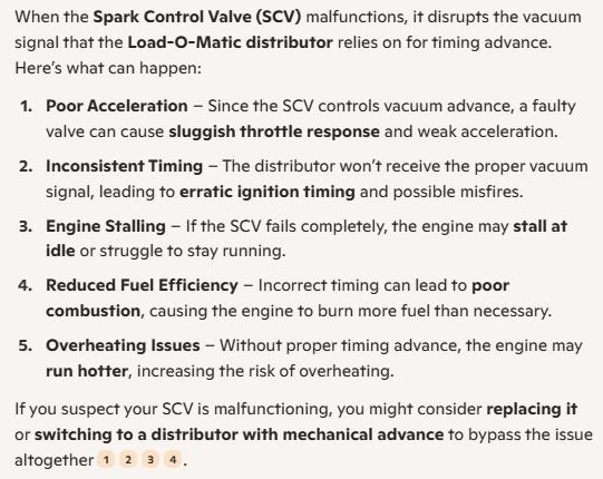

Assuming your 240 still has the original style Load-O-Matic distributor the Motorcraft 6R 3507 B carburetor might not be the best match for the Load-O-Matic distributor. Load-O-Matic distributors rely entirely on vacuum signals from the carburetor for timing advance, and they require a carburetor with a spark control valve to function properly. Based on discussions, the 6R 3507 B carburetor may not have this valve, which could lead to poor performance and improper timing advance.
If you're using a Load-O-Matic distributor, it's generally recommended to pair it with a carburetor specifically designed to work with its vacuum advance system. Otherwise, you might experience weak acceleration and inconsistent timing. Some people opt to swap out the Load-O-Matic distributor for a later model with vacuum AND mechanical advance to improve performance. Then you can use a carburetor without the spark control valve, too.

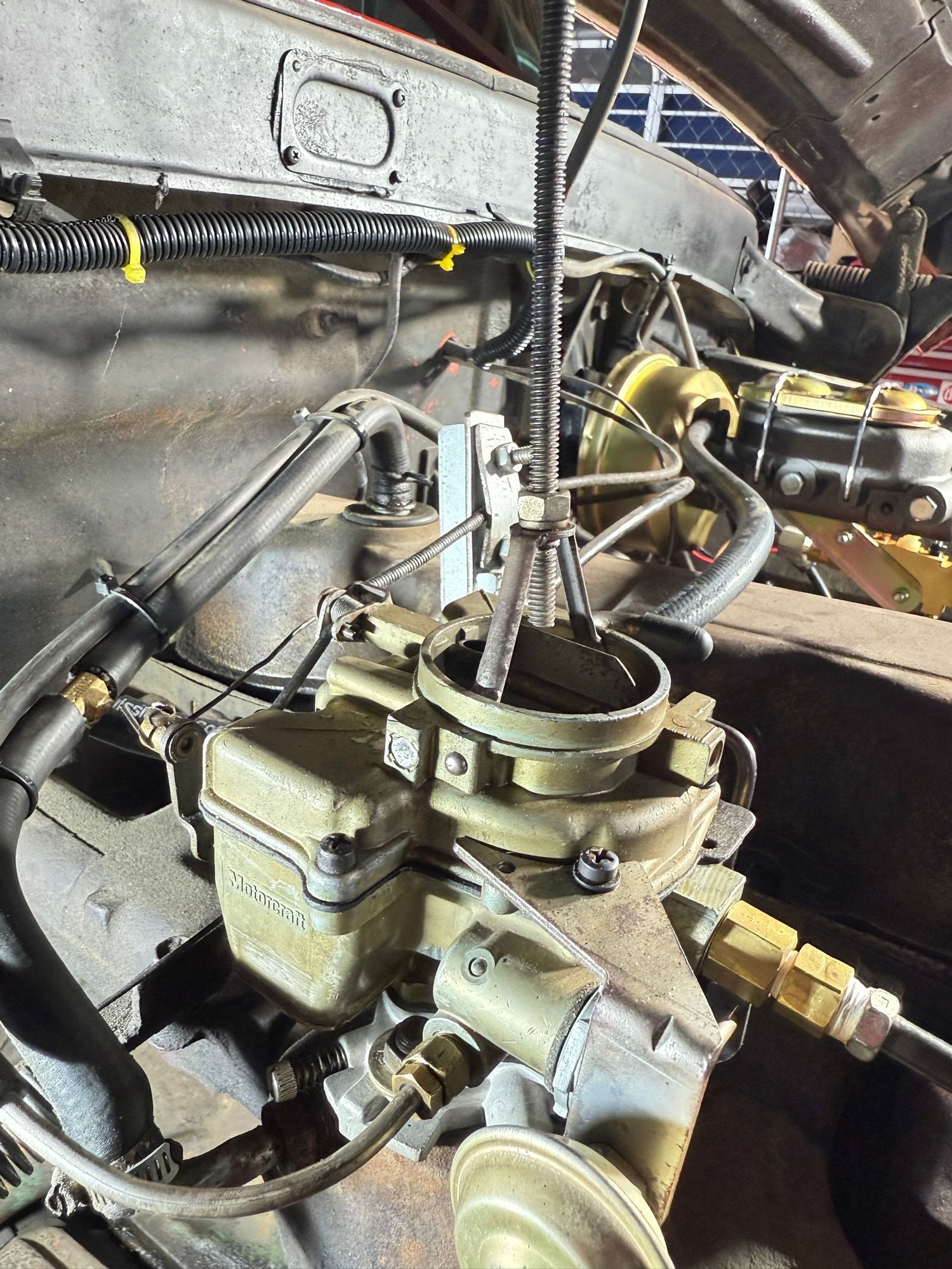

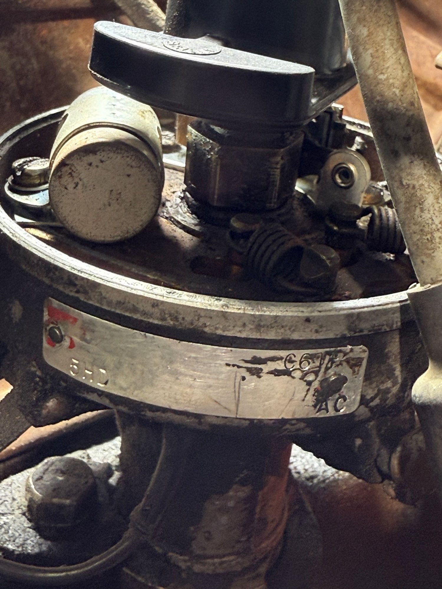

Here are a few pics of my current setup on my truck. Can anyone tell me if these are compatible or does one of them need to be switched out.
Carb is a Motorcraft 6R 3507 B thanks Jeff

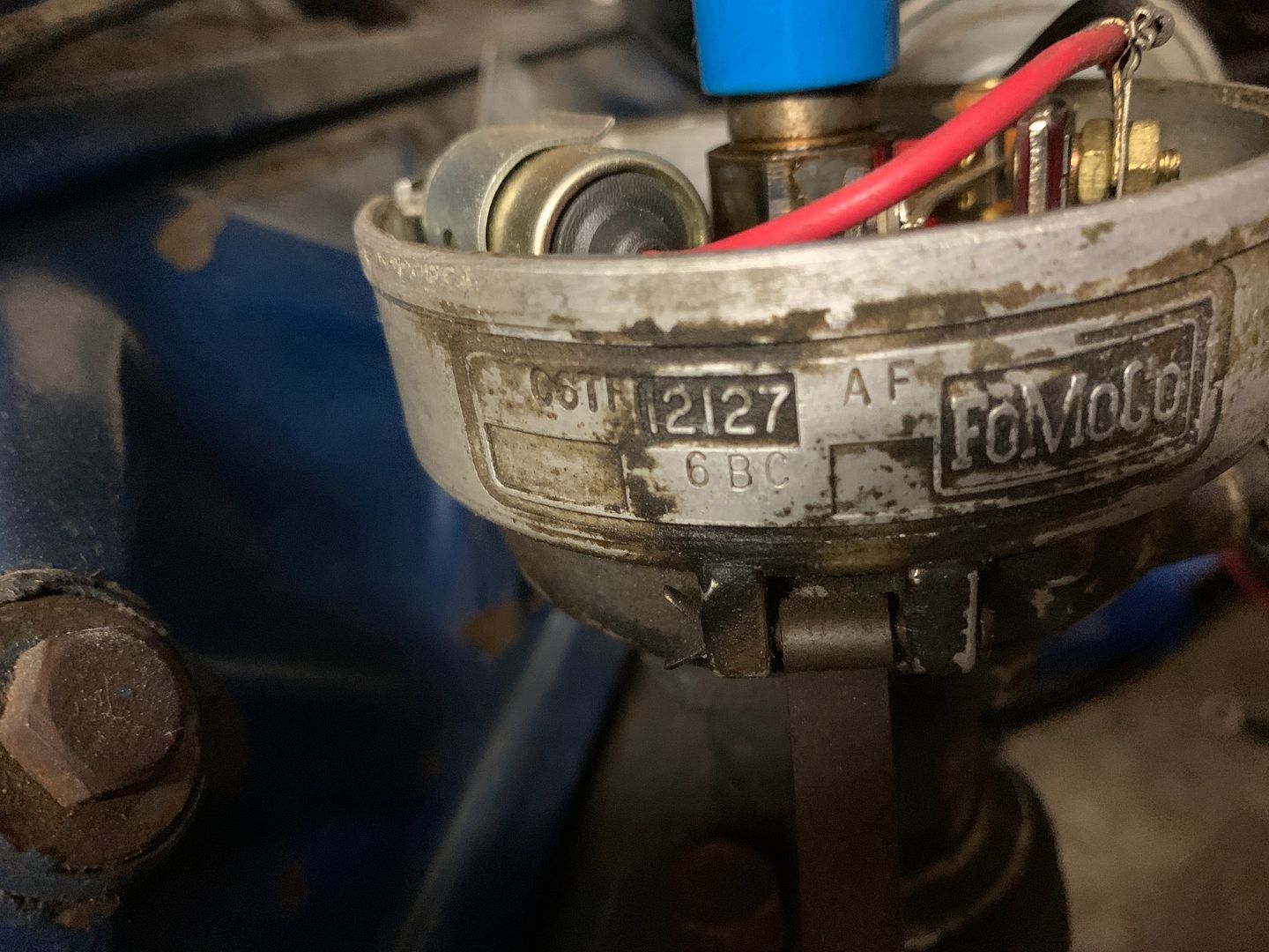

I'm not used to the metal identification tag on the side of your distributor. I have several around here from 1963 through 1966 and they all look roughly like this picture with the 12127 numbers and FoMoCo cast into the housing and a stamping for the Prefix and Suffix as well as the date code.
This example is a C6TF-12127-AF which corresponds to the 300 L/D 6-cylinder engine. The C6TF is the Prefix and the AF is the Suffix. The date code of 6BC is 1966 February 3rd.
If we go by what your tag seems to show it seems it also has the Prefix of C6TF and the Suffix of AC meaning C6TF-12127-AC which corresponds to a 240 6-cylinder engine. The date code looks like 5HD which would be 1965 August 4th. Fine for a 1965 or early 1966. I sort of suspect that distributor has seen a rebuilder at some point in its life so it may or may not be original to your truck.
My current hunch is that is a LOM distributor. The centrifugal weights are underneath the top breaker plate, so it takes closer inspection to see if they are in place or not.
On the carburetor I think that is a Spark Control Valve (SCV) near the fuel inlet. Silver color and looks like a Holley power valve or an Autolite Economizer Valve. It might be that it simple isn't working correctly - meaning the SCV. They do unscrew and can be replaced.

You definitely have a Load-O-Matic distributor, those springs are a dead giveaway. I don't believe the numbers on the side of the carb tells exactly what it is. I suspect it is a universal replacement for the original Autolite carb. The advance curve for that distributor is 10 degrees @ 1.20 inches of vacuum and 22 degrees at 4.90 inches of vacuum at the crank. The distributor is kinda ugly inside, but it may still work OK. When I trouble shoot that system the first thing I do is disconnect the vacuum line and set the timing to 6 degrees using a good dial back type timing light. Then reconnect the vacuum line and see what the advance is at idle. With your distributor it should be in a perfect world 28 degrees but anything up 35 degrees is OK.
If it passes that test you know the distributor is working, to check the spark control valve disconnect the vacuum line and connect a vacuum gauge to it then start the engine it should read between 4 and 5-1/2 inches of vacuum.

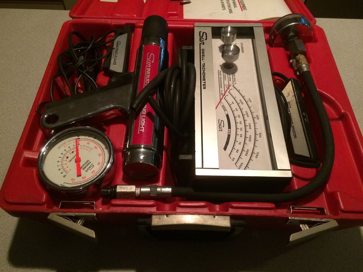

If you have a vacuum gauge it's a pretty easy test to do and might save time versus waiting for a part that possibly doesn't end up changing the situation/symptom. I mentioned it might be the SCV itself since likely not changed with a carb rebuild and it's a critical piece in the LOM system. Good to know it can go bad and is replaceable. But I'm often wrong so don't take my word for it. If you don't have a vacuum gauge I can recommend getting one. Handy for troubleshooting various things. Mine came in an older Sun brand set that included a timing light, compression tester, tach/dwell meter and remote starter switch. Nice case it all comes in, too. Sun was one of the best back in the day. But, doesn't need to be fancy to get a reading.
