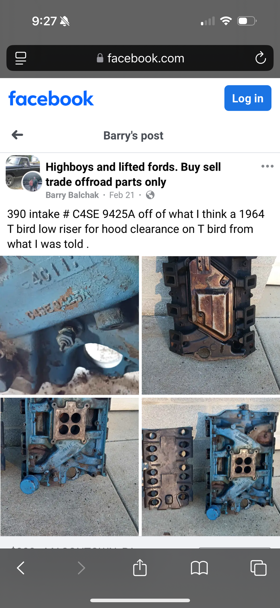

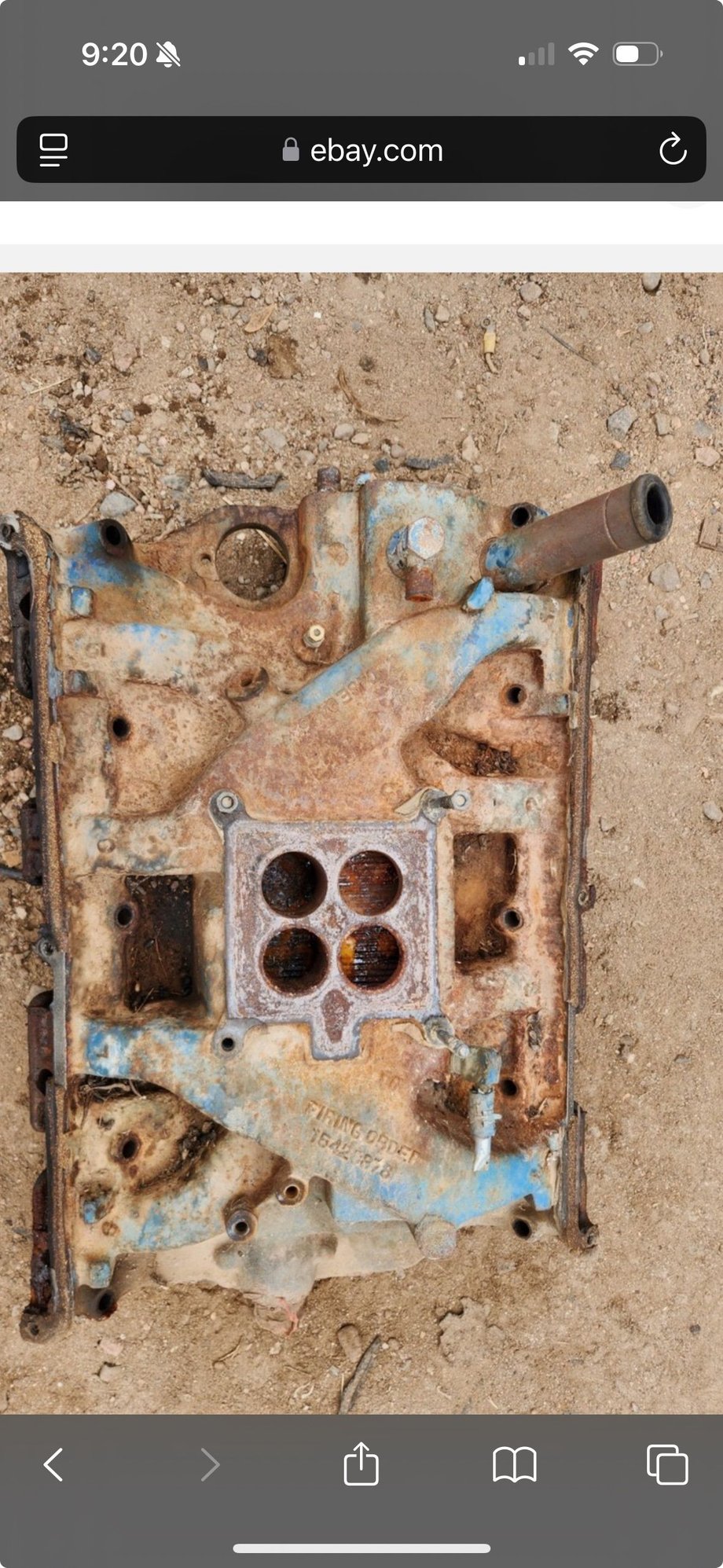

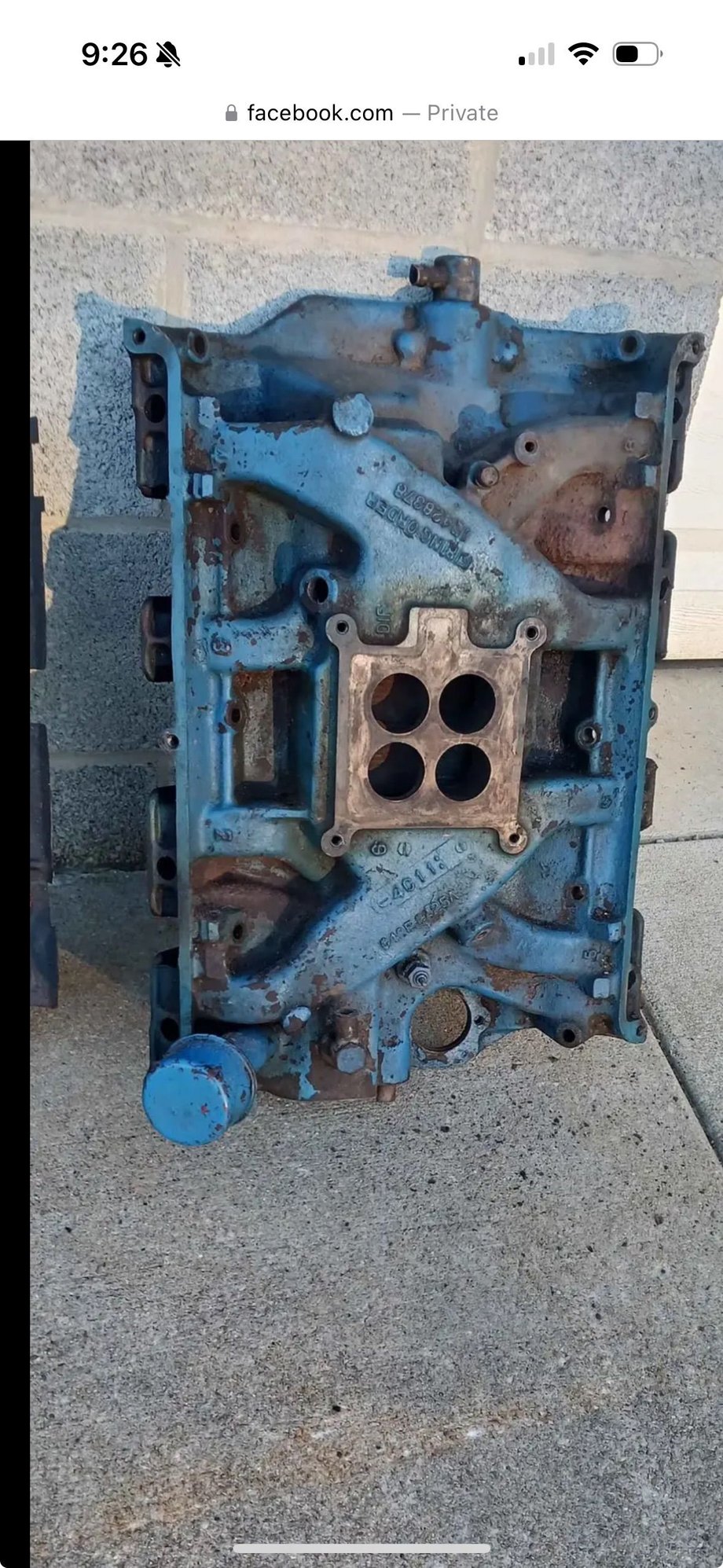

the attached pictures i pulled off of the internet along with the number but it sounds like
my intake may be a pre 64 off of a Tbird.
The tube I’m talking about is on the top right of the manifold in this picture.
The tube and breather is on the bottom left of this picture

That's the oil fill tube and crank case breather.
'64 might have had a PCV system, or a road draft tube. I don't see the road draft tube remnants on the back of that manifold. Breathers and fill ports moved to the valve covers in '65.
EDIT: Road draft tube goes straight out the back, see pics in post 4
Also, '65 might have been the change over from the expansion tank sitting on the engine to the left of the distributor, so that could explain the t-stat housing difference.

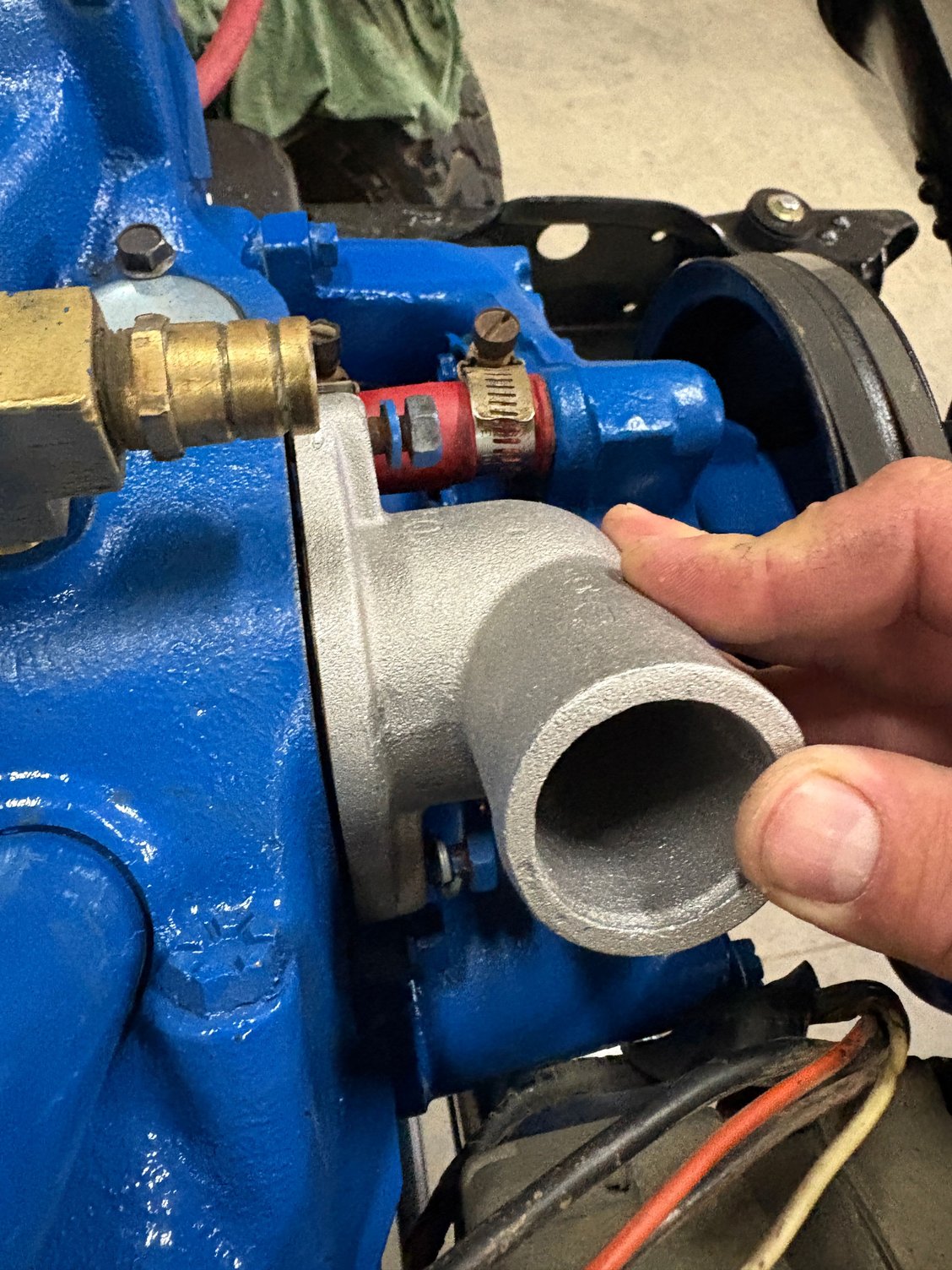

Apparently they must have use a different thermostat housing and thermostat. The one off my other engine won’t fit on this one.
here is the intake numbers off of it. How do we look it up?

It's a 1961 version, casting date 1F9, 1961, June 9.

As I’ve learned and as it’s been stated, in late 66 early 67, the intake and head ports were
downsized and the thermostat itself and housing went from 2.5 inches to 2 1/8th inches. Simpler put there are two sizes. Big and small.
I found a company that sells reproductions of the big thermostat housings and purchased one as well as a thermostat.
should be in soon and I’ll report back on it.

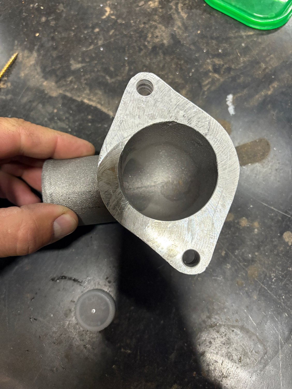

Today I got the thermostat and housing.
The 2.5 inch thermostat is the key but the housing isn’t going to work as it is unless maybe I double up on the gasket. The housing is not recessed for the thermostat.
I am going to take the housing into a machine shop tomorrow and see if they can mill it out.
