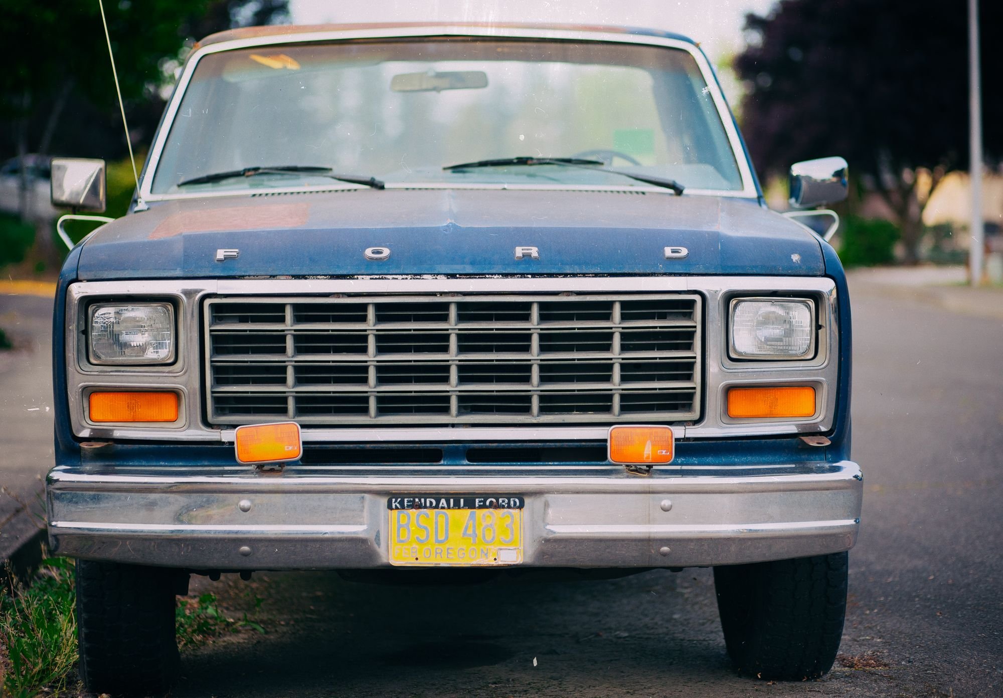

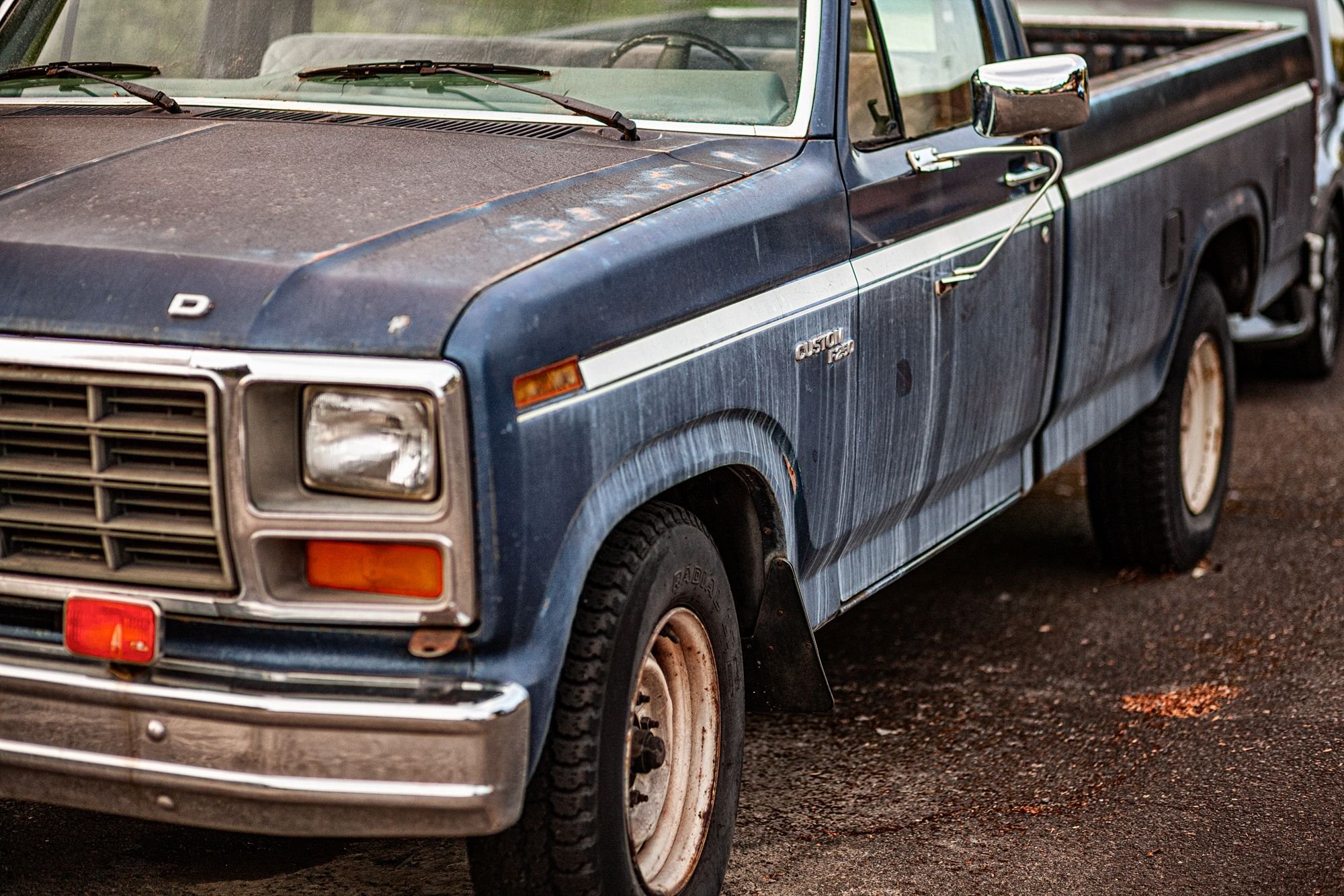

1981 F250 Custom. Has the 300-i6, some very tasteful patina, and possibly some super low miles (though, I doubt it, with the oil leakage). Either it's got 14,500 miles, or 145,000 miles. Does the white mileage indicator show tenths, or full miles? Anywho, here's a couple snaps before I sign paperwork on it tomorrow.

WOW thats solid!!! I bet it will look 100% better just with a bath. As for the leaks... If it stops leaking, your out of oil.

First welcome FTE.
I am with the wash and I hope you dont run it out of oil
My 300 showed signs of leaking from every gasket so part of the rebuild of the truck, 4 year cab off frame, I replaced all gaskets but the crank seals.
I have had to go back and tighten up bolts as I went with cork gaskets not the rubber, did not know at the time.
We are here to help the best we can but from the looks of it a little cleaning, checking of fluids and a battery it may come to life.
Good luck
Dave ----

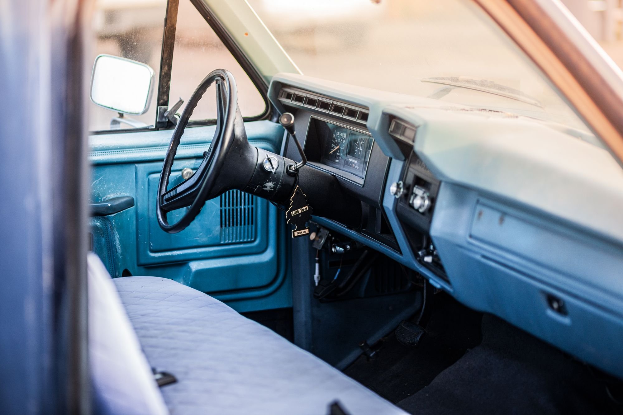

Moving forward from that, I like to think I'm fairly handy with a wrench, but I have no idea what this is, connected to my throttle (in the engine bay) Any ideas? It seems super janky, and not original.
I've also got a beaded chain connected to the arm on the brake pedal in the cab. It connects to a small device clamped to the arm itself, and appears to also have a vacuum hose attached to it. Maybe all this is normal - I just have no idea.

That looks to be an aftermarket speed control system. The factory version has the control buttons on the steering wheel, but you appear to have the plain version. Any odd switches in the cab?

Definitely a few odd switches in the cab. The speed control is hose-clamped to the turn signal stalk. Knew something wasn't quite right about that. lolol
There's another couple weird buttons and wires that I'm going to have to trace to find out as well.

Yep aftermarket or dealer installed speed control if the controls are on the turn signal stalk.
