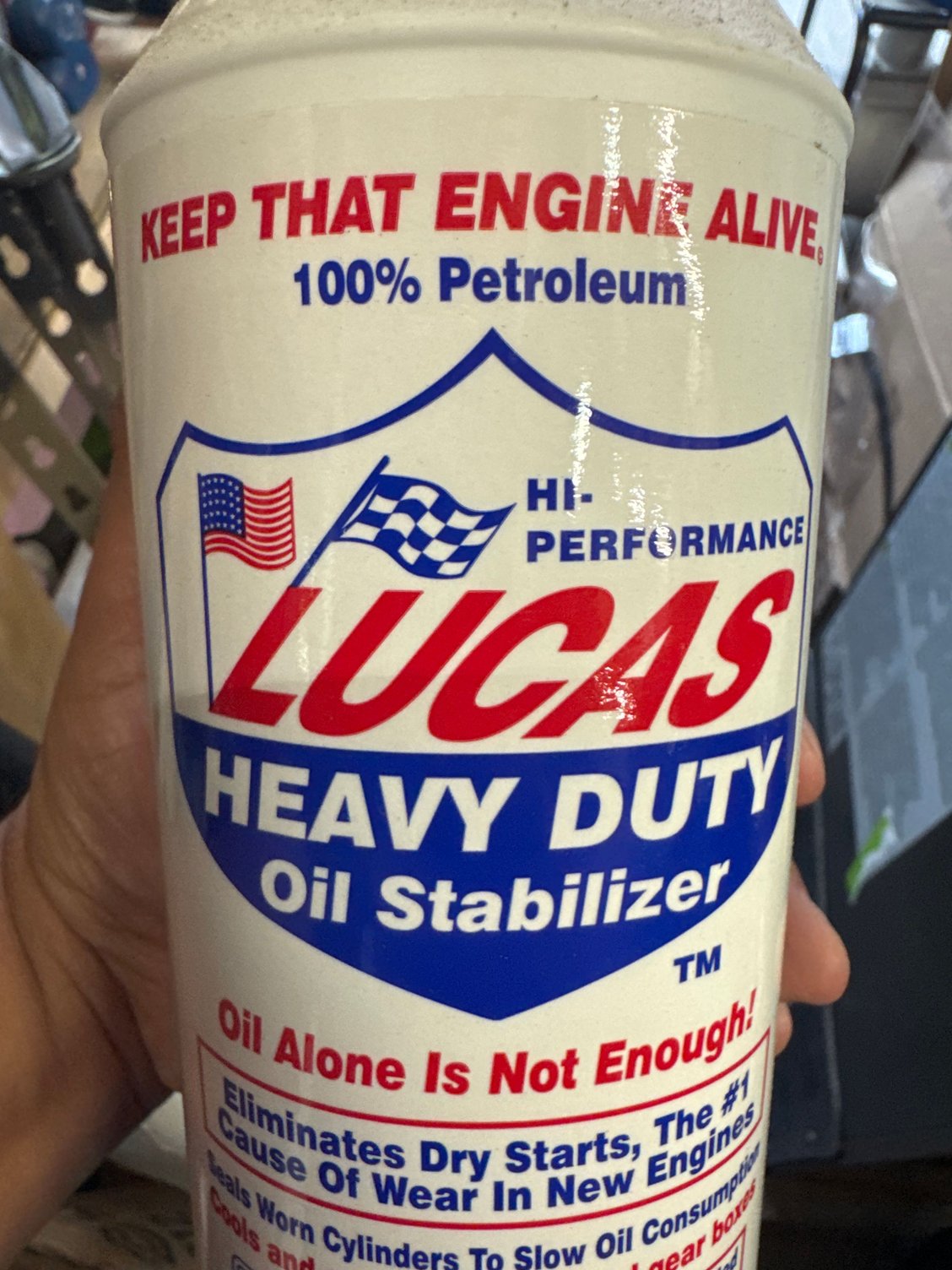

has anyone used the Lucas engine oil additive on their Godzilla engines? I used to use this on my F150, but it was a 2000 with 120,000 miles on it.

All it does is increase the vicosity of the oil. Inappropriate most of the time and a waste of money. Possibly harmful to your engine.
Is there a problem you are trying to solve? If not, why would you even bother with this stuff?

Hi thanks for the reply, im not trying to address any issues with the lucas ( i wish my leaky front seal could be solved with a bottle of lucas ) I just found a bottle i was going to use on my 2000 f150 before i got rid of it, and was wondering if i should use some on the superduty.

I would stay away from that crazy thick additive as 120k miles is nothing. Take you leaking front seal to the Ford dealer and get it repaired the correct way under warranty.

this has always been my approach to oil additives, you don't need them if you use a good oil from the git go. JMHO

It is actually nothing but super heavy base stocks, no additive of any material kind in it. It is utter and total crap only useful to keep a POS motor from completely falling apart or to get an extra season out of pappy's old lawn snapper. It is 10 times as resistant to flow at 40 weight engine oil. It masks noise and pumps up oil pressure due to its shear viscosity alone. That is why people claim it help them with their uncles friends neighbors dog walkers buddies roommates old Chebbie... it is a bandaid. They make neat little display that 7 years like to play with at the auto parts store.
Can you tell I don't care for it?

Since I have a "fleet" of old trucks, some of them with tired engines that leak, yes, I have used it on them to prolong their life... however with the new engines, the tolerances and specified oils are much thinner, so I definitely would NOT use it in anything newer than say 2002-ish. It is a band-aid for worn out engina's and buys some time if you're not ready to do a rebuild just yet.

Rotella 5w40 vs lucas
Just a scant 7.54 times thicker than the most common 5w40 out there... were taking the viscosity difference between fresh veggie oil and slightly warm honey.

Wow! so you could buy 20w 50, and save yourself $7 a quart.

20w50 is about a fifth as viscous, topping out at 21.9Cst...
