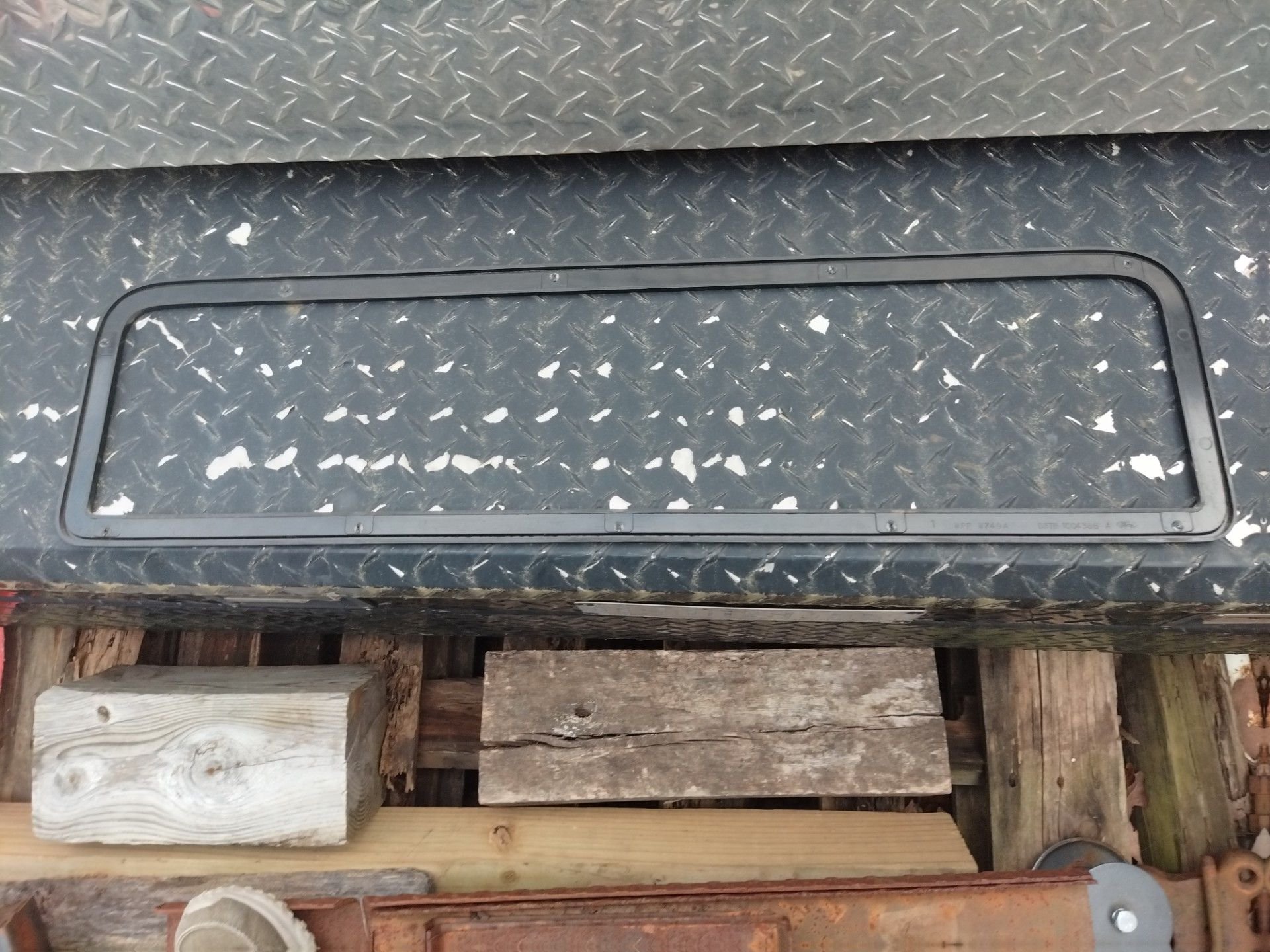

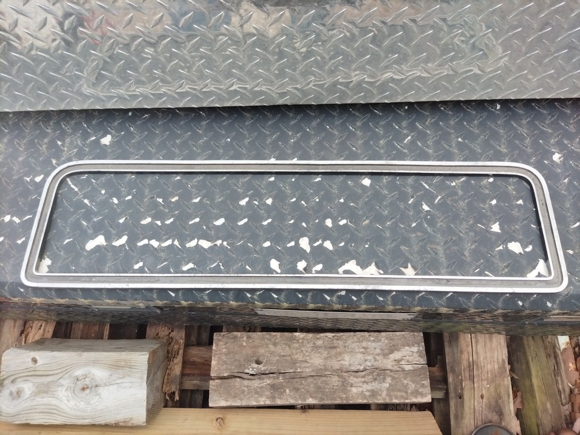

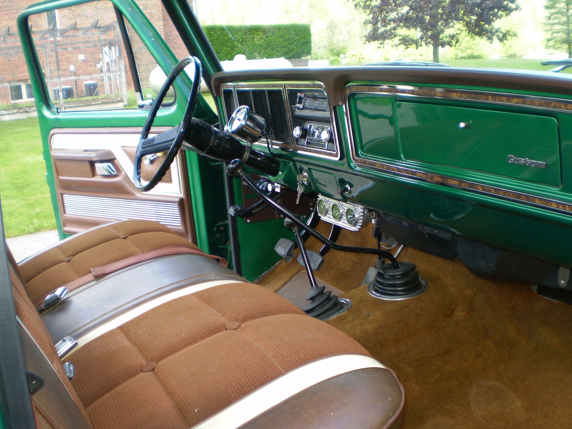

X2 have to drill 10 holes, there is a older (73-76?) pot metal and chrome one (like in the green truck) that mounts with 10 studs and open end acorn nuts. The studs break easily when you try to remove and or reinstall the nuts. Then there is a black plastic with red center tape for the 78/79 Free wheeling package. And a XLT / Lariet plastic version with silver on the outer lip and wood grain on the inside, they both stud mount.
I would guess you can source a used plastic one (Ebay), I am pretty sure they are NOT reproduced, remove the studs and use 3M tape to avoid drilling the dash.

Friend, that is one beautiful interior on your truck. Well done.
