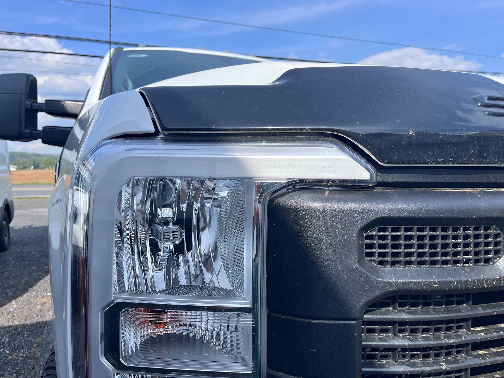

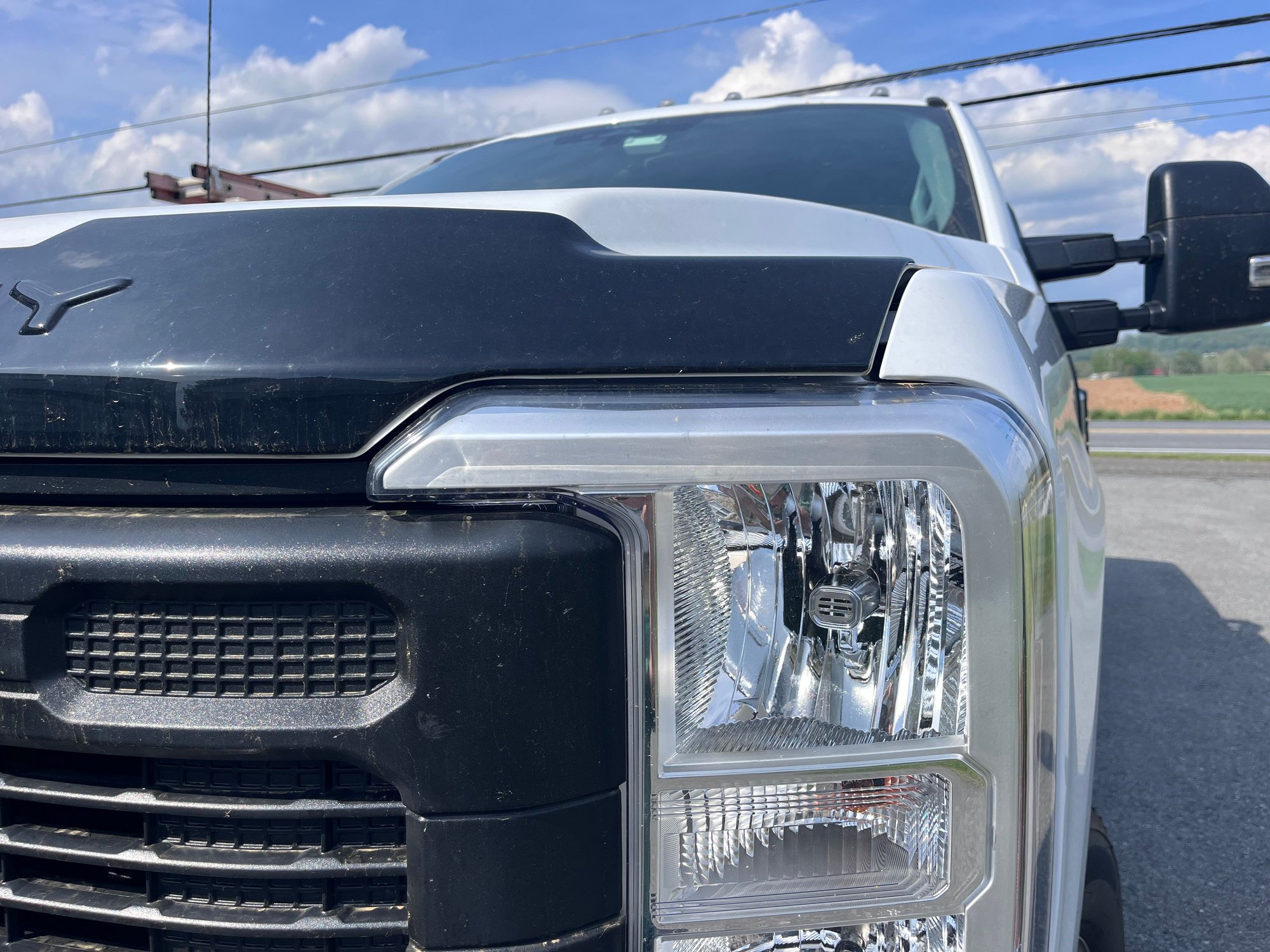

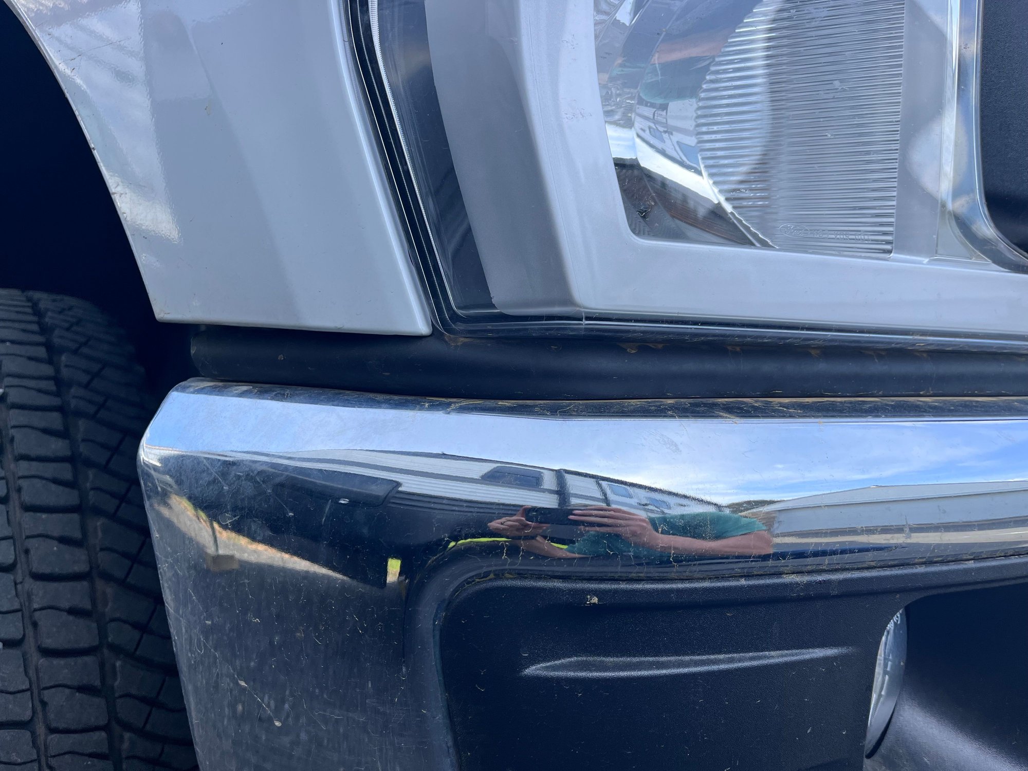

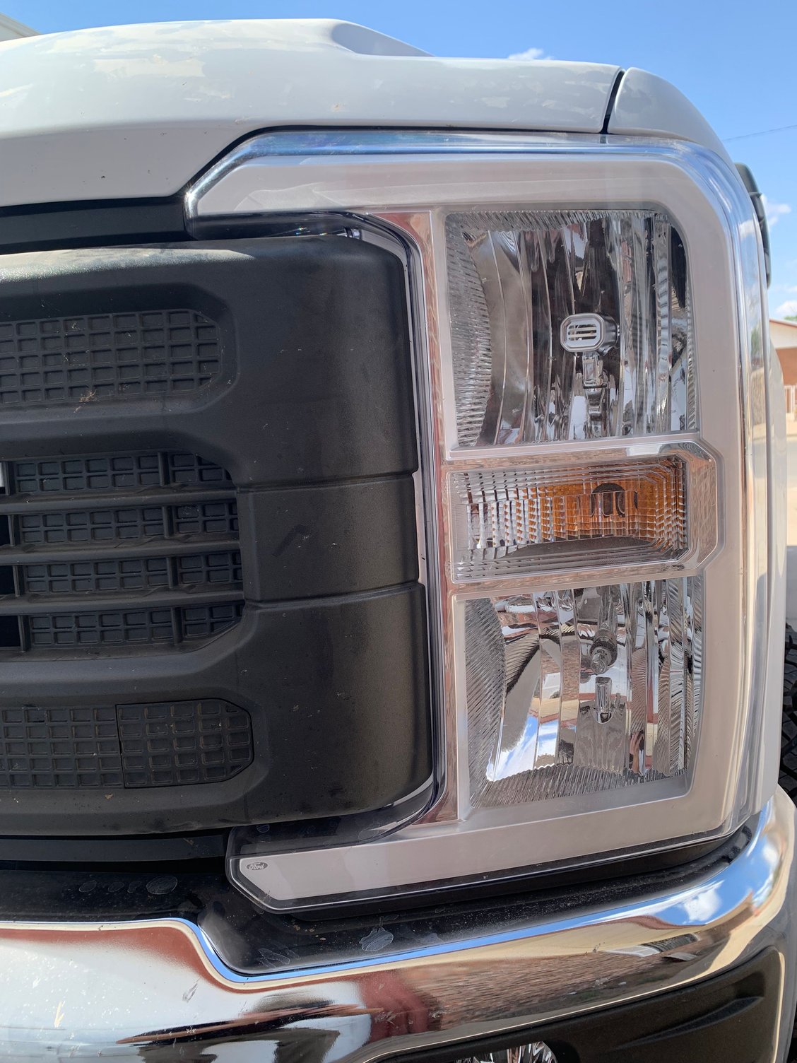

Hi all,
I have a 2024 crew cab long bed XL 6.8L that I bought new in September of last year to haul my family and camper. I’ve got 5100 miles on it so far and it’s been a great truck at this point. There have been a few minor things that I’ve had to over look due to my perfectionist nature, but there’s one flaw I’m looking for some advice on. The hood hits the driver side headlight when closing. Yes, I’ve tried closing it more softly. Even put it all the way down and just pushed past the latch. It still bumps and leaves a slight mark on the headlight. I noticed this right after buying it and the service manager where I bought it raised the stop slightly and we thought that had fixed it. Fast forward a few months and I’ve realized that it did not. I’ve talked to a more local dealer about it and they are willing to look at, the question is when exactly and will they actually fix it without screwing anything else up. I have terrible luck with things like this. All that to say, I’ve been looking around online to see if I could possibly fix this myself. It seems obvious to me and the the service manager and one tech at my local dealer that the headlight is up too high on that side, 1/8-1/4”. They think it may have gotten pushed when unloading. That puts it too close to the hood. Does anyone have any idea if I’ll be able to shift it down slightly? I know the grill need to come off and I’m comfortable removing that and the headlight. I’m pretty handy and do almost everything myself, just not sure how much tweaking might be involved here. I don’t know exactly what the headlight attaches to and if it’s adjustable or not. I know, it’s under warranty and I shouldn’t have to do this and I don’t want to, but I also don’t want the hassle that comes with trying to get someone else to do it.
Thanks in advance for any input!

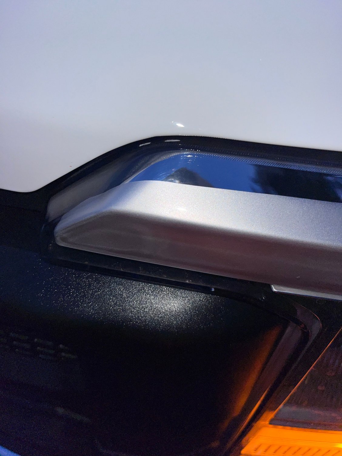

Here are some photos for reference.

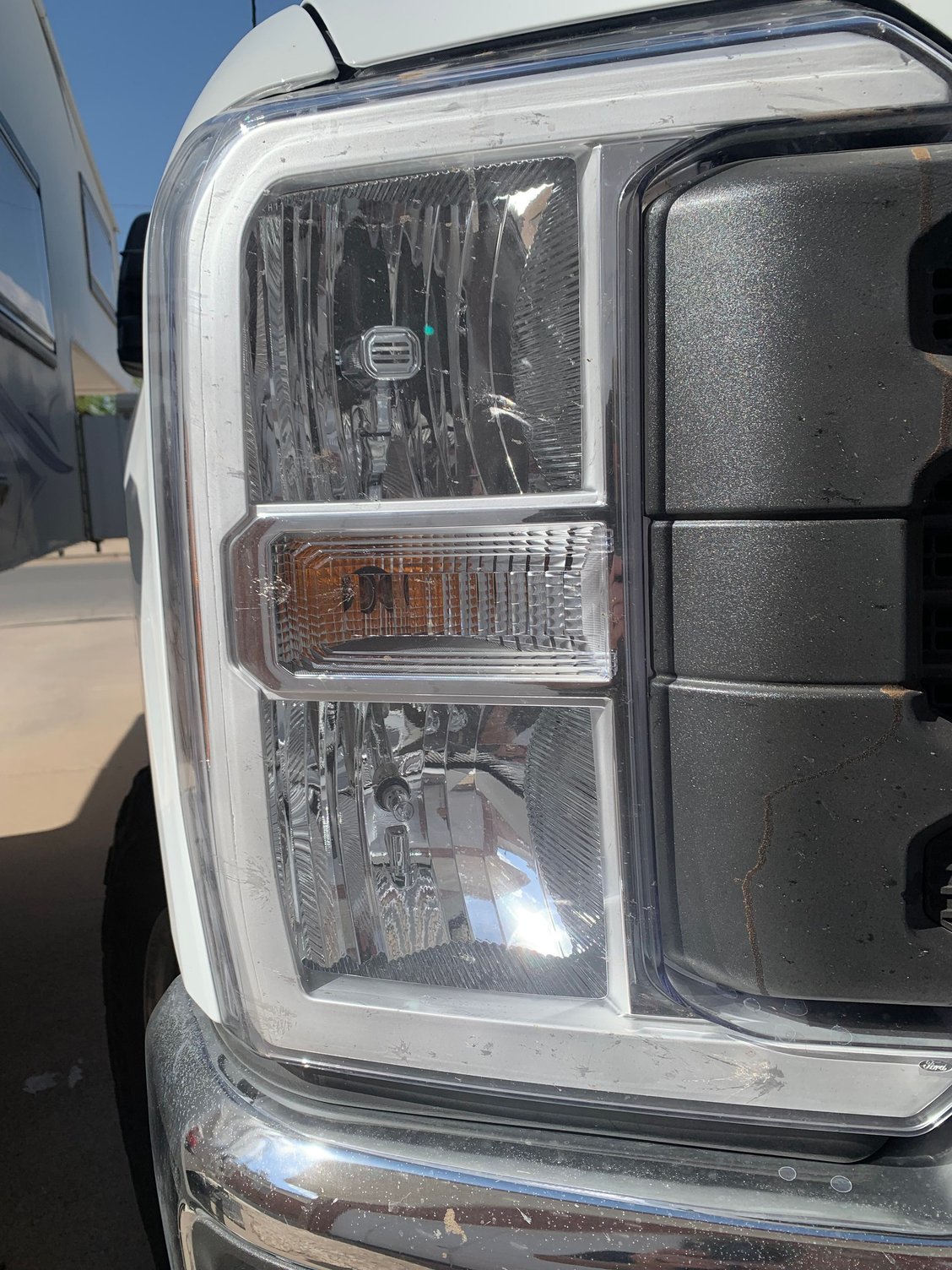

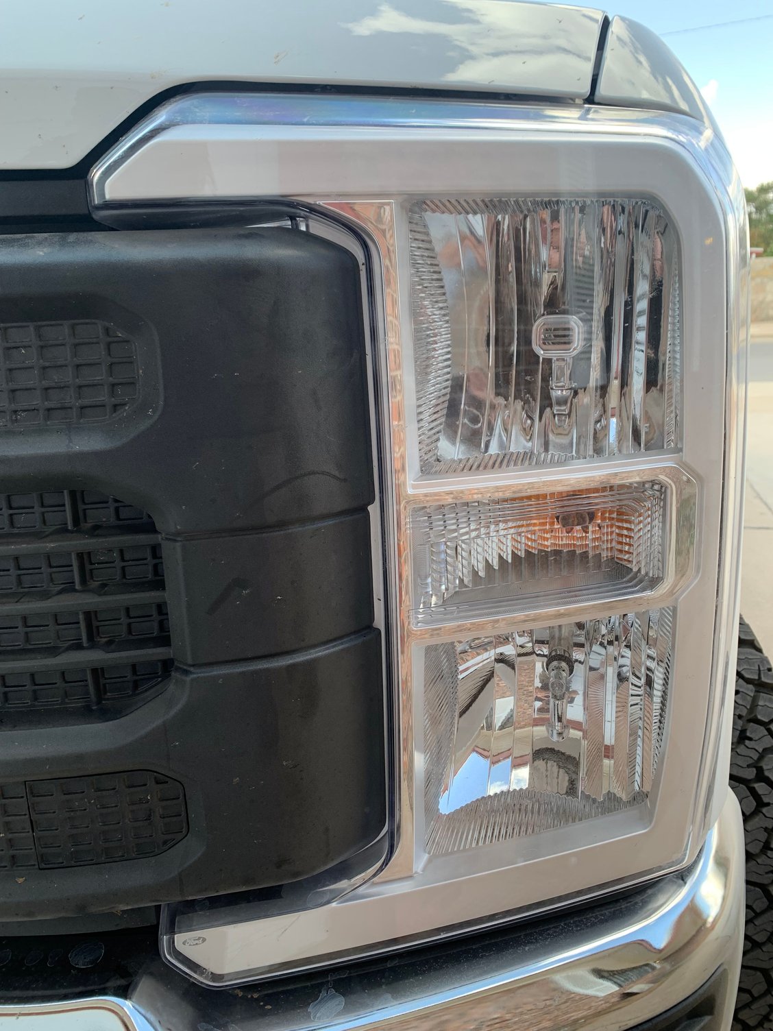

Well you got me curious about my 2025 F350 XL long bed CC 6.8 so I took a look at it.
Sure enough the same thing.
Top photo passenger side bottom photo driver side before.

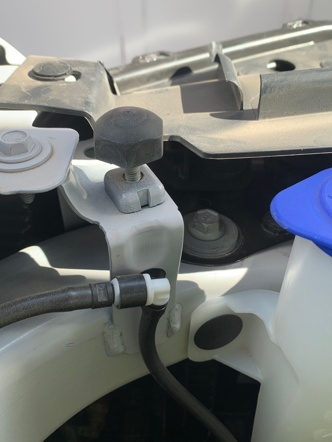

Made an adjustment with about four turns to the left of this adjustment **** with the black top.
The after photo.
I would think it would need to be checked once in a while from vibration. The **** moved easily with finger twisting and has no locking nut on it.

You might want to put a drop of thread locker, permatex purple low strength. on that bolt
The after photo.
Thanks for the reply! I’m sorry to bring something like that to your attention. It bugs the crap out of me. I think the gap on my passenger headlight is appropriate. I could live with the driver side too but it hits in the inside corner where it dips down, leaves a little mark on the headlight. Does yours leave any marks on the headlights? Both of yours look pretty tight. Definitely better after adjustment. That’s what the service manager did when I brought it up. Can’t go anymore though because the hood is starting to peek above the fender. I really like the truck and don’t want to be petty, but it’s frustrating to pay that much for a vehicle and have the hood actually hit the headlight.
No there is no marks yet thanks to you pointing it out. Probably would have if more time went by.
Yea unfortunately I think yours may need additional adjustment on the headlight. It should be an easy fix.
