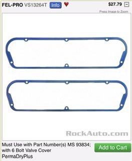

What type of gasket did you use? I use what Ford used- rubber/silicone with a steel core like these

I believe it was the rubber coated cork style. this was done 7 months ago... I ran my finger around the perimeter of the valve cover and could feel the gasket..no bulges. anything is possible I guess.
So these type gaskets go on dry then?

Probably. Were there installation instructions?

the shop in ottawa did the valve cover gaskets just after I got the rig. I was working at the time. will look into the felpro silicone with the steel ring.
thx

Make sure there are no cracks in the metal around the bolt holes in the valve cover
The factory Ford metal and rubber gaskets do work well for years and years, if your valve covers were designed to use them
They must be perfectly flat to use those gaskets

From my experience, don't waste your time with the cork gaskets or really any other ones besides the silicone steel core gaskets, they are pricey compared to a traditional set of gaskets but well worth it.
I used them on my oil pan and valve covers, even properly torqued they became oil soaked and just leaked. I picked this one up from the local parts store. https://www.oreillyauto.com/detail/c...r+gasket&pos=0
