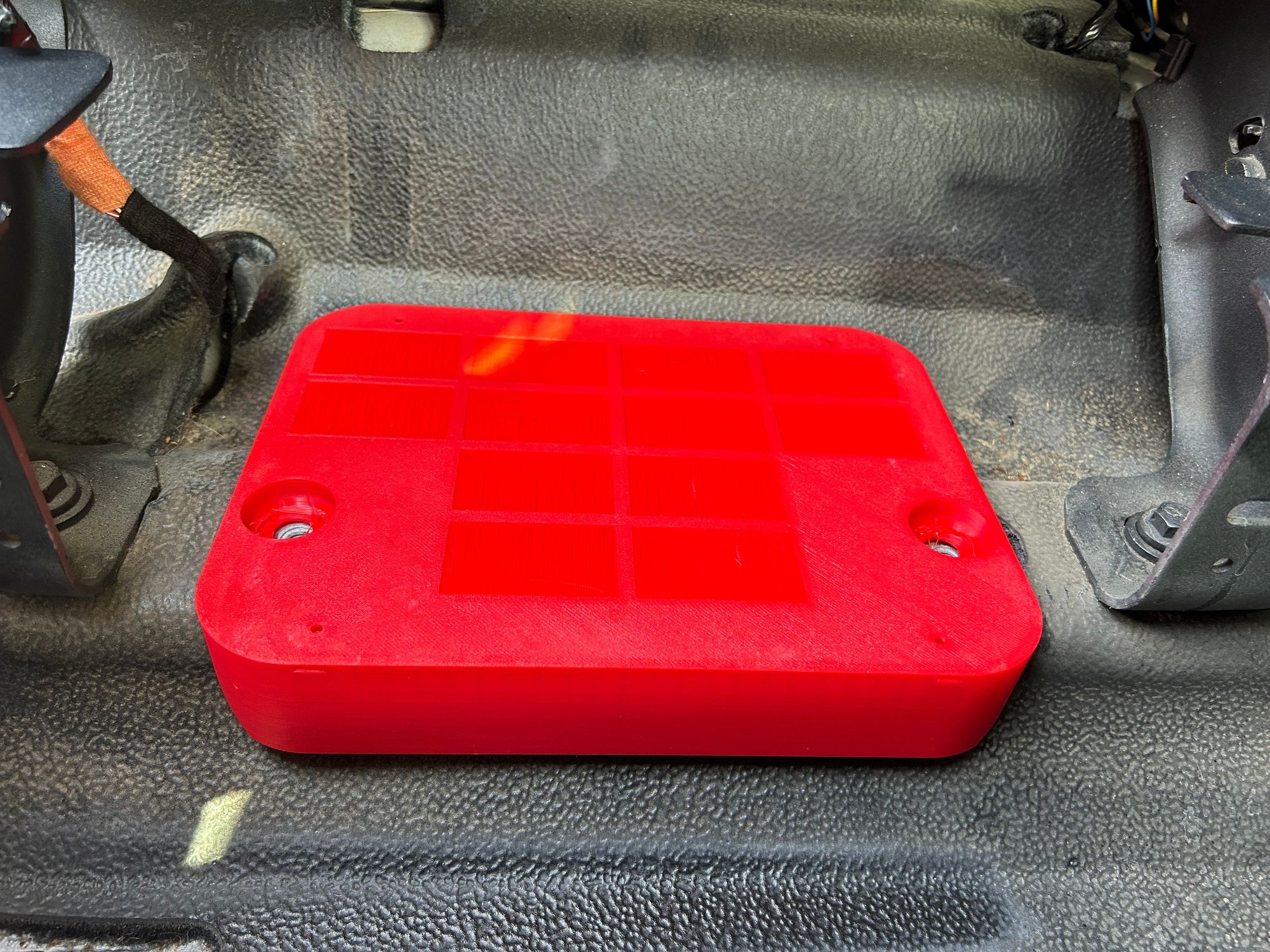

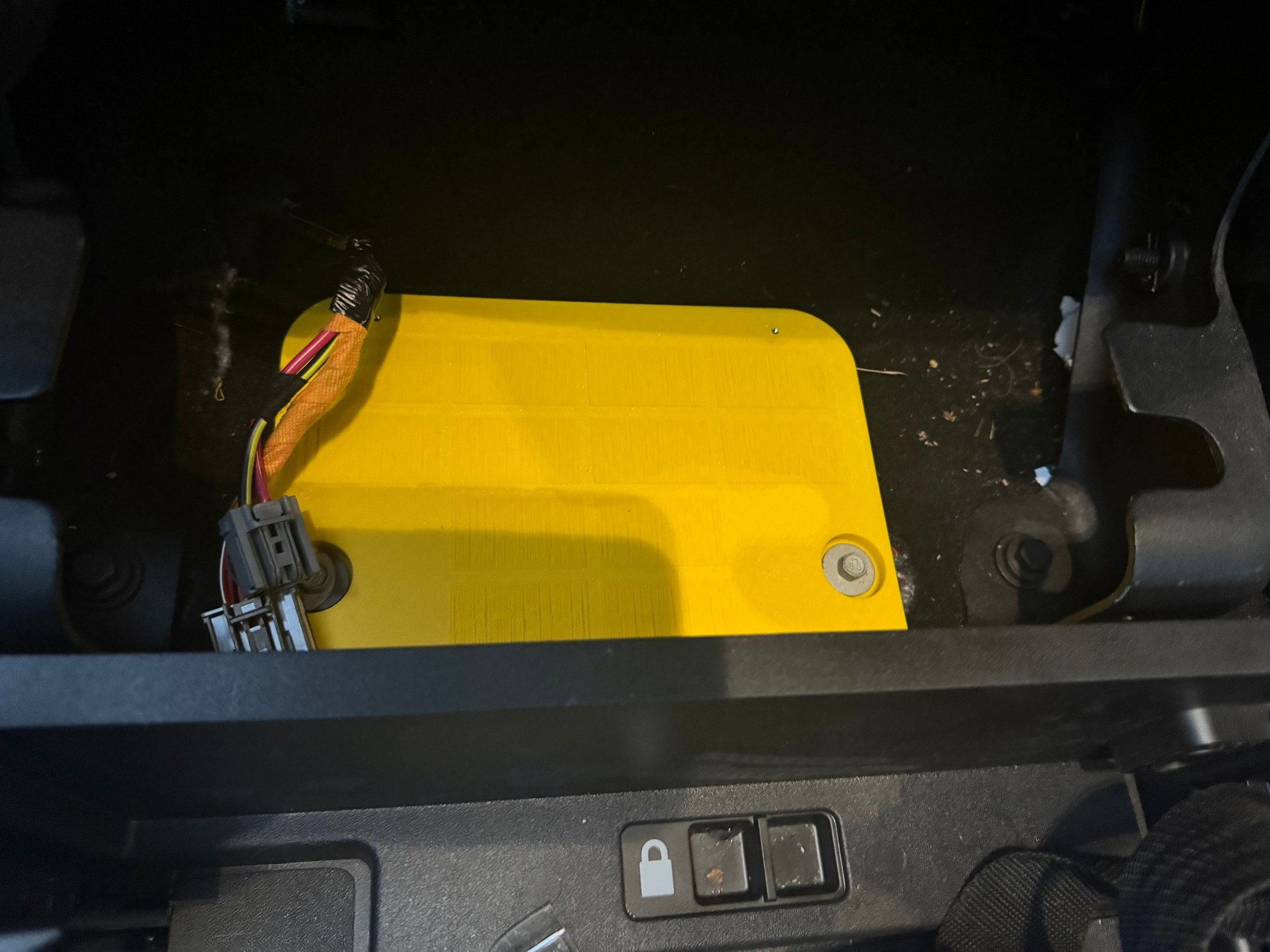

Recently replaced the Inverter in my 2022 F-250 with a relatively like-sized inverter. Managed to do a zero-cut install and 3D printed a mount for it. Not the cleanest wiring I've ever done
Pros
  • True Sine Wave
  • Much less RFI noise due to better design (Ham radio operator so this is important)
  • Much more well built and can handle inrush current of devices with large capacitors (85W+ laptop chargers) without tripping out like the stock one
  • Zero power draw when inactive - wired the ignition signal to the remote high input on the inverter to facilitate this
Cons
  • Lose LED functionality
3D Model for mounting Plate - https://www.printables.com/model/128...er-mount-plate
Inverter - Victron Energy Pure Sinewave 12V/500VA 120VAC VE.Direct - Direct Output (Not GFCI)
Battery Feed Connector - https://www.mouser.com/ProductDetail/272-7282645840
Battery Feed Pins - https://www.mouser.com/ProductDetail/272-7114412202
AC Output / LED Connector - https://www.mouser.com/ProductDetail/538-34772-0140
3D Printed Bracket
3D Printed Bracket
Finished Install
Finished Install

Couple pics of the mount for anyone that is considering this.
