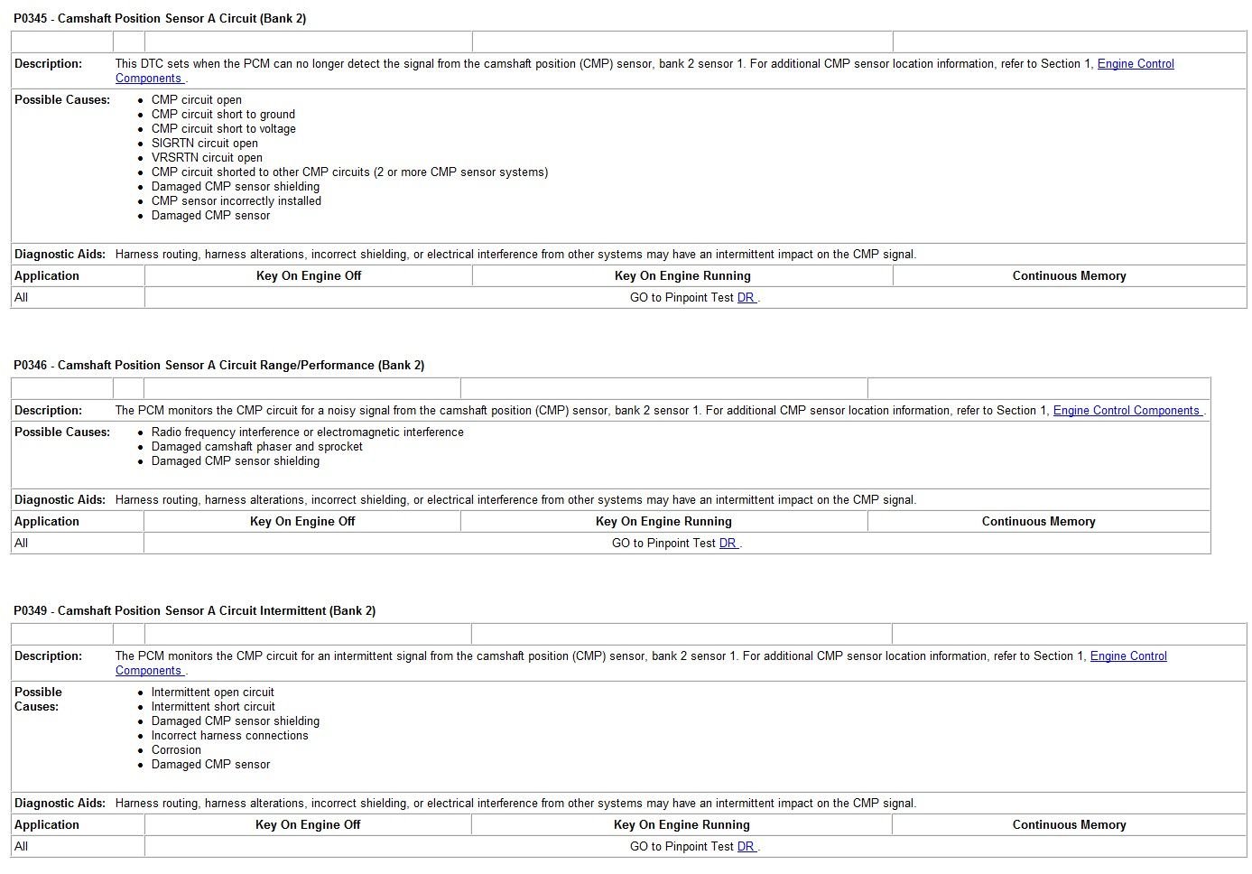

Going by that code and the symptoms, I'm leaning towards timing chain issues such as cam phasers and such. Sensors don't typically go bad, they typically tell you what system is having issues that then need to be diagnosed. Looking at everything so far, and if the engine has anything close to 100,000 miles or better.
If you'd like to be certain, you'll need to run the checks on the electrical part of the system to rule that out 1st. You can find all the test procedures for the truck from the Ford shop manual.

So I actually just went and pulled thecodes myself and along with the 0345 there is also a 0349, if that sheds light on anything.

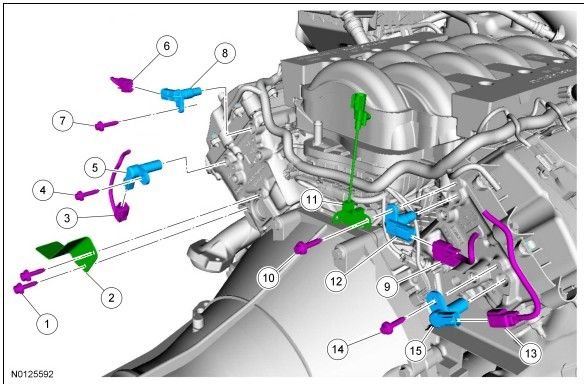

This is where you need to be.
#5 and #8
Fortunately for you this would be the driver side head where the two CMP sensors in question are located. Forget about that though, 1st check all the wiring for rodent damage, previous owner butchering radio wires, etc... if nothing is obvious then you need to get the manual I linked and run the pinpoint tests to make sure you control what happens to your wallet.

I really appreciate your time and advice, however my son and some of his friends had already unbolted everything got the motor pulled forward and removed sensor A bank 2 which is what the code called for and sure enough it will not ohm out lucky for him I guess. I was actually betting on the tensioners. He and a lot of his buddies have these f150s around here so they are getting practice, LOL.
