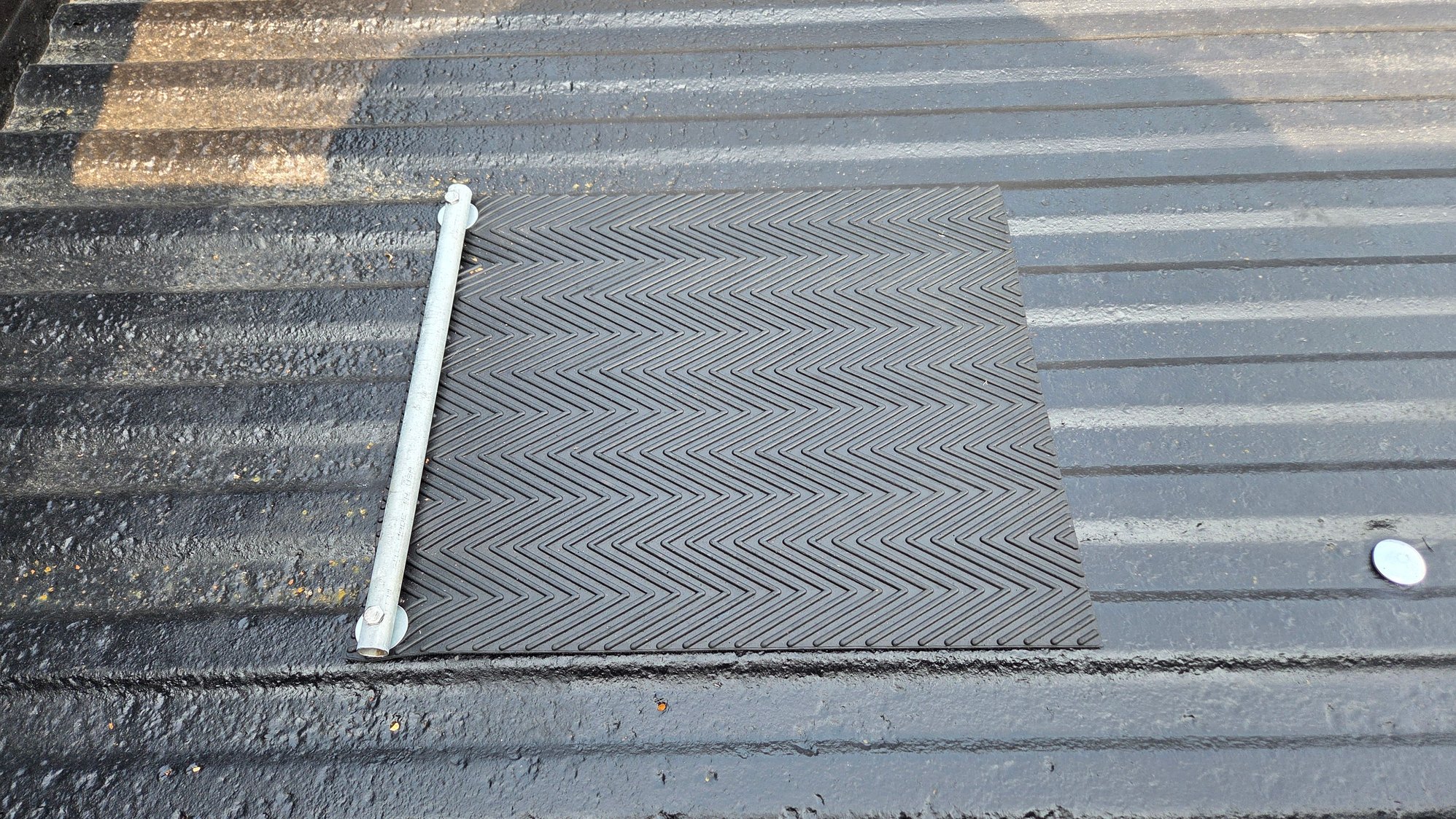

I originally intended to have it come out above the frame in the wheel well, but it took forever to put gas in it. Ended up cutting a 5" square hole in the box and will be installing a door with truck bed floor material.

Finally got the door installed, a hinged rubber mat. I know it may be chessy but it gets the job done and spent less than $5.
