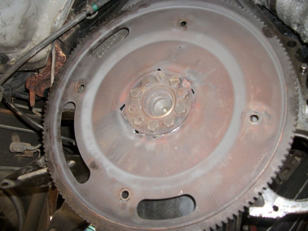

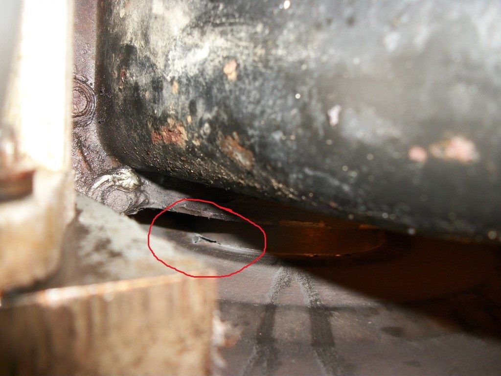

I don't hear anything, but a cracked flexplate sounds like you threw a rod bearing. It cracks like this:
That happened on my F450, many years back now. Had me worried, until I remembered it could just be the flexplate. Once I got to the job, I got under and took a look (after stopping to check the oil) and I saw that. Needless to say, I was very relieved. Tom's right. Sound goes right away under load, but you'd swear she was coming apart on deceleration.
