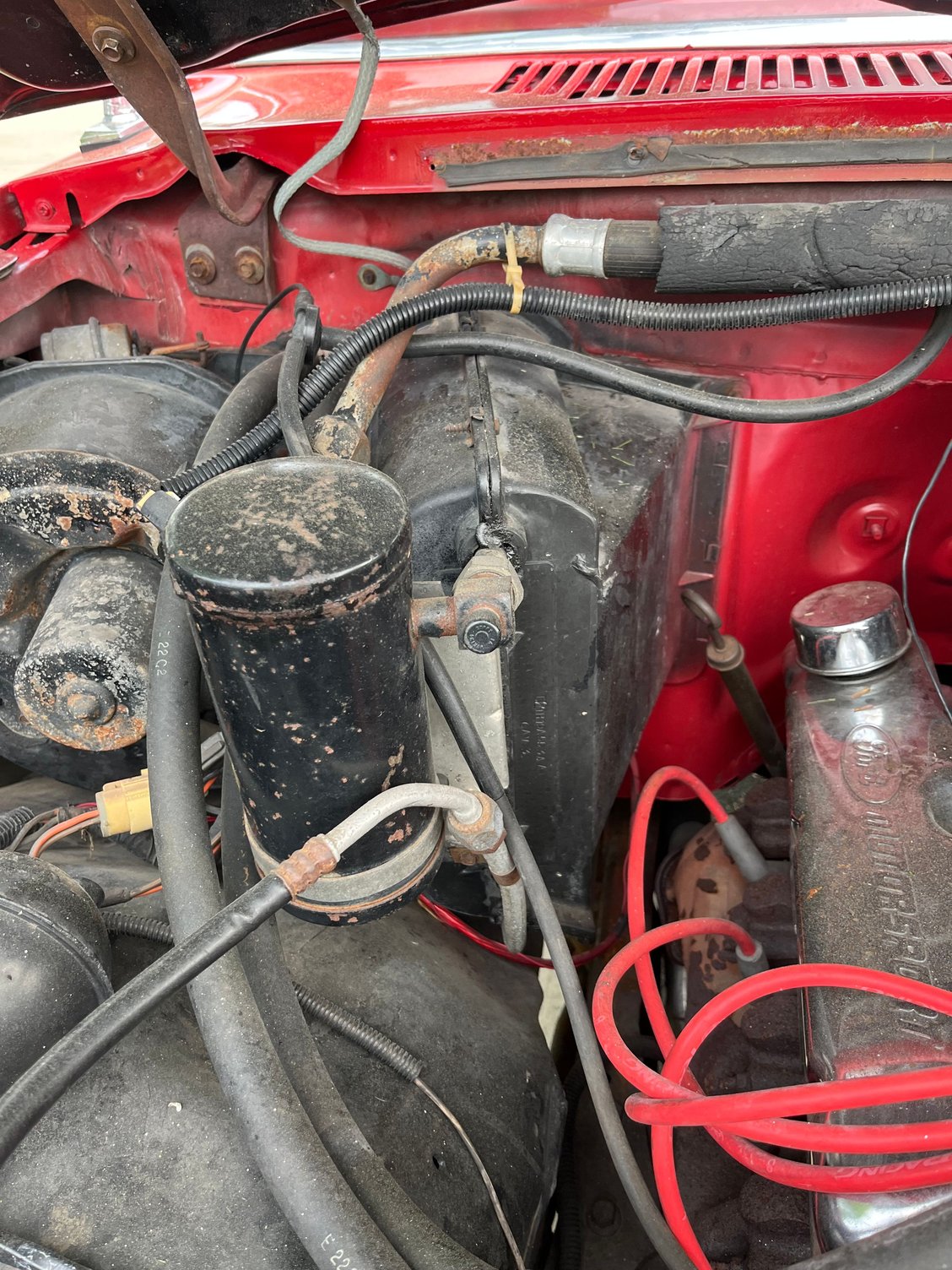

okay, here’s a pic of the firewall. What do you think?

That's definitely factory AC, so parts will be a lot easier to source.
These trucks are very prone to collecting leaves and other debris between the fan and evaporator. It's bad enough this reduces airflow, but the resistor pack for the fan motor is located there and it gets red hot in use, creating a fire hazard:
https://www.ford-trucks.com/forums/1...n-the-cab.html
It's easy to pull the fan and resistor pack for a quick inspection. You can clean out the area to some extent through those openings, to at least eliminate the fire hazard.
The face of the evaporator is prone to blockage, too. All air passes through the evaporator, even when AC is off. It's a little more work to access, but not too bad:
https://www.ford-trucks.com/forums/1...om-heater.html

The evap is not hard to replace, just remove 1 half of the housing and it comes out.
Being the system is open, no compressor, I would pull the evap coil for a good cleaning.
Unless you see signs of it leaking, oily spot, I would just clean it and housing the reuse it.
I moved the box from 1 truck to another and thought I cleaned it good before the swap.
Well a few years later when I changed out the evap coil I could see I did not get it as clean as I thought
Oh I can tell you the truck was not outside to get the dirt I found.
While we are talking of cleaning clean out the cowl area just in front of the glass of leaves and other junk.
Then inside remove the 2 kick panels at your feet and then the 4 screws holding the metal plates in place.
Now dig out all the mudd and dirt in there to the bottom. This is what rots out that area of the floor and cab as it is always wet.
There are "duck bills" on the drains, 1 each side, make sure they are clean. You may want to run water down the cowl on each side to flush it clean and make sure the drains are open.

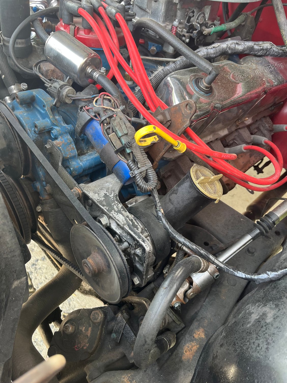

I see from your pictures the evap / drier area and lines. What do you have over by where the compressor would be of the 2 lines there?
