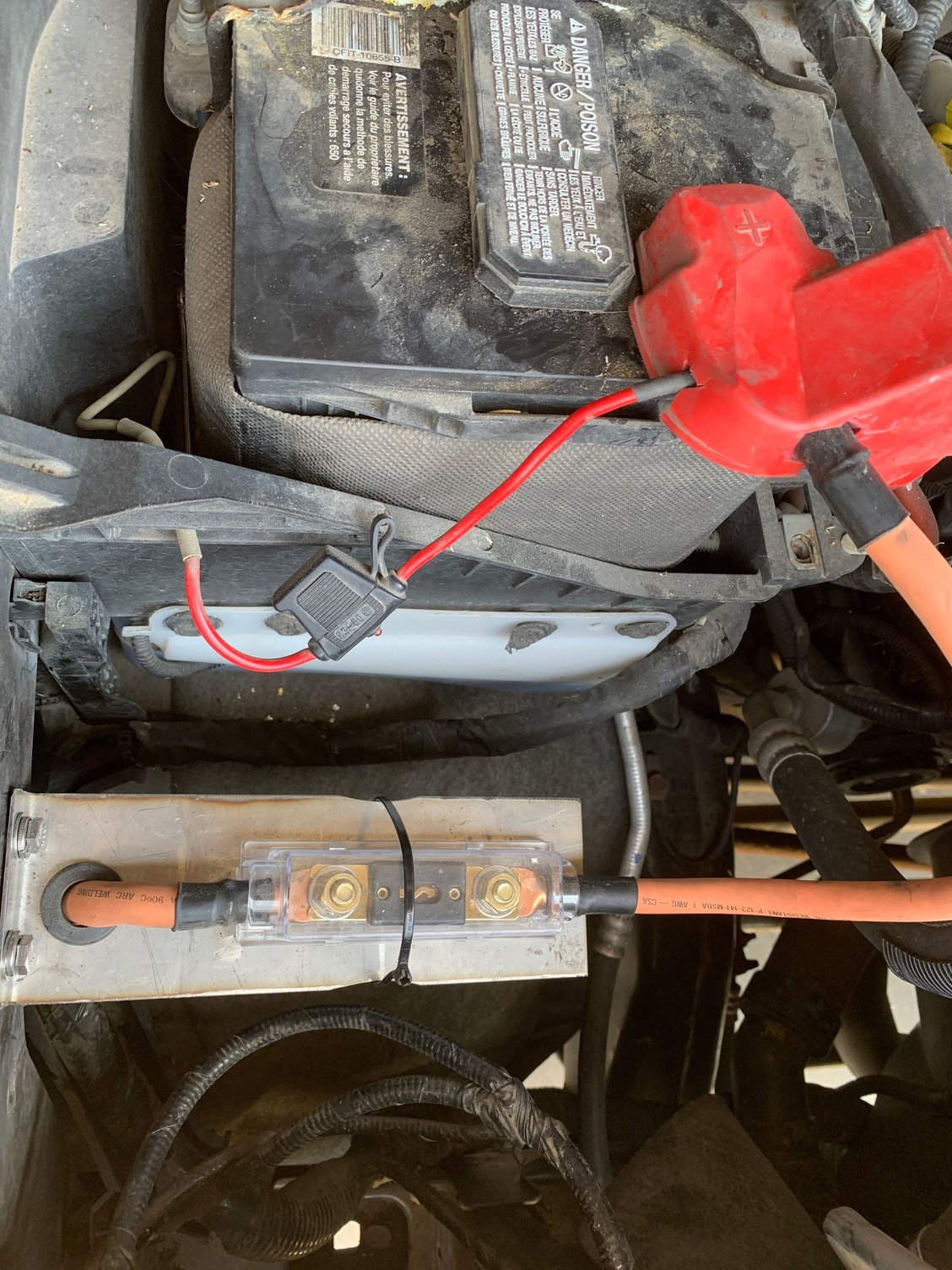

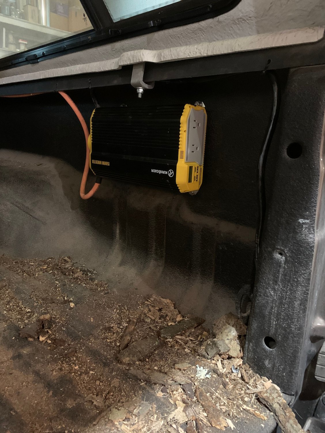

  1. If you do not have the inverter, this is how I installed one in my now gone 2016. I took it out prior to trading it. Ran cables directly from the battery. You can get aluminum blind nuts and bolts to mount it. As for the cover on your truck, I would remove it and have it coated separately.
