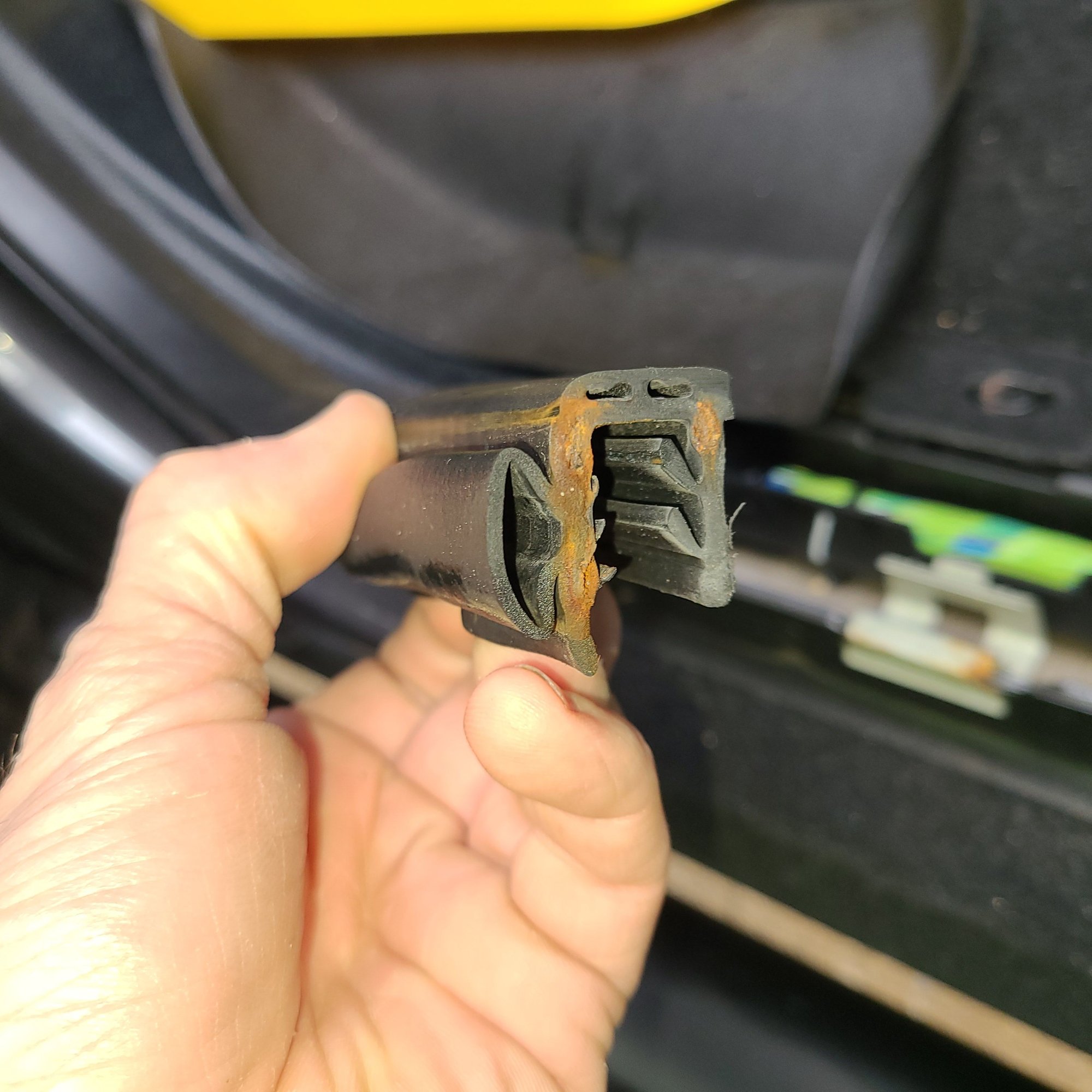

So I pulled up the driver's side door channel cover and found evidence of water intrusion. The passenger side looked clean

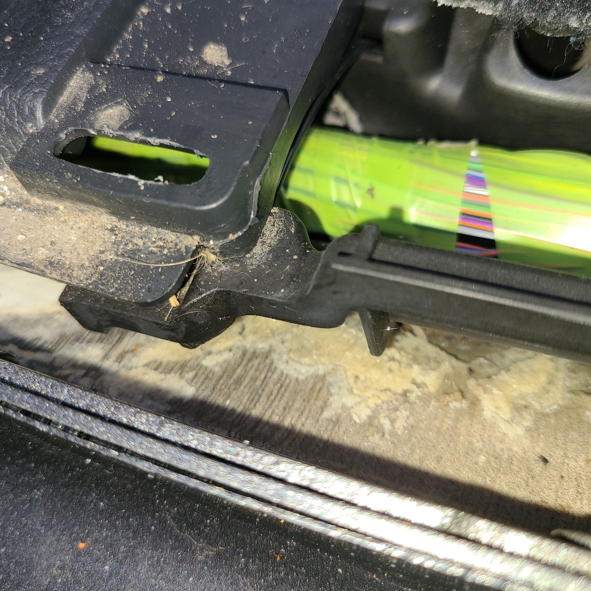

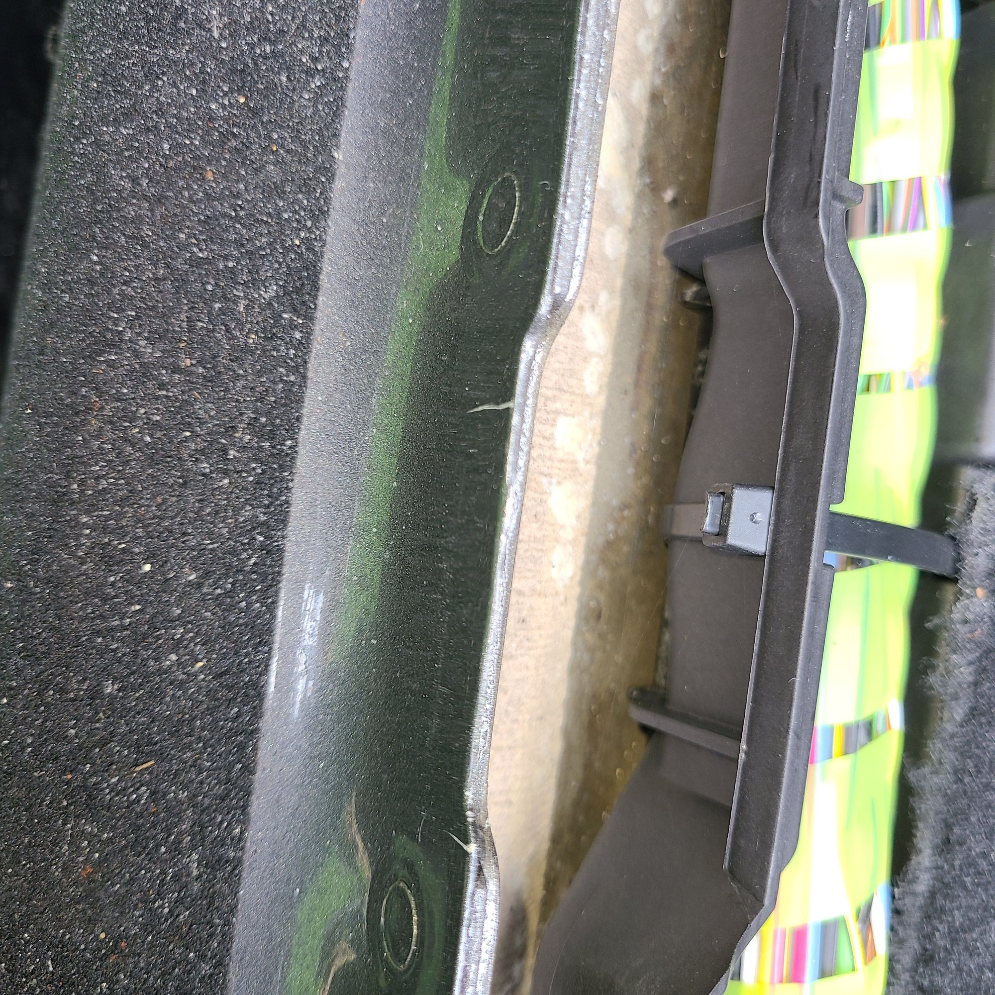

Driver's side rear door channel.

UPDATE. I found the source of the smell. It's the fabric mesh that pops up when the sunroof is open. Apparently water is sitting up in that channel and the fabric is absorbing it and that's what's turning into mildew so now I need to figure out how to remove that mesh to wash it and then look at the drain tubes to make sure that they are open. I'm wondering if that's how water is channeling down into the driver's side door c hannel
