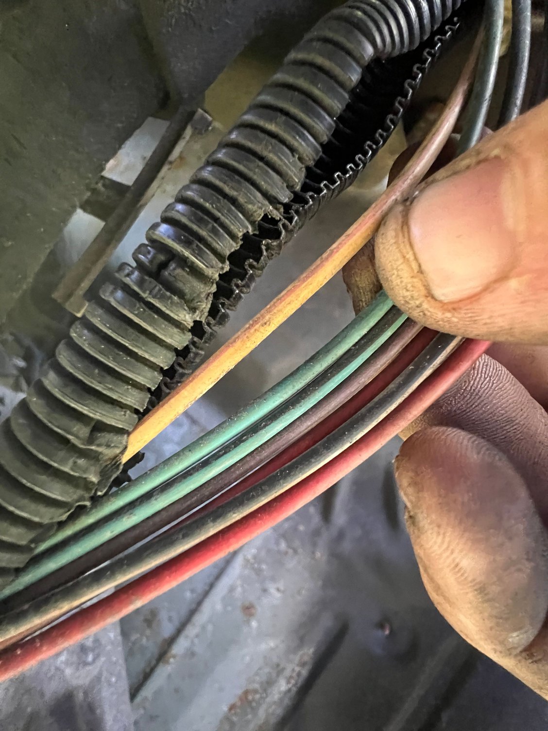

i have a AOD trans and I figure my switch is the problem since I have power to the harness that goes to the switch and I figured that since I have a 5-wire harness that the 4-pin switch wasn't meant to be there and the last owner who had it messed with a bunch of stuff that I'm fixing as well and I checked my harness earlier and get 12 volts when in reverse at the plug side of the neutral safety switch, but can buy a 4 pin to see if that fixes my issue.
There are 7 wires total in the loom but only 5 got to the neutral safety switch. The 2 blue wires go to a separate plug that’s capped off, and the wires that go to the switch are red/light blue stripe, red/yellow stripe, purple/orange stripe, black/white or pink stripe(the stripe is kinda faded), and yellow/pink or red stripe(also kinda faded)

The switch is on the transmission but you still haven’t told us what transmission. How do you have a 5 wire harness but it had a 4 pin switch? Why did you go with a 5 pin and not replace it with another 4 pin to match what was there? How did you determine that the switch is the problem?
I posted a reply saying what trans I have and a photo of the wires that I have coming from the harness that goes to the switch and the colors of each wire as well.

If you do not have the electronic shift transfer case only 4 of those pins are used. Purple/Orange and Black/Pink are used for the reverse lamp circuit. White/Pink and Red/Light Blue are for the starter circuit. The remaining Red/White wire is for the electronic shift function. The NSS case provides a ground path for the electronic shift function.
