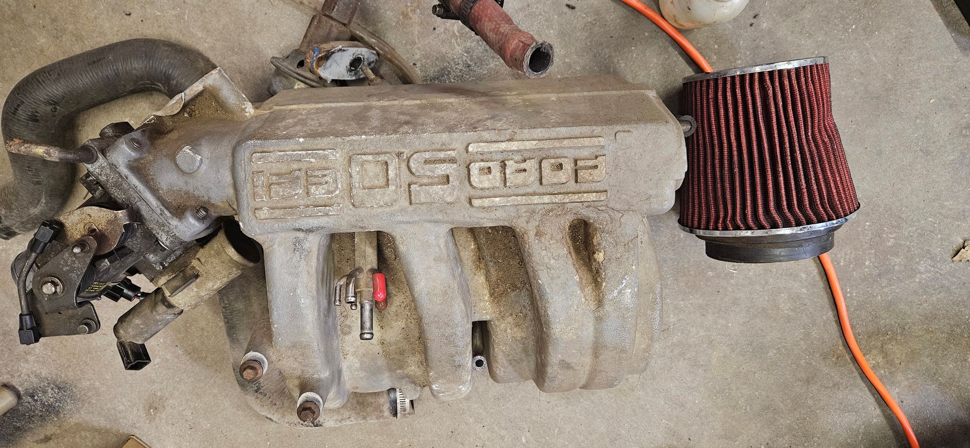

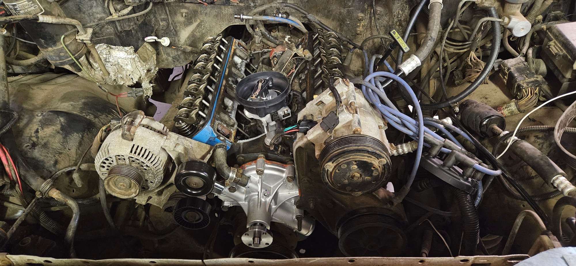

The only way I knew about this controller was to take the controller box apart to find who built it. When I got the truck, I started it up before I bought it and it kinda ran. So I got it into my shop the next day. I started it a few times but it would die and not start again. The previous owner had installed a valet system on it, The kid didn't know what it was, only that the key fob would unlock and open the doors. I thought maybe it had a fuel cut off portion but it didn't. The door handles are shaved off btw. Thats when I saw the aluminum box hanging down behind the pedals against the inner firewall. I took it apart to find that it was a baumann controller I replace several sensosrs and fuel pressure regulator and I did get it to start right up. I got a code reader and replaced several items/
I amTrying to get clear pictures but I don't have it on my lift yet. The new lower intake was only because the egr fitting in the intake was stripped out and held on by jb weld. So I found another lower intake with matching serial numbers. I guess I could have just had the port welded shut...but I didn't. So now its just trying to find someone that knows about the controller, how it works and if there are any programming things that canbe done if it ever needed that in the first place.

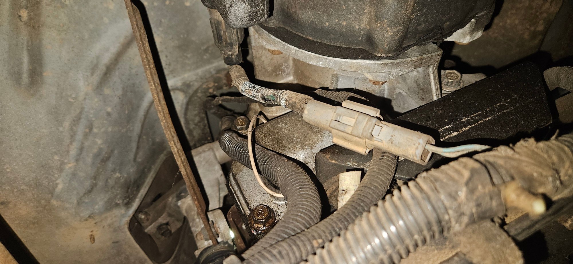

one plug in to the trans

cleaned a few lifters that wouldn[t pump up but also to change lower intake mannifold

I hope you didn’t spend a whole lot of time in that search. All of the 5.0L truck upper plenums are the same. Early plenums did not have the displacement on them but instead had “electronic fuel injection”. Later intakes did not have the PCV port in the back.

Intake runners look small and stock. Could have an aftermarket cam but hydraulic flat tappet lifters. I will check vacuum on it at idle when I get it running and see what the compression looks like. I see there are cams offered for this stock 5.0 efi system. I am not sure how much a stock efi can handle though. It might be a low end cam, more torque and smooth idle. I can try to check the cam lift at the lifter. I have a lot to do apperently.
50# for a 302 is too high. It should be 30-35# and max out around 45#.
You have the valve covers off so what is cast into the head? Stock for that year should be an E7 head.
Entirely possible that someone replaced the cam and lifters.

Can you post a picture of the lifter valley with all the stuff removed.

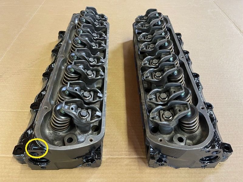

Also look at the top outside corner of the pass side cylinder head and post up what letter or number is cast in. See yellow circle in the pic below.
