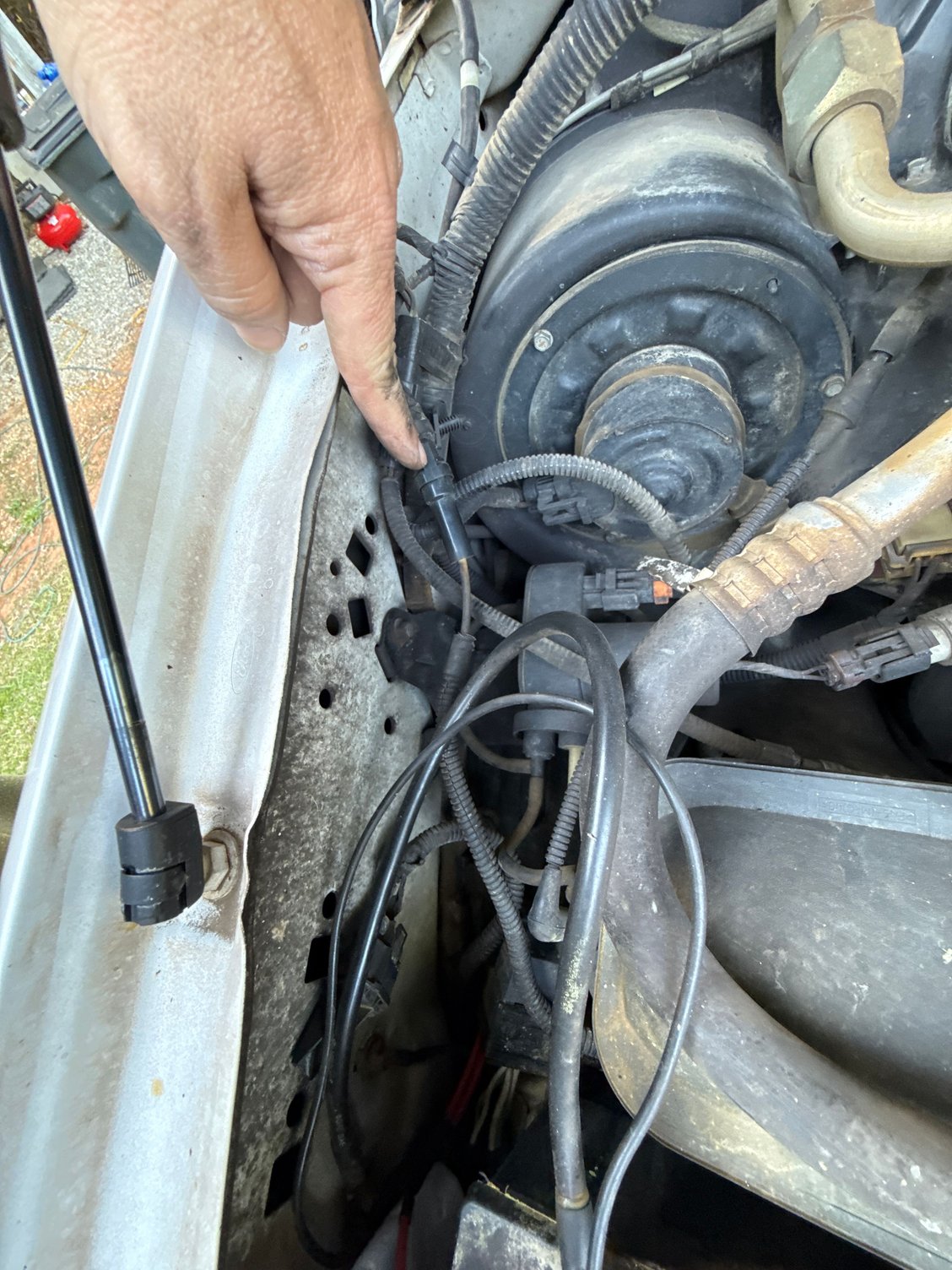

Today as I started my truck, 2003 F250 CCSB 7.3l, I noticed a noise that sounds like starter is still engaged while truck is running. I have attached a video so if any one has experience or opinions chime in. Sounds like starter solenoid is engaged to me. iCloud link to video

Took this solenoid jumper and touched to battery positive and it started turning engine over as it should. When I took it off engine continued to turn over with no key in ignition. Had to pull battery cables again.
also tested current through solenoid. Zero volts with key off. Had wife start truck while I was under with voltmeter on solenoid and ground. Voltage of 8.5-9v truck started and after 3 seconds she turned truck off. Truck quit running but voltage to solenoid continued at 8.5 and starter continued to turn over engine.
im at a loss on what else to check.
