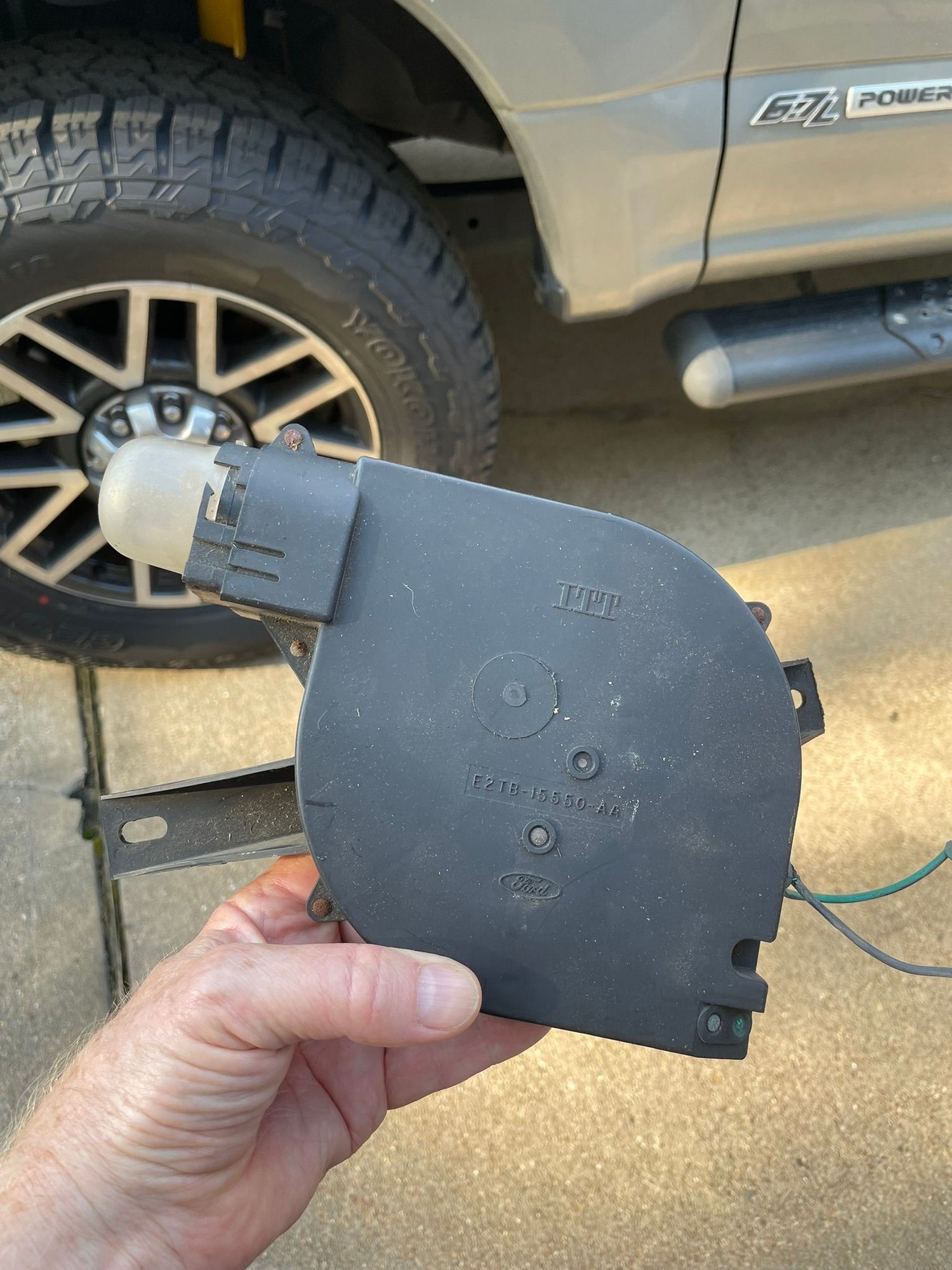

Ha! That reminded me of this one. I think it came out from under the hood of my Dad's '83 F-100. It was a XLT Ranger package if memory serves. It's self retracting and I think may have a mercury switch inside to turn it on when you open the hood. I'm afraid it would burst into flames if I tried powering it up to test now though.
