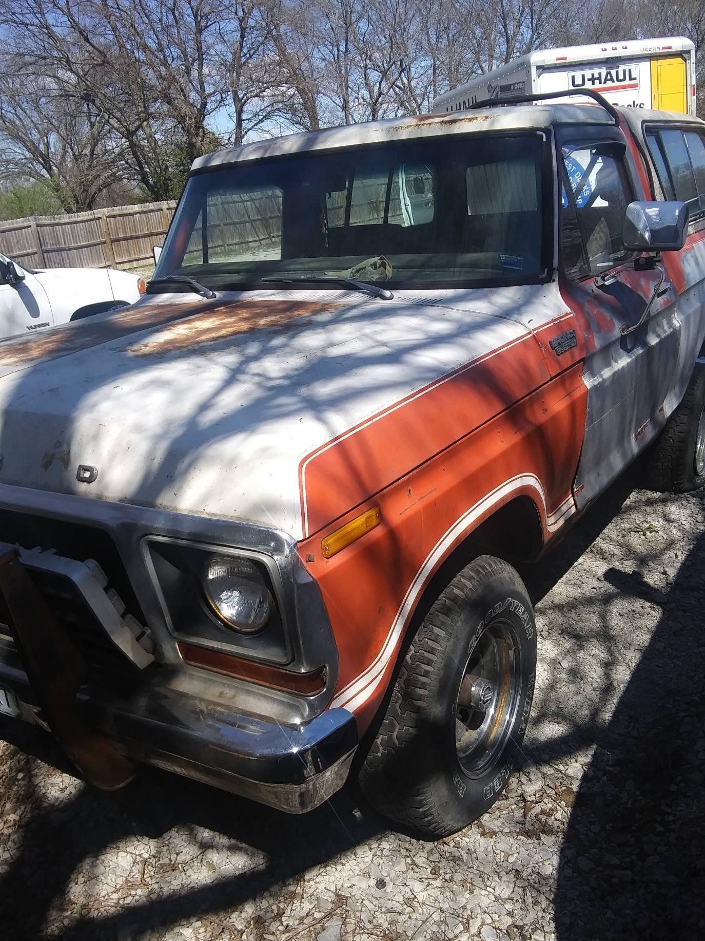

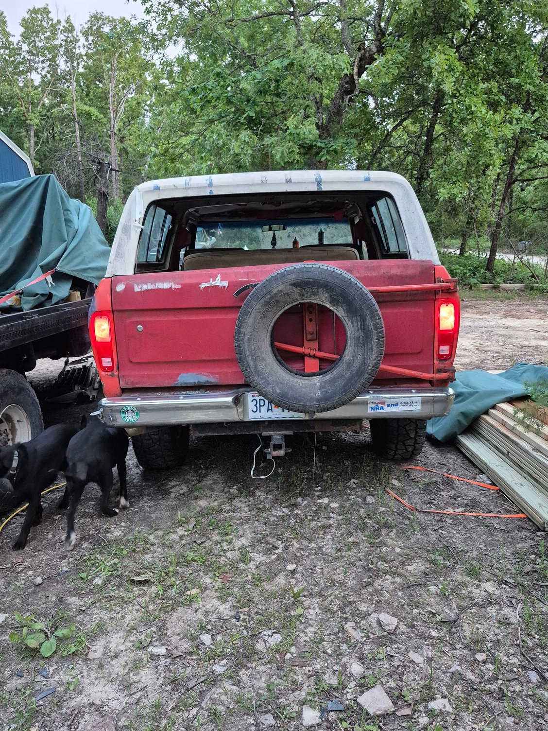

This is kind of a long convoluted story, but it is what it is. I've had this 79 Bronco 2002 or 2003, either way it's been longer than I've had kids. It's survived one divorce, 4 kids and me in my early 20's getting drunk & going out doing young guy dumb stuff.
This picture was taken maybe sometime around 2017.

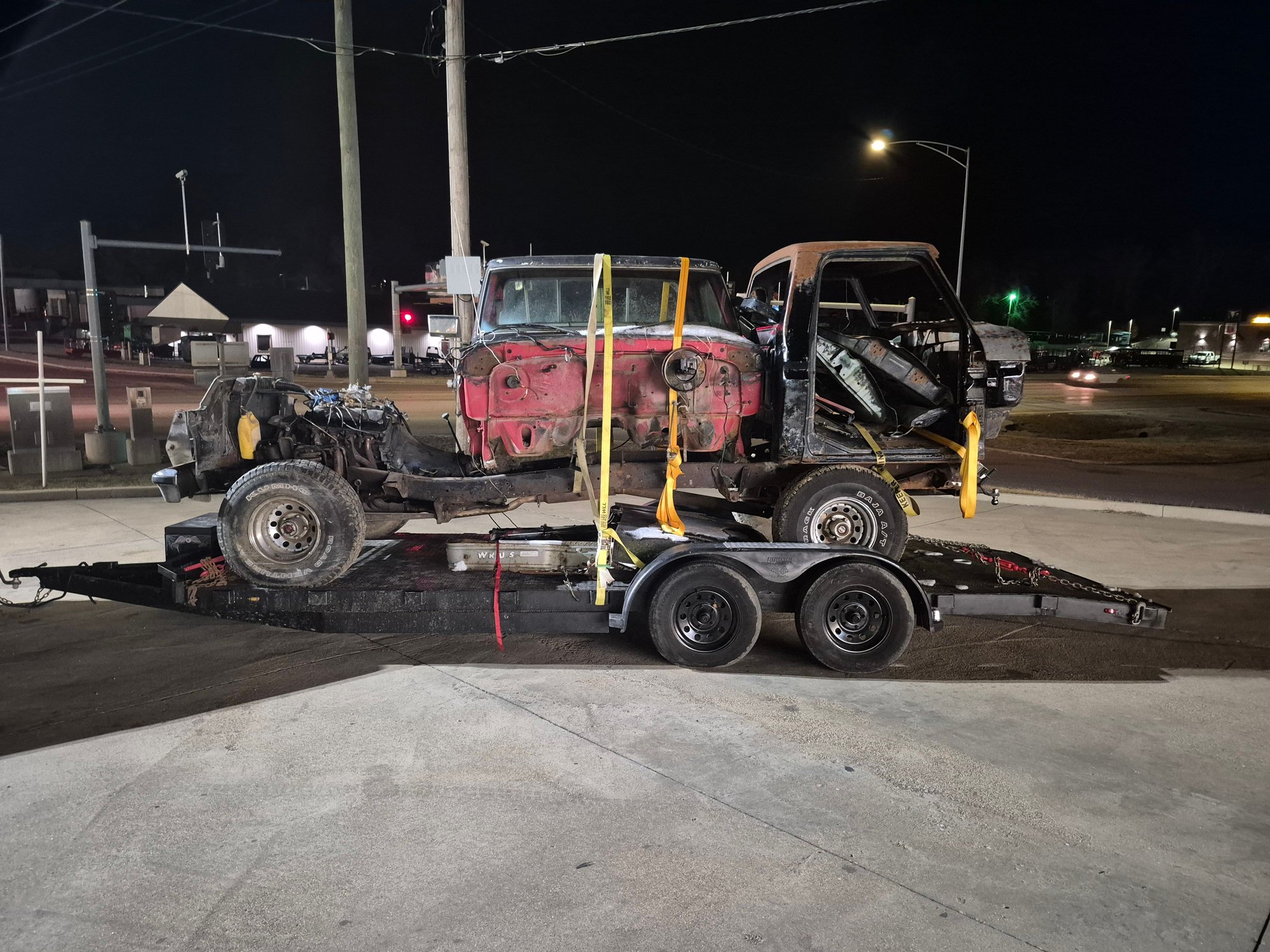

Another few months go by & I get a call from the wrecking yard asking me what I wanted done with the Bronco. Still in my name & my plates on it. I related the whole story yet again the the yard owner. I asked him what would likely happen to the truck & he said that he'd most likely just crush ot after he got an abandoned property title or whatever it is they call it in Oklahoma. Well my wife had been upset with me for sell the Bronco to being with, she loves that damn truck. So I asked if I could buy the rig from him once it was legal for him to sell it, he said to give whatever time period is required in Oklahoma for to that legally (and if the a**hole showed up to claim it, but we both knew that wasn't gonna happen) & if I'd cover the lot fees for that time frame, he do it & wave the original tow fee.

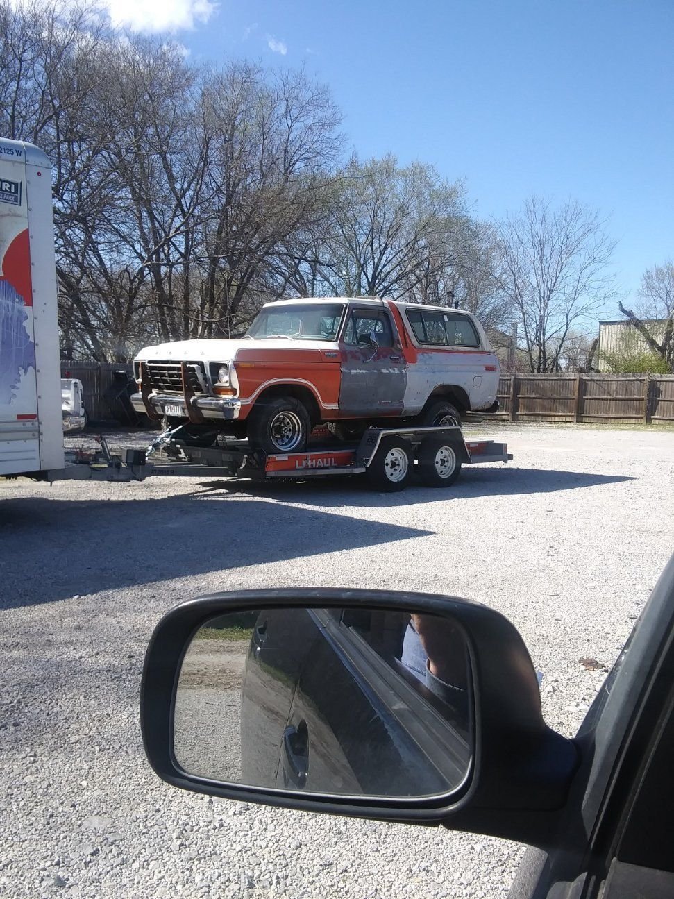

So another couple of months go by & then we brought home the Bronco, again. Had to rent rent a uhaul trailers because mine was to narrow & then a uhaul truck because my little Cj5 sure as heck wasn't about to make that tow. Got home & got it legally in my name again.

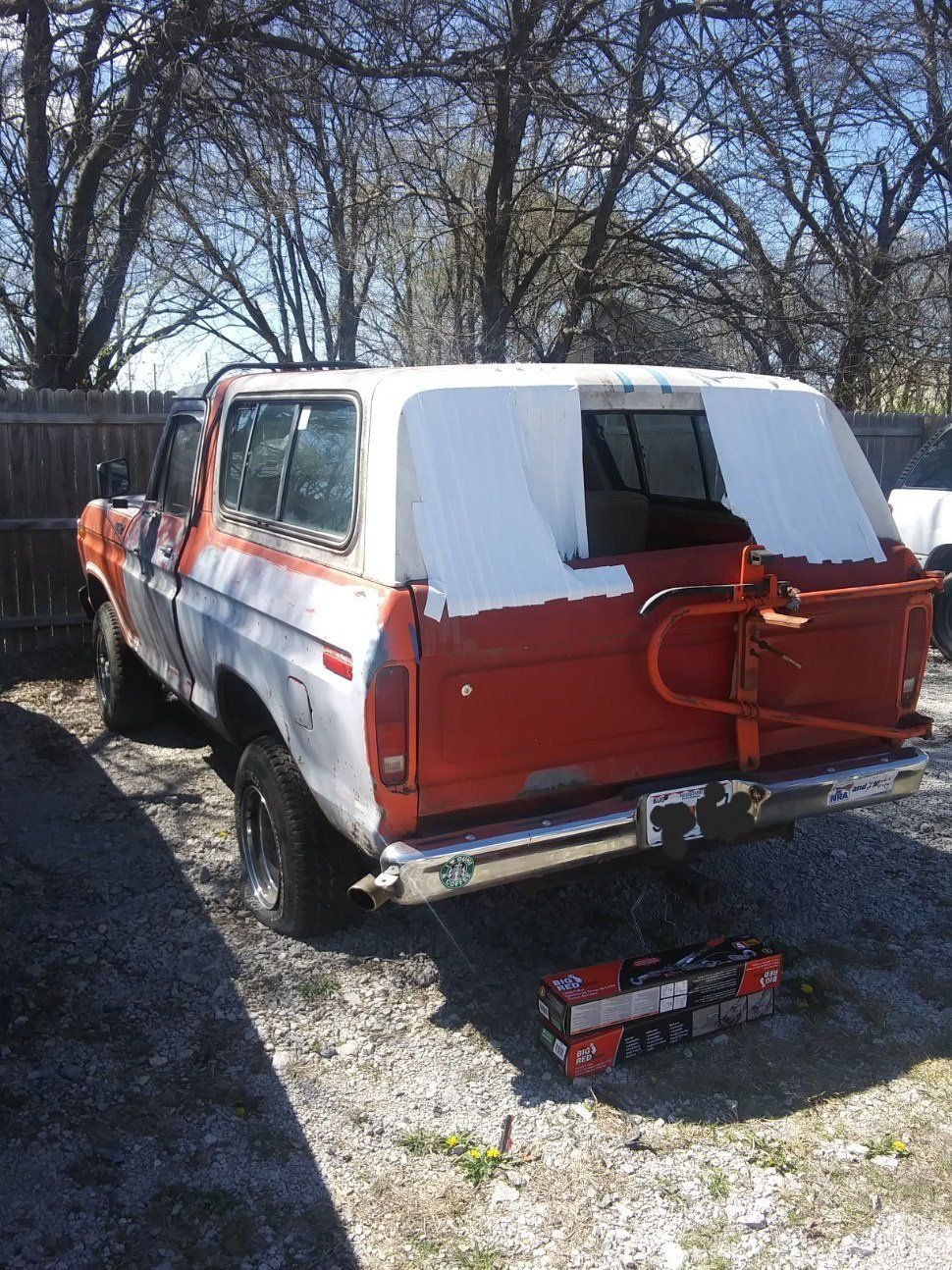

The dude had been pretty brutal of the truck. Smashed tailgate & rear window, gutted most of the interior, took off most of the MSD parts (not that I blame him when it comes to the Atomic efi). Rode hard & put up wet, very very wet. The front pans were always rusty, but the whole floor sucked badly by this point.

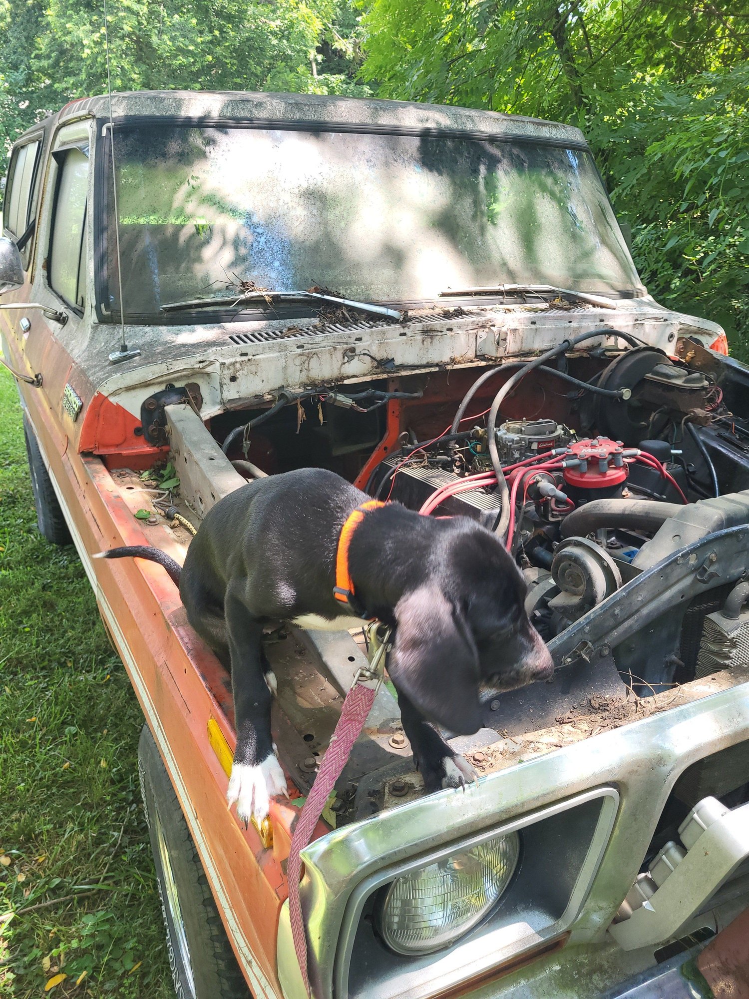

Helper dag! She's more like 100 pounds now.

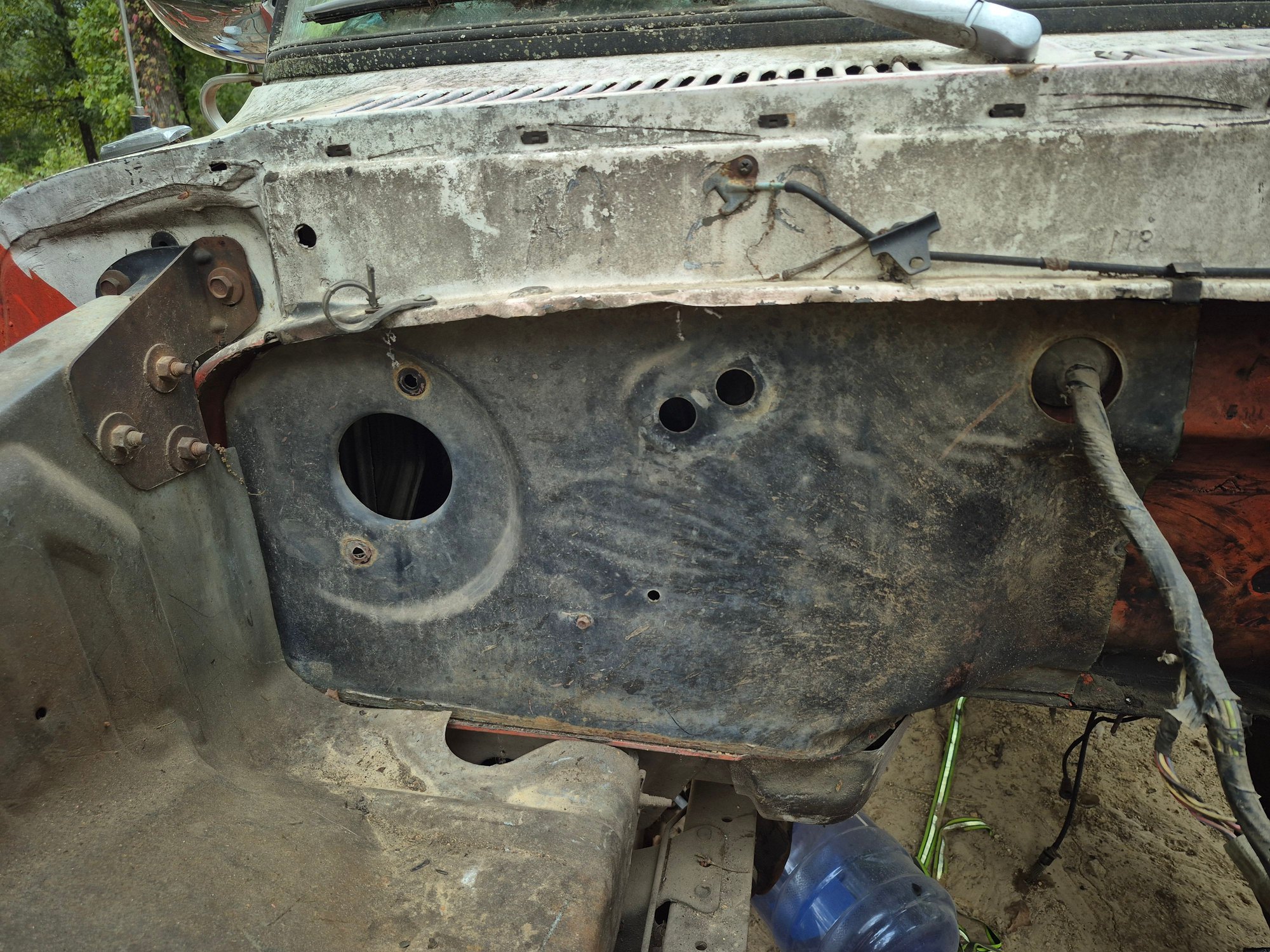

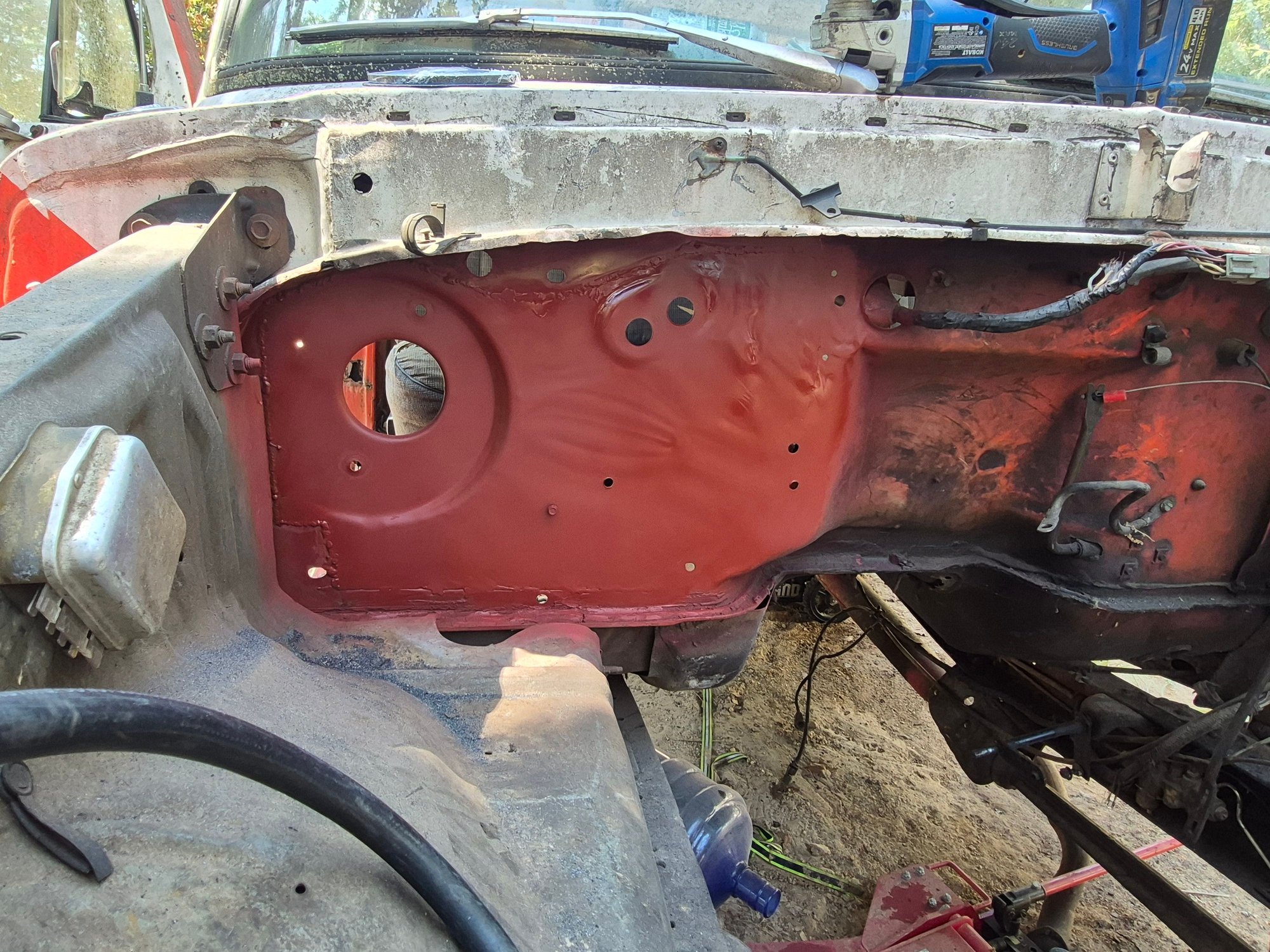

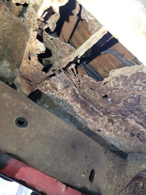

But the rust has to be fixed & there is crap load of rust.
But somehow ive got good rockers on both sides.

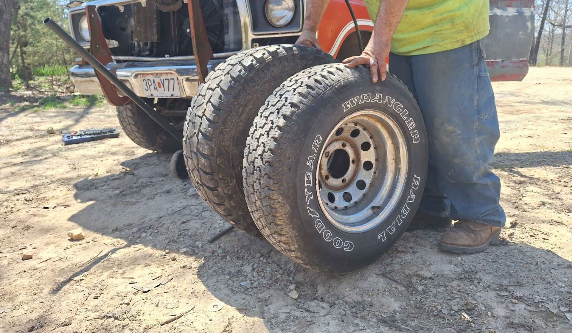

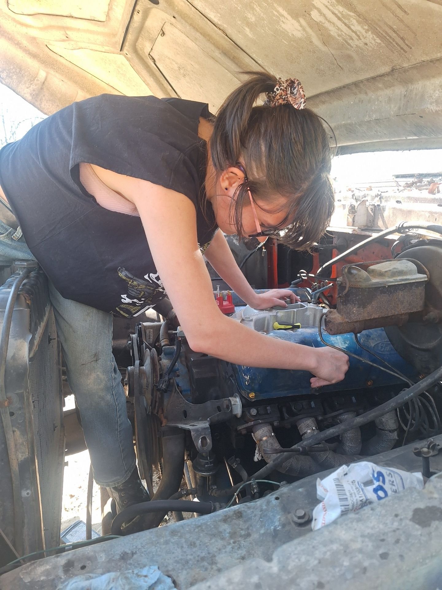

My almost 21 year old daughter did most of the work the last couple of days to get him running again, with me helping / supervising. It was a mixed bag, I stole the 4bbl intake last winter for another motor. I sat a factory 2bbl intake on there, but forgot to ever seal it & the #4 cylinder got some water. Just enough rust formed to keep it from turning over completely. We lubed it up & left it for a day while focusing on other endeavors, like getting all the water & sludge out of the pan. That was a real treat by the way. Had a new Edelbrock intake she learned to install, new valve cover gaskets, distributor (that's no where near in time yet). Put on some 33's because she couldnt get her ummmm...... chest between the radius arms and the ground. I didn't realize how much the stupid little 235's depressed me. I'd have probably started in on this a lot sooner if I'd have just changed the tires. We rocked the crank until the rust in #4 cleared (143 psi on the compression gauge) & it spin freely without plugs, that without plugs is important. The flex plate is hosed & I've known it for a while. Soon as there's compression, the starter findes the missing teeth on the ring gear.

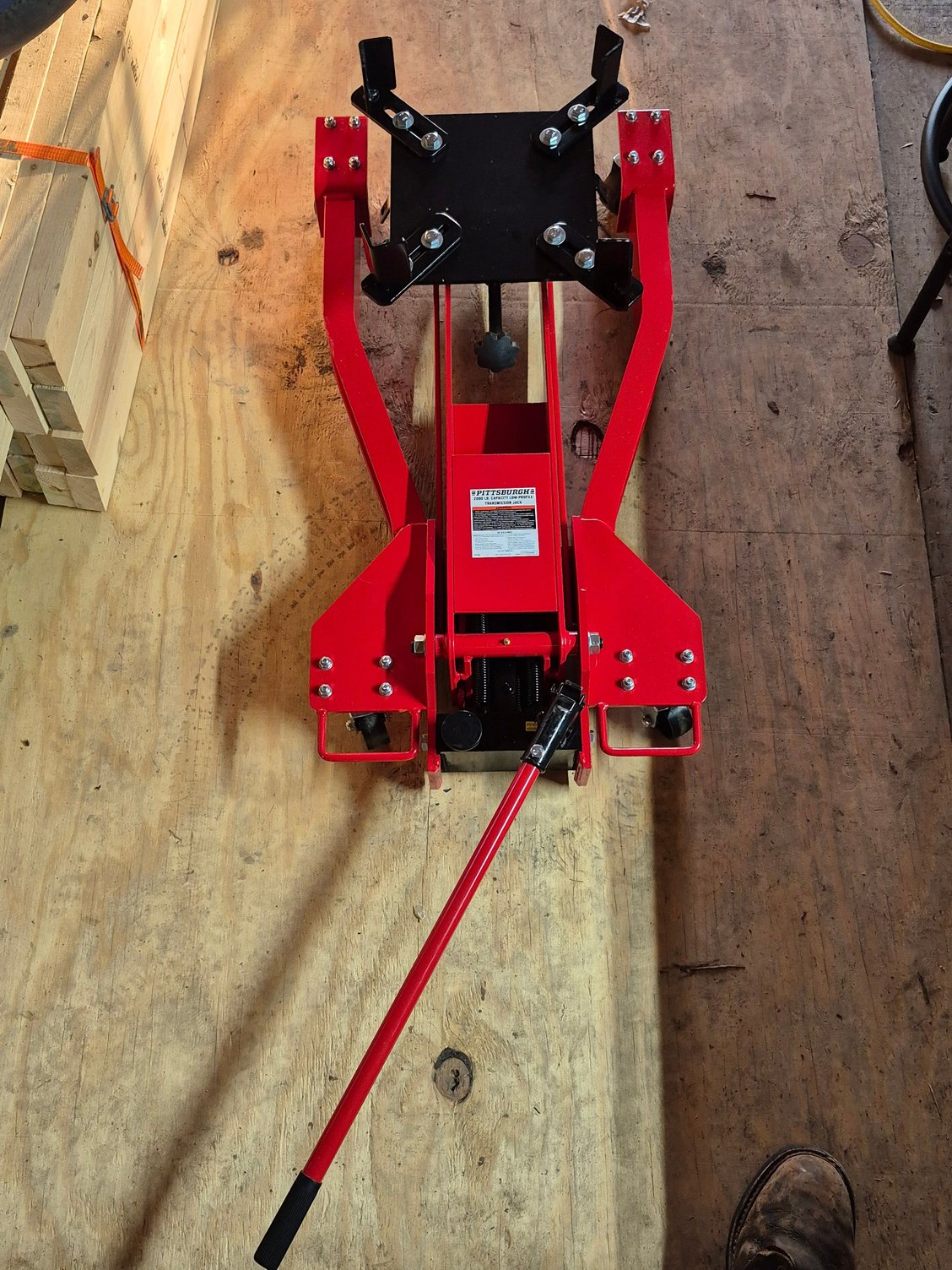

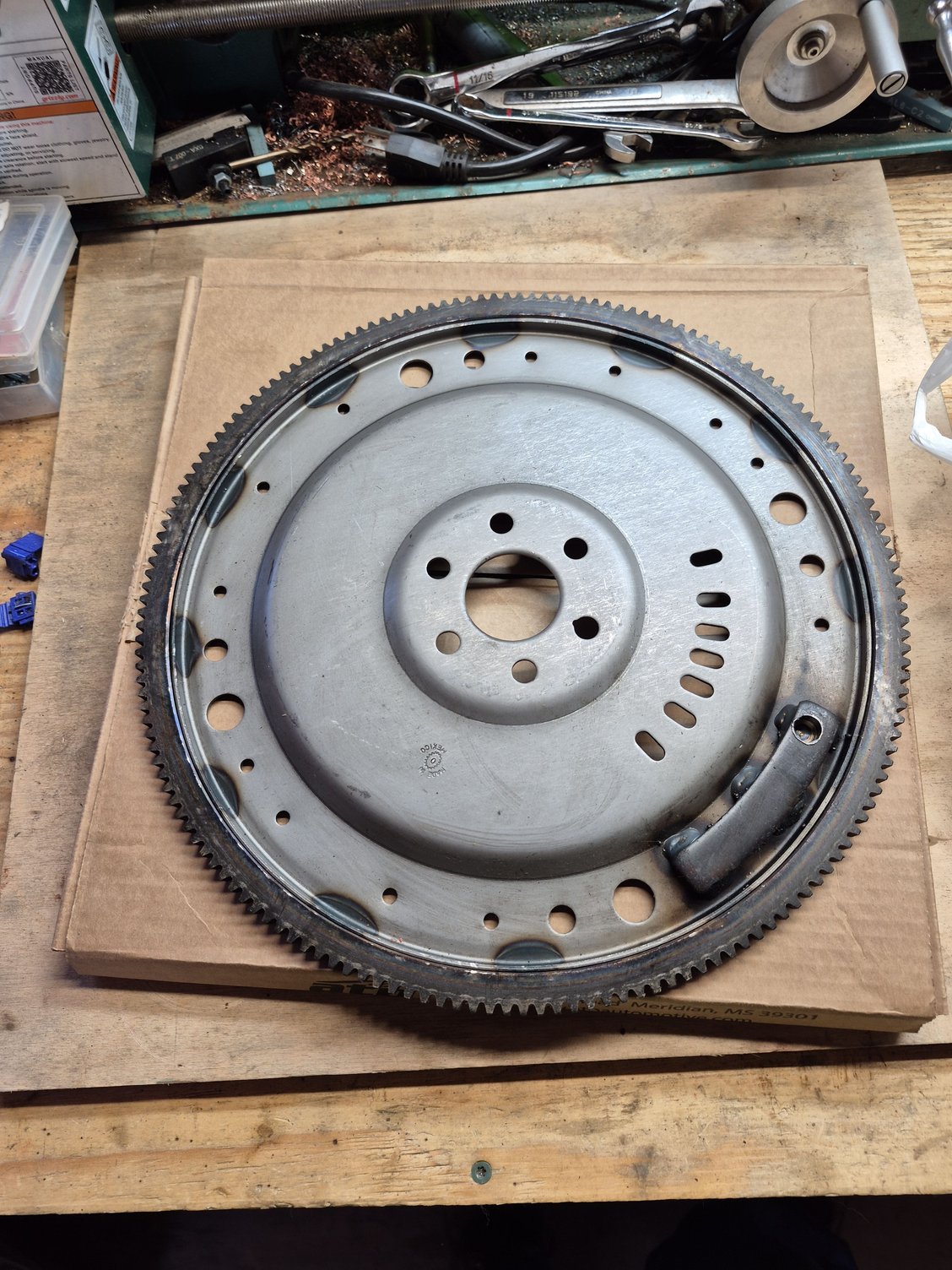

Since the flex plate is hosed & I'm lazier than I was at 22, at least when it comes to a C6 & a floor jack. I broke down and got a big boy transmission jack Saturday & a new flex plate.

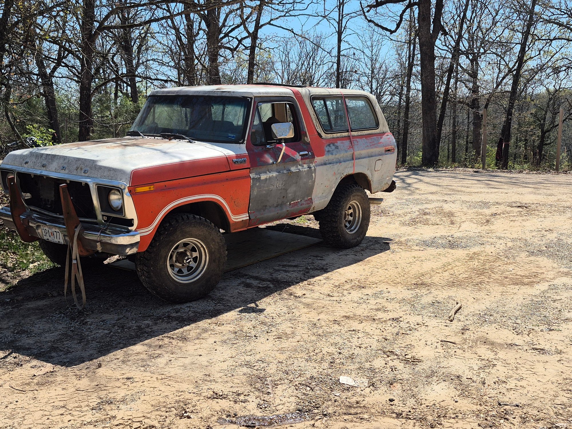

And that's where he stands at the moment. Right now it's more just getting running & road worthy, but in the not so distant future. How I said I've been collecting crap, well here's the over all plan. Gonna be built for towing.

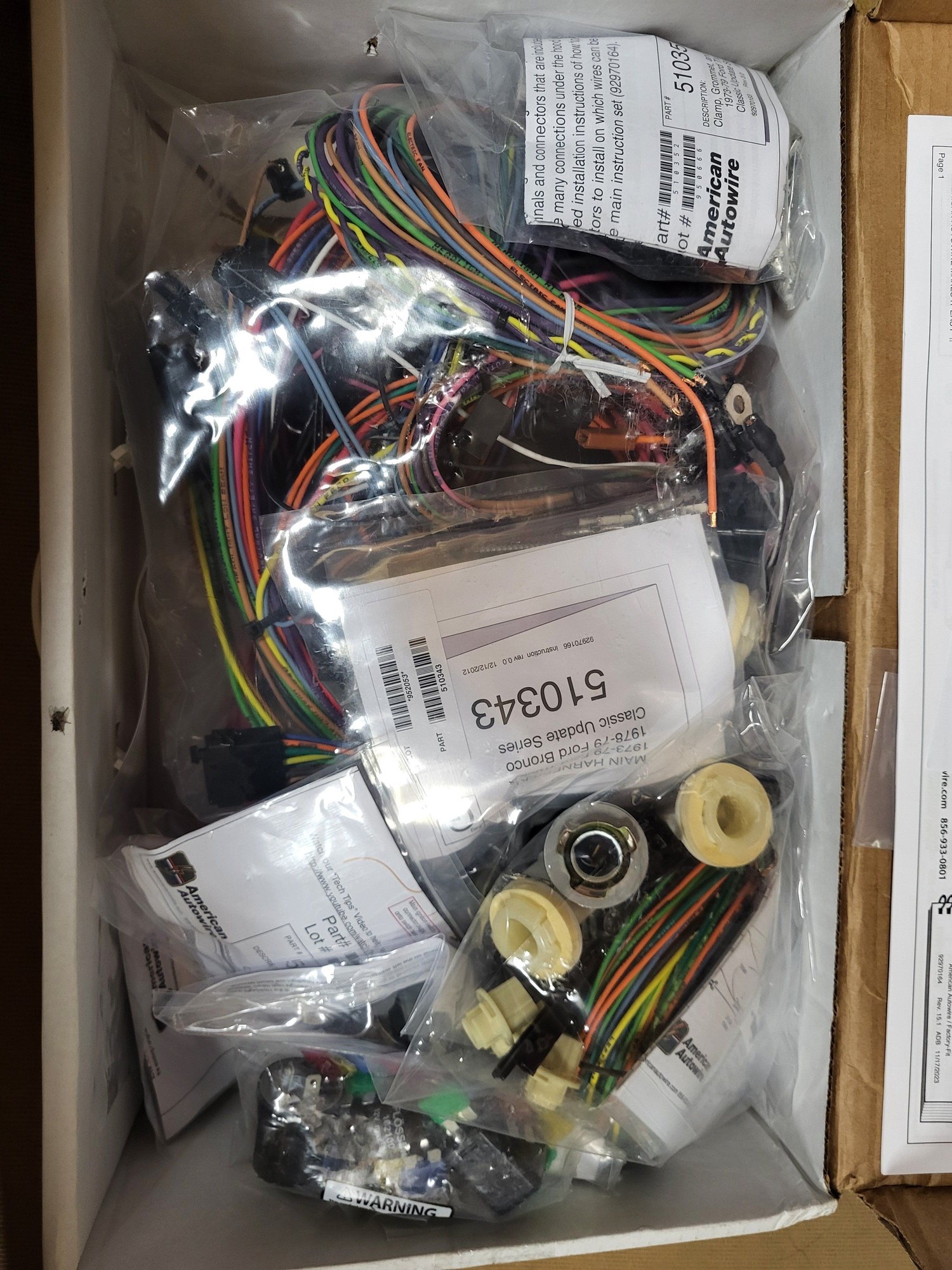

Complete rewire. I was an electrical hack at best in my 20's, so it's a mess in there. American autowire to the rescue.

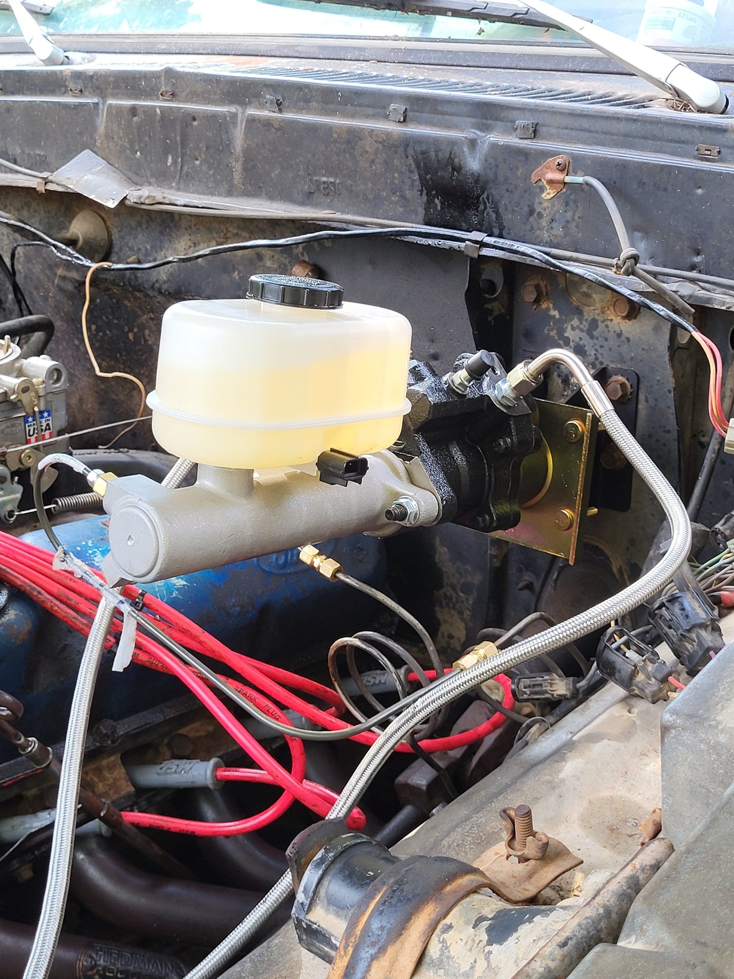

Hydro boost brakes & a Saginaw power steering pump. I put this on my 79 F350 with 37's & absolutely love it. And since my 460 has a Saginaw, I only got to do the hydro boost.

The big box of goodies has arrived.

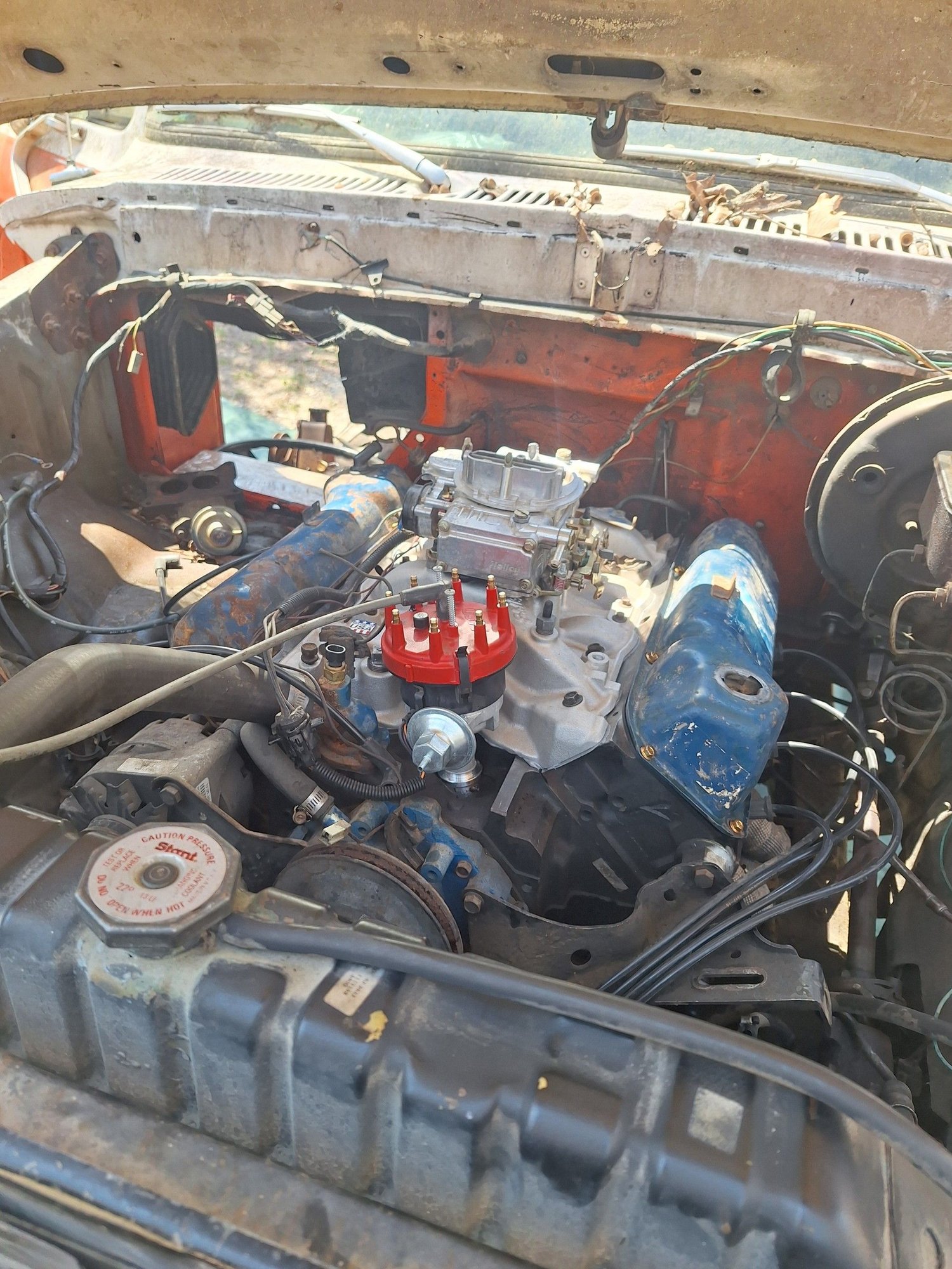

Bronco runs, sorta. On carb cleaner at least.
I feel kinda stupid. Spent a bunch of money on a transmission jack and a new flex plate & all I needed was a $40 dollar heli coil. Noticed the starter was jumping out of the trans & discovered that the bottom bolt hole was stripped out. Put in a heli coil & a different starter out of the stack & he fires off.
I'll drain the tank since that gas has been in there for a few years.

Not one, but two juck starters. I eventually gave up of the factory brick & went a different route. Starter for a 92 F250 with a 460 & automatic transmission.
Slight change in wiring. Snagged the wiring diagram from Full Size Bronco forum.
Starter works great, but my Chineseium distributor was junk. I found an old motorcraft in the parts box & it works. Then my beater 4160 finally gave up the ghost & started leaking out of everywhere, granted I did drive over it with a truck once. I've got a 670cfm Holley Offroad Avenger new in the box, but I don't want to use it. So I've got another 4160 on the way.

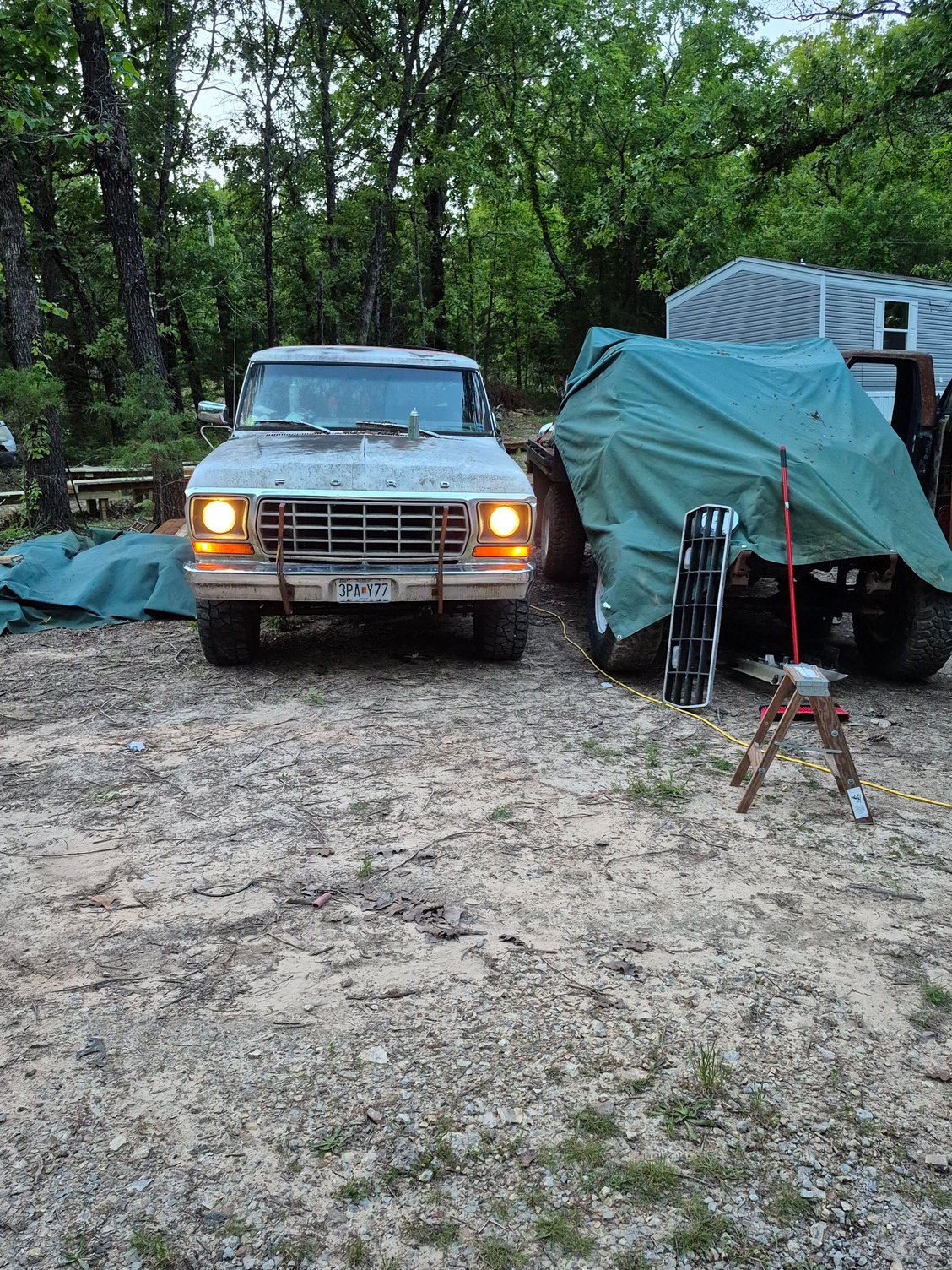

Got him going & running good enough to test drive down some of the roads around the house. Granted I can drive for a couple of hours without hitting pavement, but I didn't get that brave, for reasons.
This motor is a steaming pile of poop & i remember why I hated it before. Massive lack of power, falls on its face, hard to start & probably couldn't pull itself out of a wet paper bag. Timing issues most likely. But the bigger issue that really kills it right, the blue cloud of dooooooooooom. Rings or stems, I don't know & don't particularly care right now. Plus it won't start reliably either.

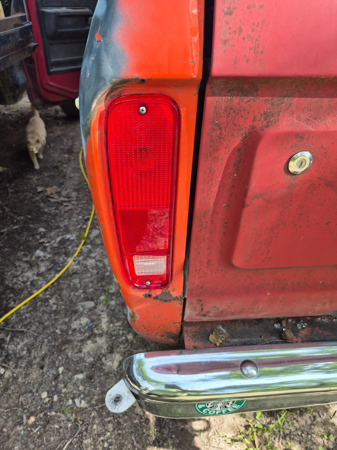

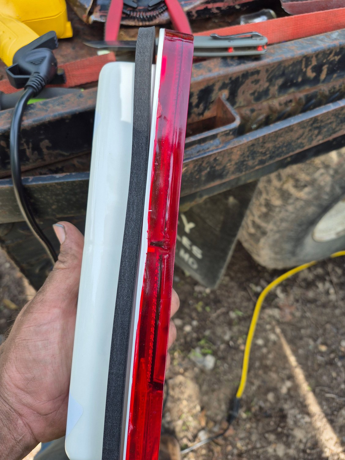

Here's something I've not seen in a very very long time. Every light working including the dash, excluding the dome.
Had to replace a couple of the light sockets & the taillight housings. The factory housings came out in a few pieces each. New ones came from Amazon and aren't that bad.
For whatever reason the engine has decided to start cooperating & is probably staying put for the time being. Not smoking out the exhaust like a son of a gun at least. Valve cover gaskets are leaking like crazy. Got some cork gaskets on the way. May try for an inspection and plates next week.
